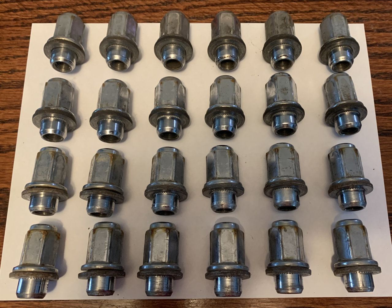

    Ordered and installed some newer lug nuts off of eBay. Before:

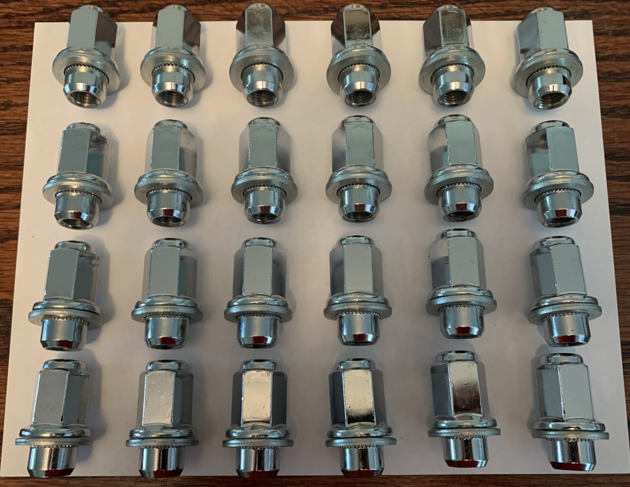

    After:
    SwampYota, ontarioyota and nagorb like this.
