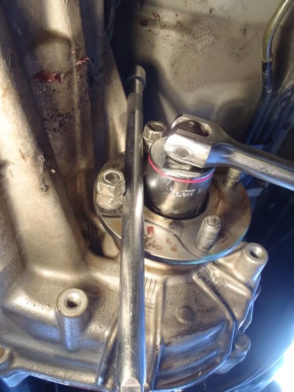

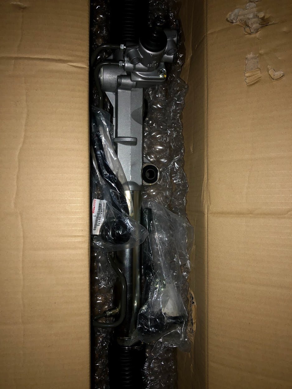

    I would. I put a brand new rack in before I drove out to Moab to wheel and I had worn bushings by the time I got home. Nothing like doing a job twice.
    I used this guide to do mine: And this method to break that nut loose. But I used an air impact instead of a breaker bar. I used a metal punch to unstake the nut as best as I could and let the impact eat the rest.

    This is the method I was trying las night but I just couldn’t get it to budge. I have an air impact, but no compressor anymore since my most recent move. :( I’ll keep trying though, sounds like they’re really on there good.

    Ah without an impact its hard because then you need to try to do the breaker bar and hold the shit still. Maybe an electric impact like @betterbuckleup has is in your future?

    I think it just might be! I thought about using the Jack under the breaker bar method too but I have a feeling it’d be hard to hold steady and would just end up slipping off the Jack or off the nut.

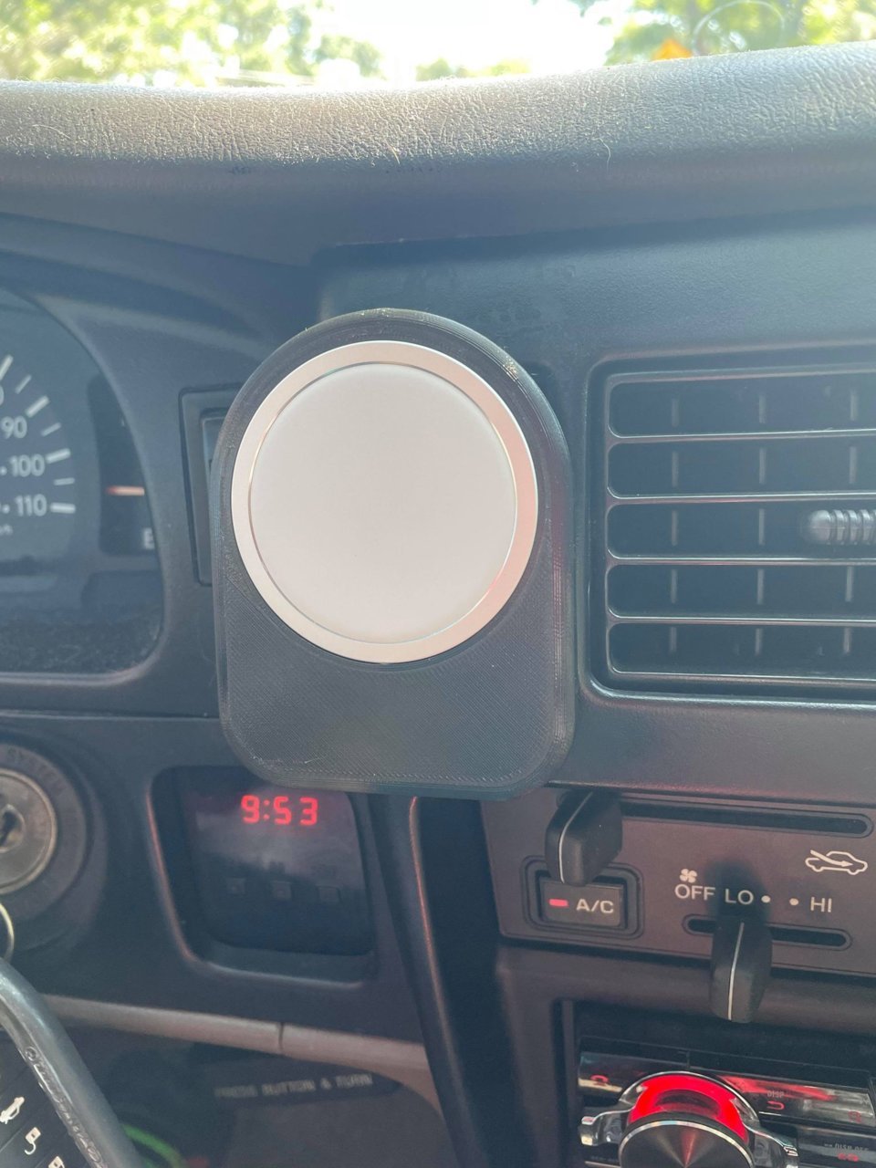

    Designed and 3D printed an iPhone magsafe mount that goes where the airbag switch goes.
    It's a 2 part design. One piece clips in to the airbag switch hole and has 2 hex nuts embedded in the back. The magsafe piece then gets screwed onto the clip. The actual magsafe is press fit in with a spot to route the cable to the back behind the dash. I wired in a 12v socket and used a PD3.0 capable (needed for magsafe fast charge) usb-c adapter.

    NEED! Well done, looks great in that spot.

    That's awesome. If I didn't need my airbag switch these days I'd be interesting in doing this. Can never find a good place or device to mount the phone.
