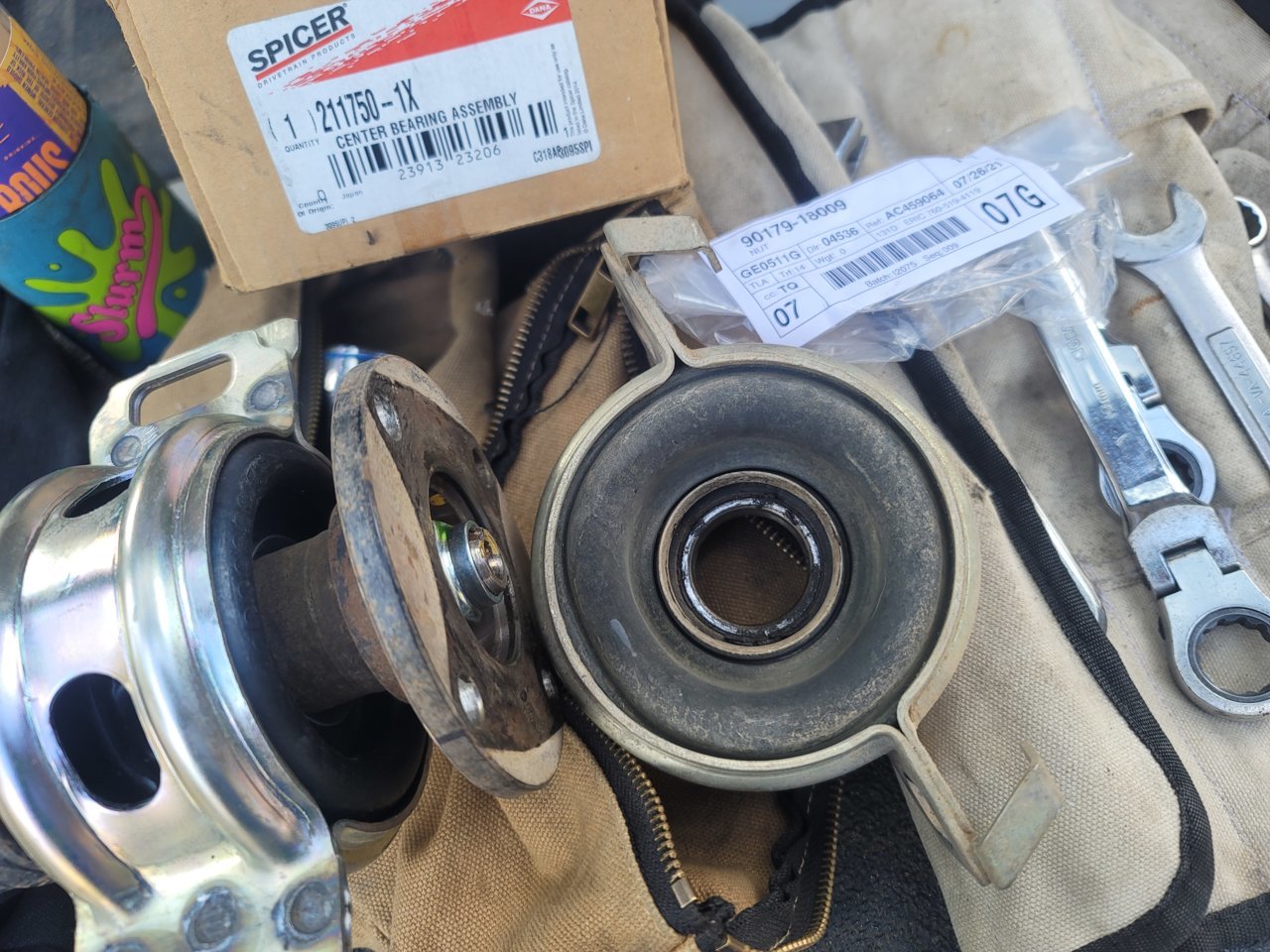

    Omg wtf. How did you guys torque this solo?!!
    I don't have a strong enough vice lol

    I left it on the truck all the times I’ve done it

    Left mine on the truck, too. Used an impact to tighten then backed off to *edit* 54 ft/lbs or whatever it is. Would have to double check.
    Never removed the driveshaft though

    ...lol ok. I'm putting it back to torque. Impact seated it pretty good I think. Gutentight

    54. But yeah. Guess I went a little too far haha.

    A lot of the writeups and videos show it by removing the driveshaft so I imagine it's pretty common

    Yeah. It was super easy till that step. I would have been cursing trying to get the rear separated from the front at the carrier under the truck. Well, not next time knowing it'll save me some time.
    Thanks for the advise everyone. Super easy torqing it on the truck. Just need to stake it and torque it all down
