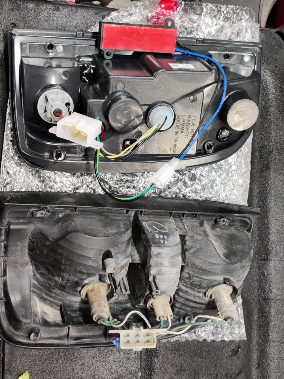

    A couple weeks back there were some folks talking about brake light wiring and I meant to ask a question but wanted to read ahead and make sure my questions weren't already answered.
    I'll go back and try to find it but in the meantime I'll throw out what I need.
    The older models have a 5 wire plug and the later years jump to a 6 wire configuration but it looks like the 6th pin is just a jumper wire. I have a some ANZO taillights that are wired for the older style 5pin plug and I was hoping I just need to add the jumper wire for the 6th pin to make it work but I'm doubting it's that easy (because it never is)

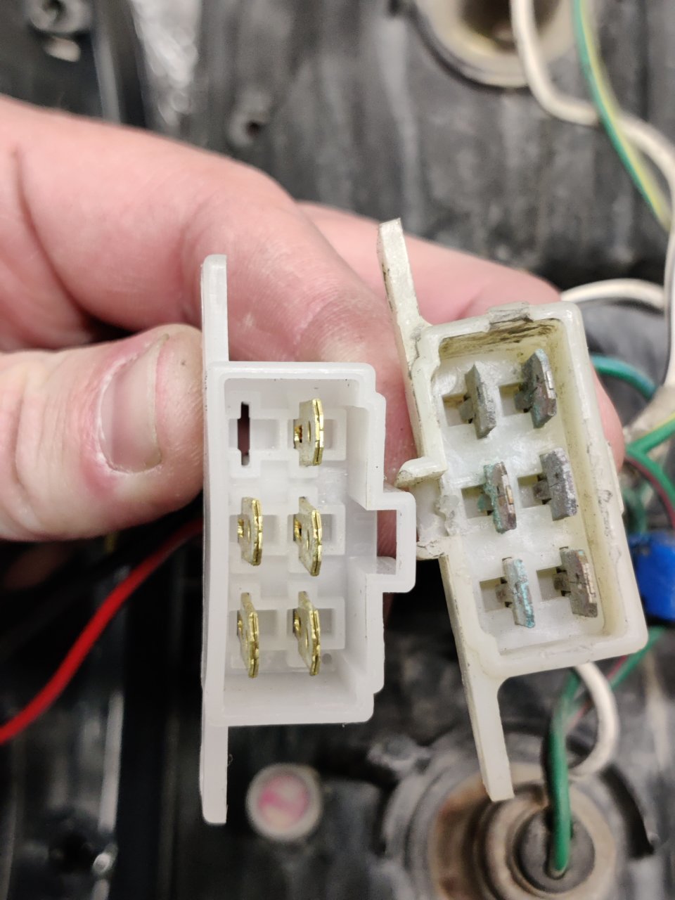

    Here are the connectors I'm referring to
    I also noticed that if I plug my driver's side taillights in snug the blinker shorts out and causes hyper flash like the bulb is burned out (I thought it was until I replaced it and the problem didn't go away, separated the plug just a hair and the blinker fixes itself)

    I have the ANZO lights on my ‘02. I snipped a wire on the OEM tail light, depinned it from the connector, and added the wire to the new tail light. After adding the 6th wire to the 5 wire tail light, I jumped it to an existing tail light wire.
    edit: pretty sure the missing pin is just a ground wire, so all you have to do is add the wire and jump it to a ground wire on the tail light.

    @BeLance89 sounds simple enough. Do you happen to have any pictures or remember what wire specifically you jumped to. Was it + / - any extra details would help.

    mom pretty sure it was a ground wire. I don’t think I have any pictures but I’ll pull a tail light for you and take a pic.
