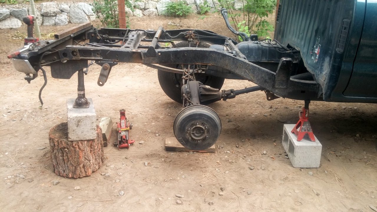

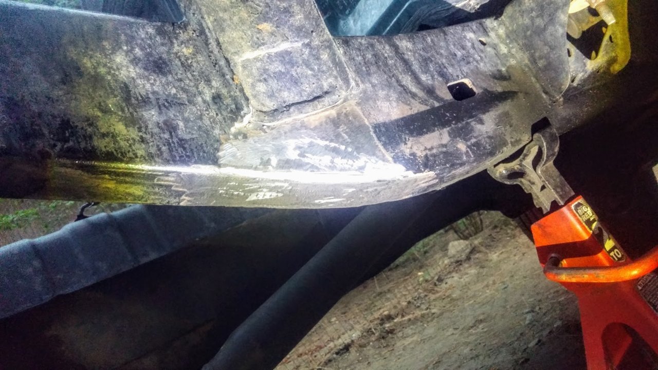

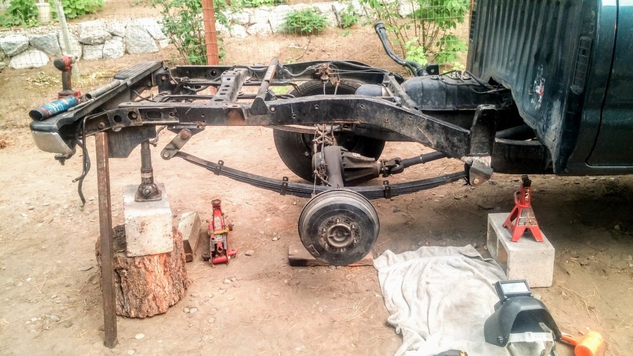

    Removed factory spring mounts on my 97 to fit a set of Deaver j59s

    Drop bracket lift and booger welds
    Aren't J59's stock length replacement compared to something like the F67's?
  7. Aug 13, 2021 at 10:29 AM
    Speedytech7
    Feb 20, 2014
    #123587
    58,100
    FCQM+VG Cheney, Washington
    It's less Tacoma and more mod
    He has a 95-97 frame, though I am confused, cause you have to move the rear mount too.

    I will if I must but I am going to try and use a longer shackle 1st.

    You can do that but your shackle angle will be pretty far off

    Shouldn't it be 45°?

    Ideally, with weight on it that should be the resting position yes. You moved your front mount how far forward of the old one?

    I was just about to post the same thing..
    I don't think that'll work out so great honestly.

    I went 2 inches forward, the front mounts are going to be in the factory position of the 98+ leafs.
