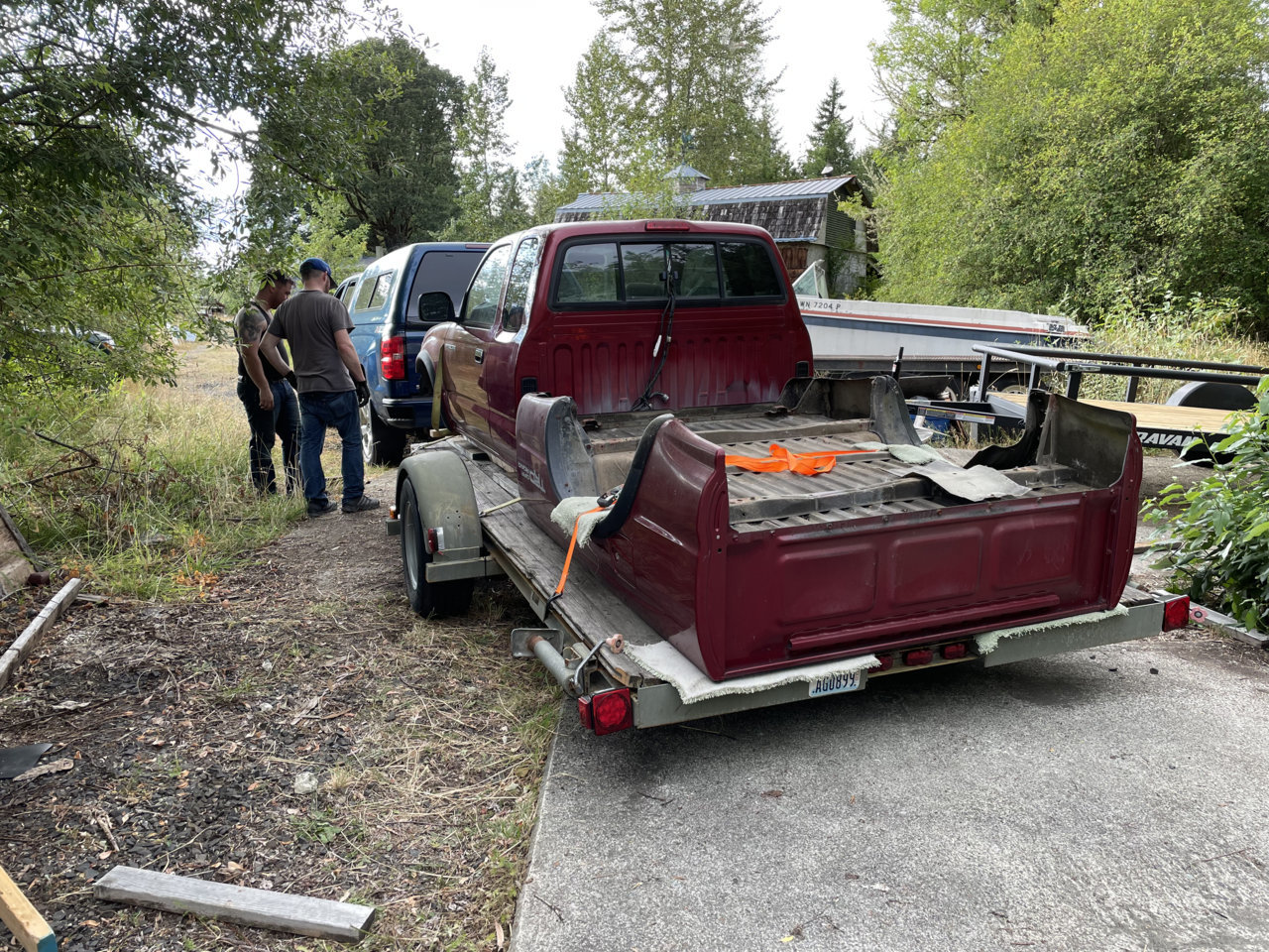

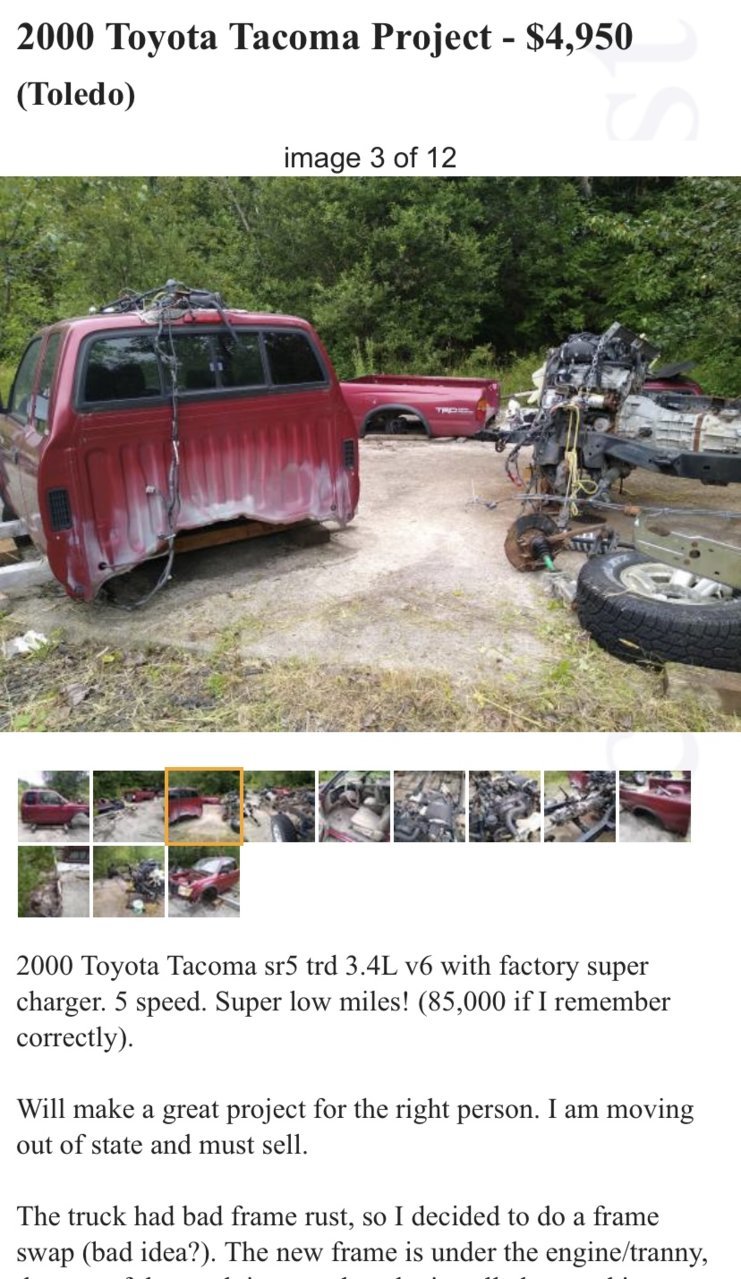

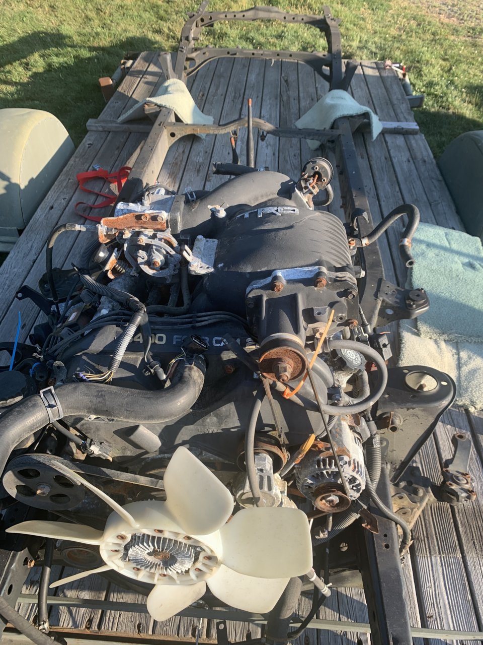

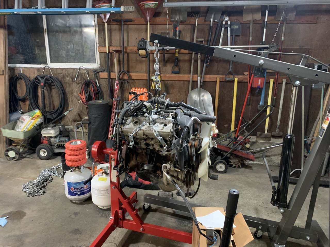

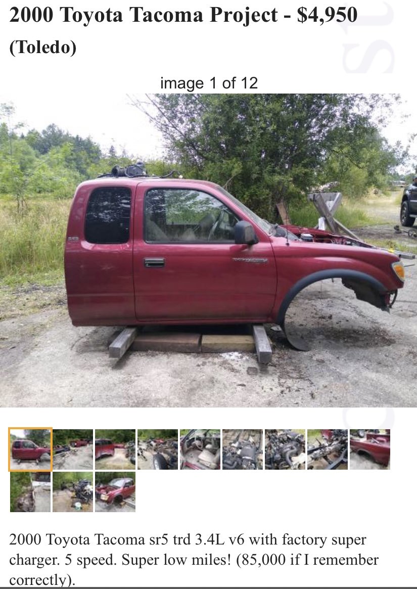

    Pulled the engine from the truck I purchased a month or so ago. DF98A4FE-1829-484C-9185-3F39E465437F.jpgI had the engine on a chain and engine balancer hanging from the bucket of my 76 Massey Ferguson and my tractor ends up dying, luckily over the asphalt in front of my garage so I got it on the stand and drug it into the garage.37D99296-3AED-4753-98D1-33AFF678D2FE.jpgI was looking for a donar truck with a decent body, a rebuildable 5vz would have been a plus- happen upon a guy on Craigslist moving to Alaska selling his 2000 with identical drivetrain but less than 90k miles and a supercharger. Only problem the things in pieces and has been sitting for three years.
    Gonna go through the whole thing and replace anything that’s got rust, then put the new body and drivetrain on my frame/axles/suspension 2FBD56CE-7823-450A-9DCE-25C5591F2E0A.jpg Took two 200 mile trips down and back, first one to get the frame w/ the engine, trans and case.7F82B08A-8727-4BB8-BEA5-33053507CE64.jpg
    Went down last weekend and got the rest, 4 of us with my Silverado and trailer and my Tacoma that I loaded the bed and put on the canopy.

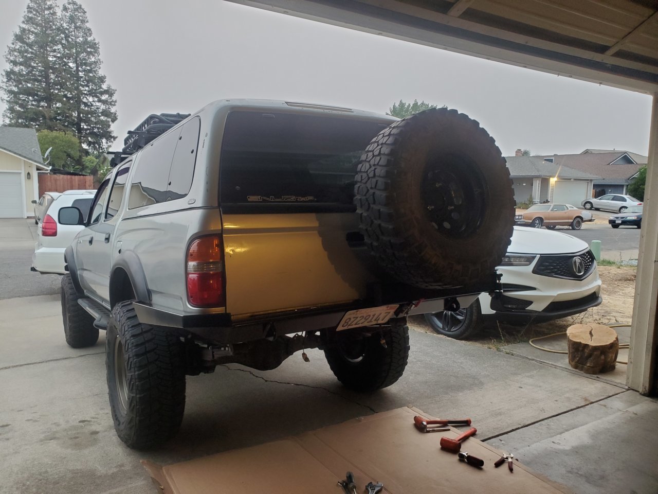

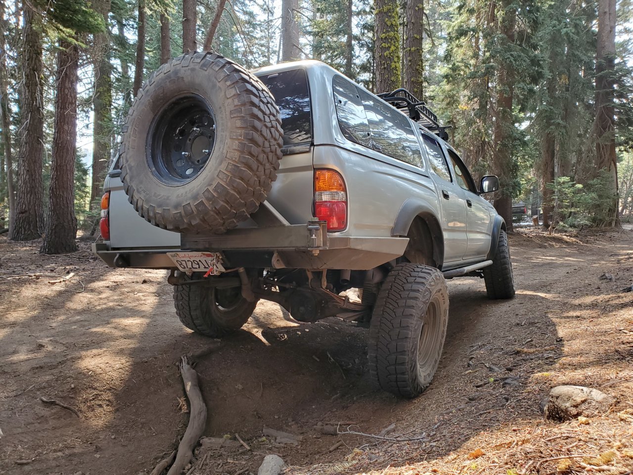

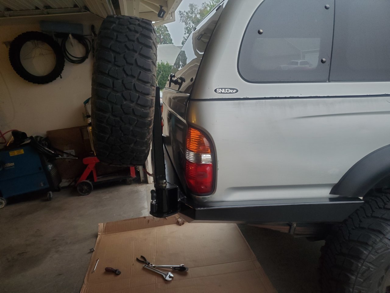

    Finally got he DIY coastal offroad high clearance rear bumper and my custom tire swing out done.20210806_200322.jpg 20210806_200344.jpg 20210814_100024.jpg

    That looks great, really like that design!

    That looks great!
    Looks like it's designed for a dual swingout with how long the arm is?
    Does it have a receiver hitch under the plate or anywhere else?
    edit: nevermind I looked at their website.

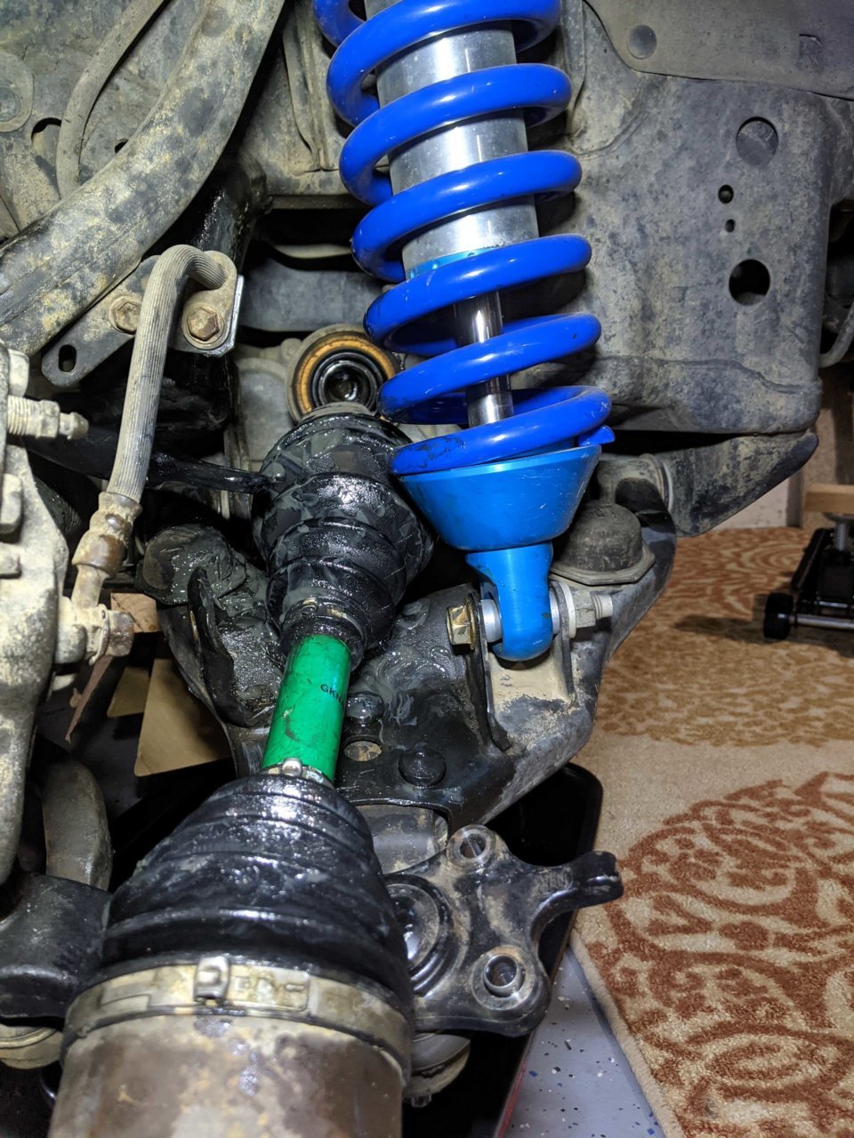

    I'm trying to replace my passenger CV following @turbodb 's guide and I have the CV fully disconnected but cannot figure out how to snake it out.
    I removed my sway bar end link but there still isn't enough space to get it out. Do I need to disconnect the coilover too or is there a trick I'm missing?

    I've always just pulled it pretty much straight out. Never removed anything that wasn't necessary to move the knuckle. Looks like your sway bar might be in the way, most remove theirs with coilovers.
    You can remove the lower bolt on the cover and pull it out a bit to get more room

    Removing the lower bolt on the coilover gave me the space I needed. And yeah, I think you're right; most write ups are either sans sway bar or w/OEM coils which are much smaller.

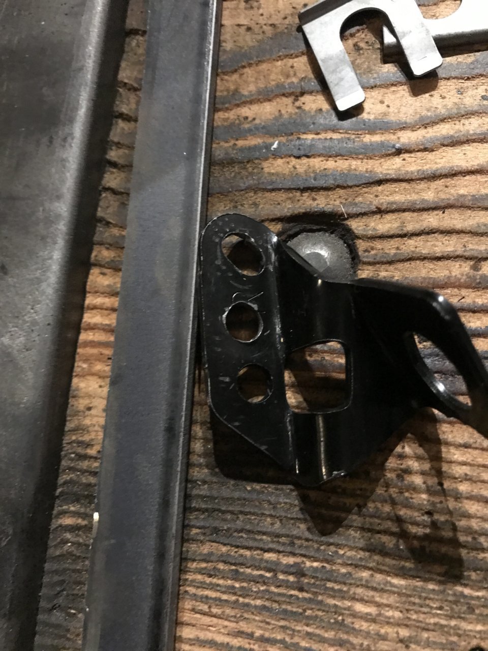

    I replaced my door checks. Used this video as a guide:
    It made a big difference. My doors will stay open now, even on a slope. I had forgotten there is a half way open spot it also will stay at. Hasn't done that for years.
    While I had the door panels off I also replaced the outside door handles with the all metal ones I bought a few months ago.
