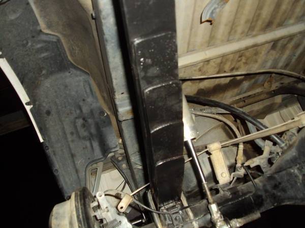

    Re configed my springs & built a progressive 6 pack...
    I gotta find something else to do.....:( :)
    Tomorrow might be the day to get the 3" Eibachs for the front.
