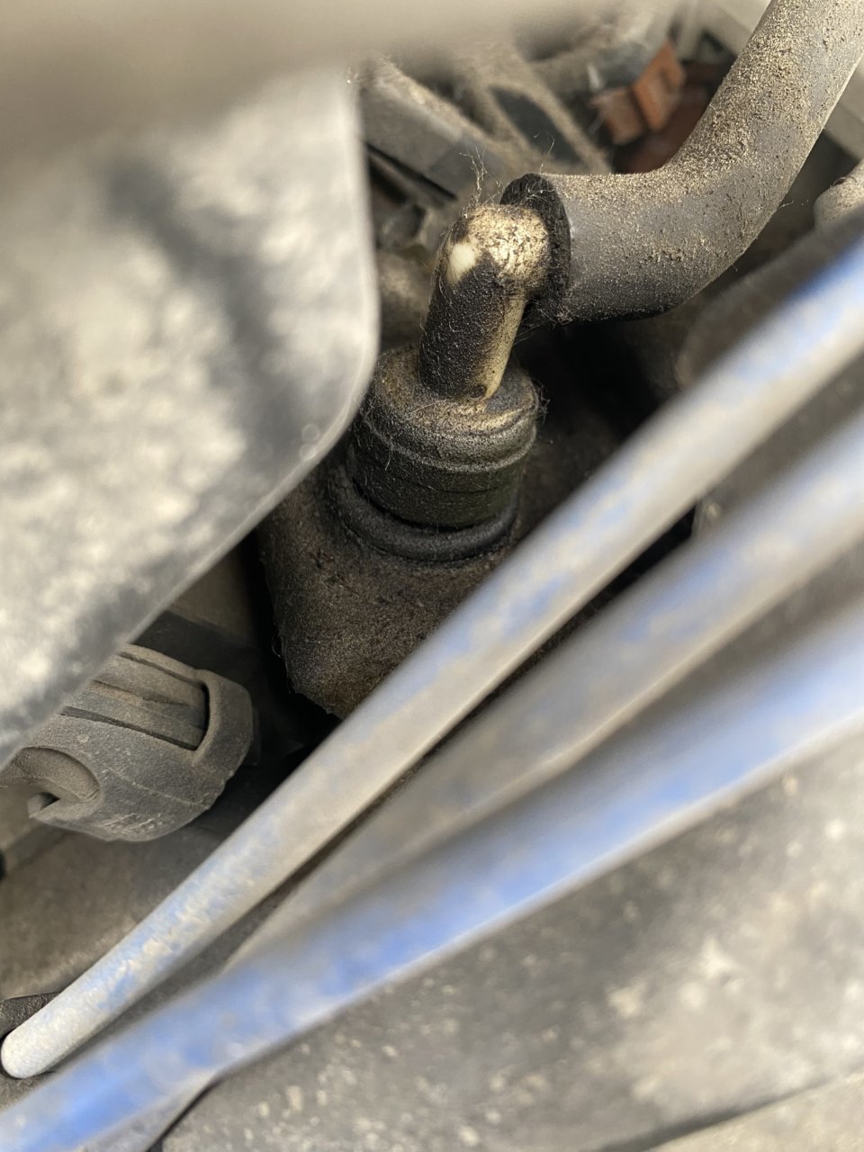

    Anyone know what this is? Below the air intake on the passenger side of engine. Noticed it’s leaking and collecting quite a bit of dust/dirt around the engine.

    PCV (positive crankcase valve). Easy to remove/replace.

    Sweet, thanks! I’m hoping that’s what is causing my high idle.

    5 minute job, only thing I’d advise is be careful removing it. That rubber grommet has a tendency to crumble and fall into the engine. Here’s the replacement part numbers if you need them:

    Yes, be careful removing the grommet that has turned into crumbly hard stone.
    Replace the tube while you are there as it tends to split and become brittle.

    Any tips on how to prevent it from falling in the engine? I imagine you could shove a rag inside so it doesn’t fall in and pick around the rag?

    I used what looks like a metal dental pick with a 90 degree angle.
