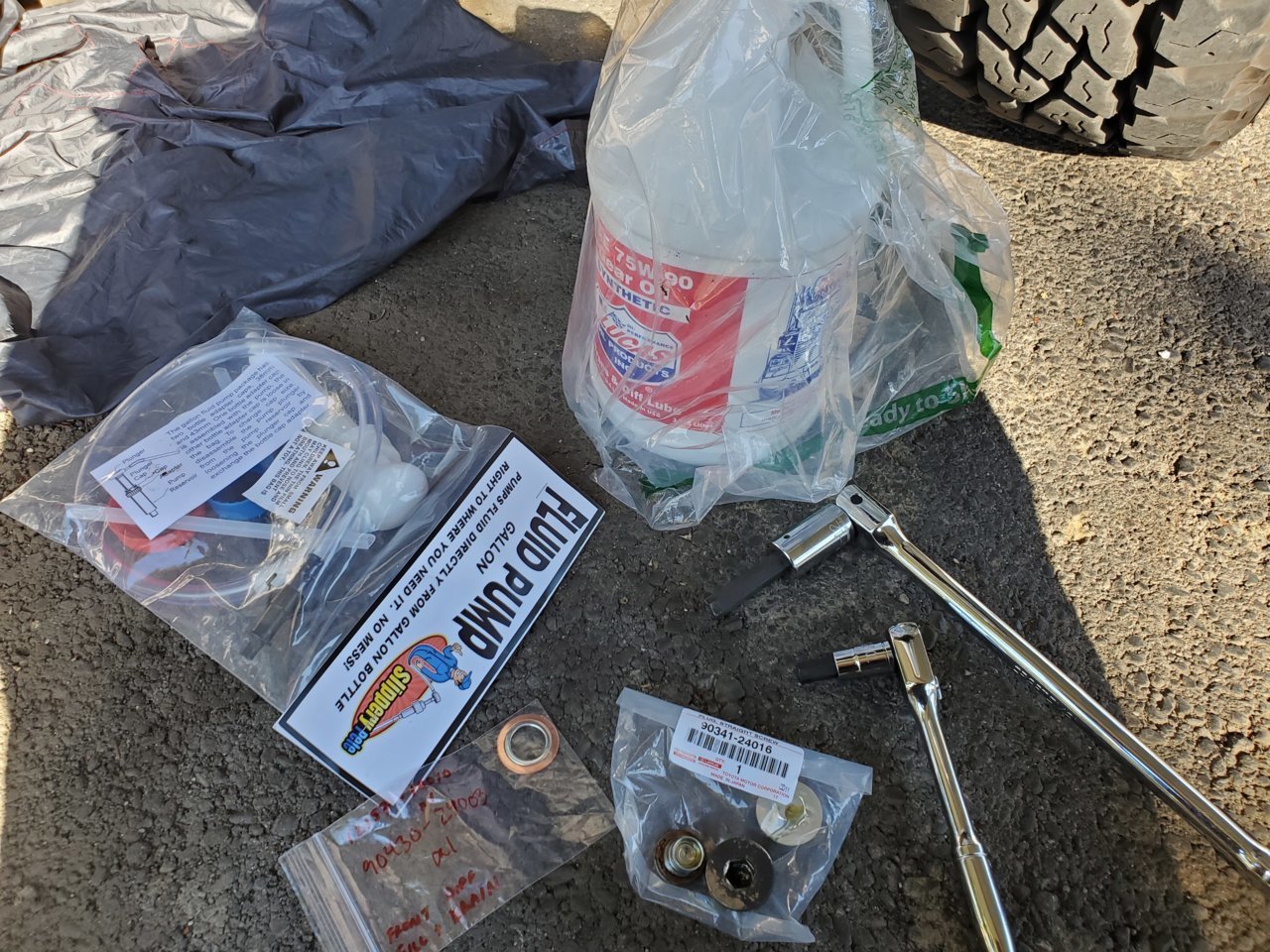

    It’s almost been a month and I still get nauseas when I think about the smell of that old oil. I imagine it’s the main ingredient in “Sex Panther” cologne from Anchorman.

    To each their own. I changed my front diff oil this weekend. Drain pan is still sitting and making the garage smell. It's the aroma of success...

    Diff oil doesn't smell that bad; changed mine a few months ago -
    For those watching, part numbers are -
    90341-18060 and 90341-24016 fill/drain plugs (Lexus variants)
    12157-10010 and 90430-24003 fill/drain crush washer/washer
    Torque specs being 20ft-lbs

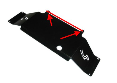

    I was figuring I’d have to bore either one out a bit to get them to line up perfectly. This helps confirm my initial thought about them lining up close enough as I believe the 4x mounts in the same spot as RCI

    Yes, I'm pretty sure all of the transmission skids that are for Tacoma (4runner is a bit different) have the holes in the same place as the SkidRow skids. They are all designed for the bolts to run up through the crossmember.

    @Captain Magma I just measured mine. The bolts are 17.5 inches center to center.
