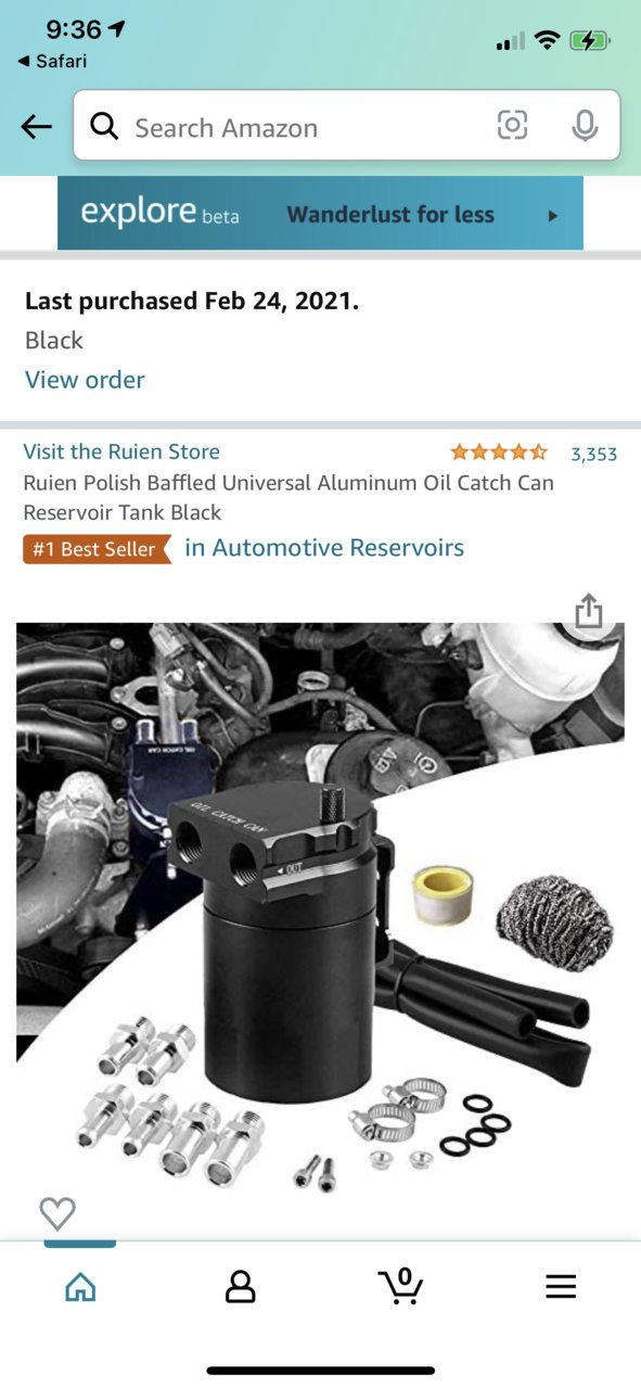

    I think that one is the same thing as the "ADD" branded one.
    I got the ADD when it was over $100 retail, found it for half that as a miss print. I would bet a box of doughnuts ADD had some exclusivity deal that may have lapsed and now the flood gates are open.
    Install and some testing along with a better 0-ring for the cup seal. The original would not reliably seal.
    https://www.tacomaworld.com/threads/3-4-oil-catch-can.351301/#post-9422255

    I have that same one off of Amazon on my 3rz. Not boosted, but helps to keep oil mist and whatnot out of the intake runners. I would think that it would help with carbon buildup as well.
    I made a custom bracket to mount mine on the firewall since my engine bay is also pretty packed.
    See below:
    :turtleride:

    Thanks. I like your mounting bracket. I have extra wiring running along that seam as well.
