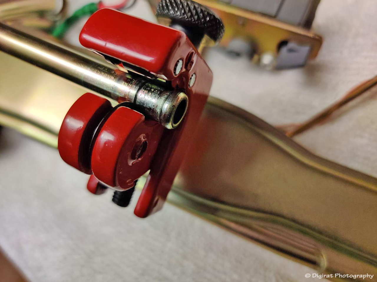

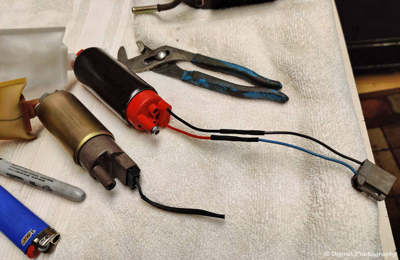

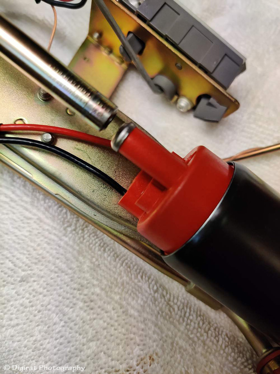

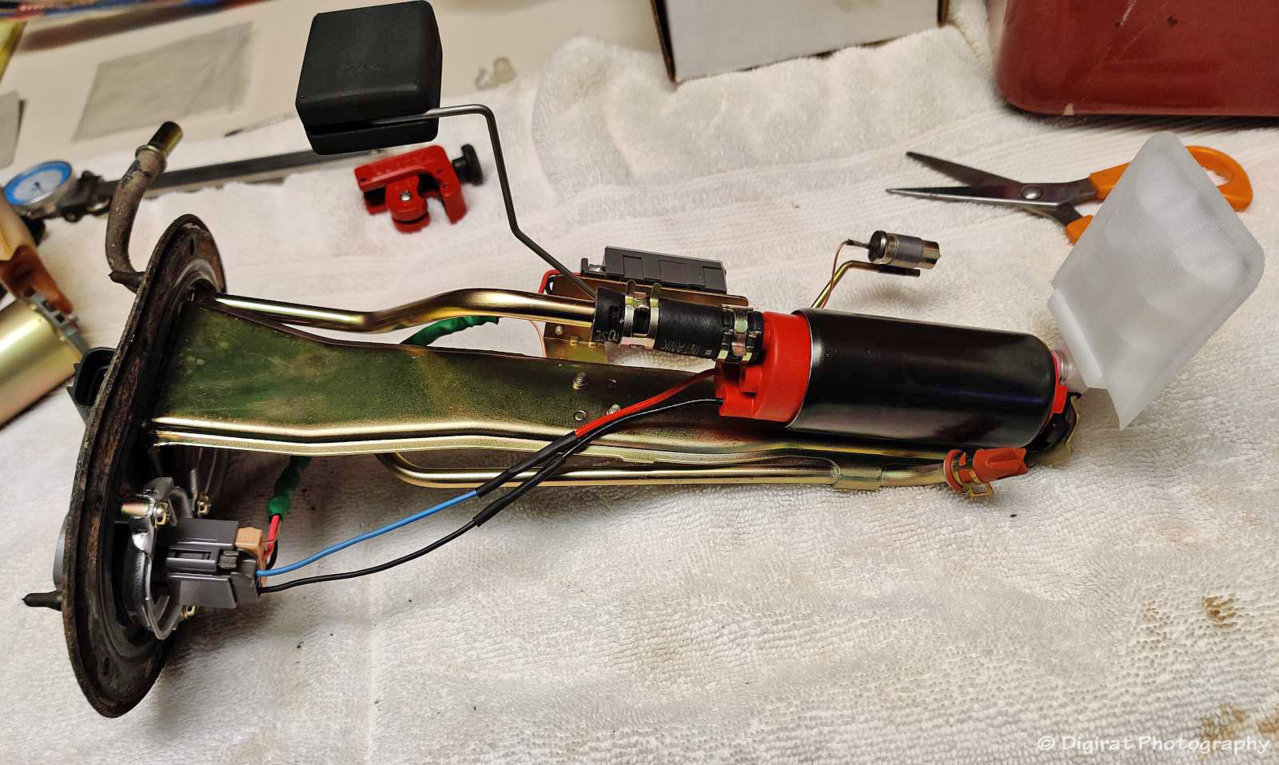

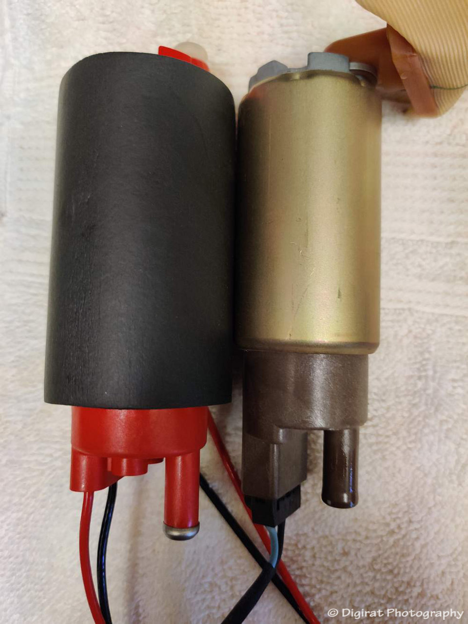

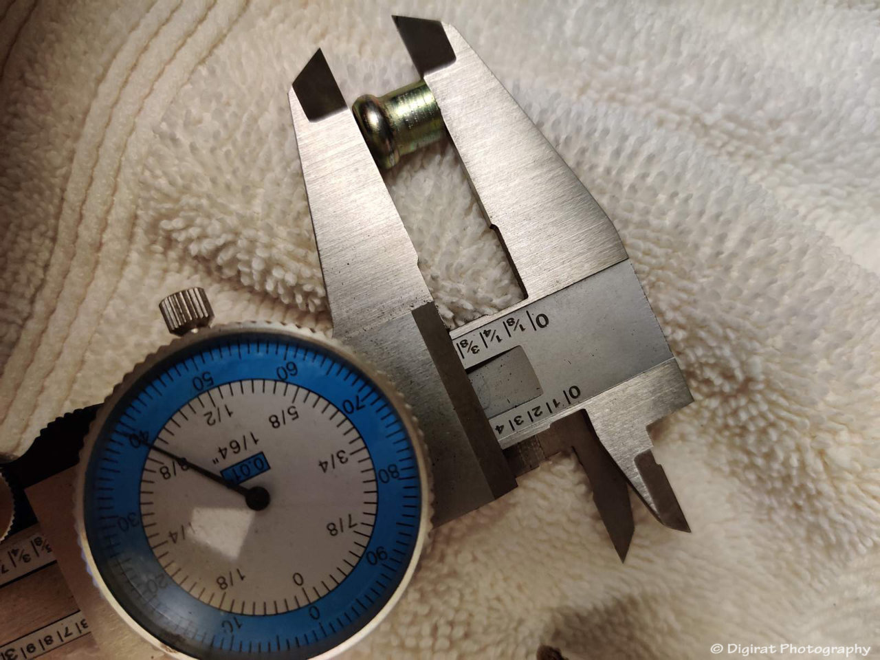

    I am not boosted, but I have considered it. So still an option for the future. Now that I've done it, the install wasn't too bad. You will have to splice in the OE connector, I soldered mine. And you'll have to shorten the OE bracket's pickup tube a little bit because the Aeromotive pump is a little longer than the OE pump. Everything else is a straight swap. Here a a couple of pics to better describe it.

    Awesome. Thanks for the pics!
    I can't imagine the 3rz fuel pickup being any different from the 5vz one.
    I believe the bracket gasket on the top are the same between the two motors.

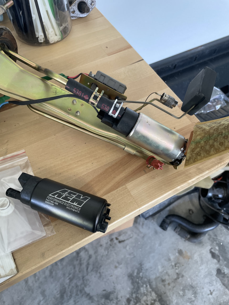

    I did the same thing with the AEM 50-1000 pump. Pump is quiet and I also agree that the install isn’t too bad.
    just try to do it when you’re low on gas if you have to drop the tank.
