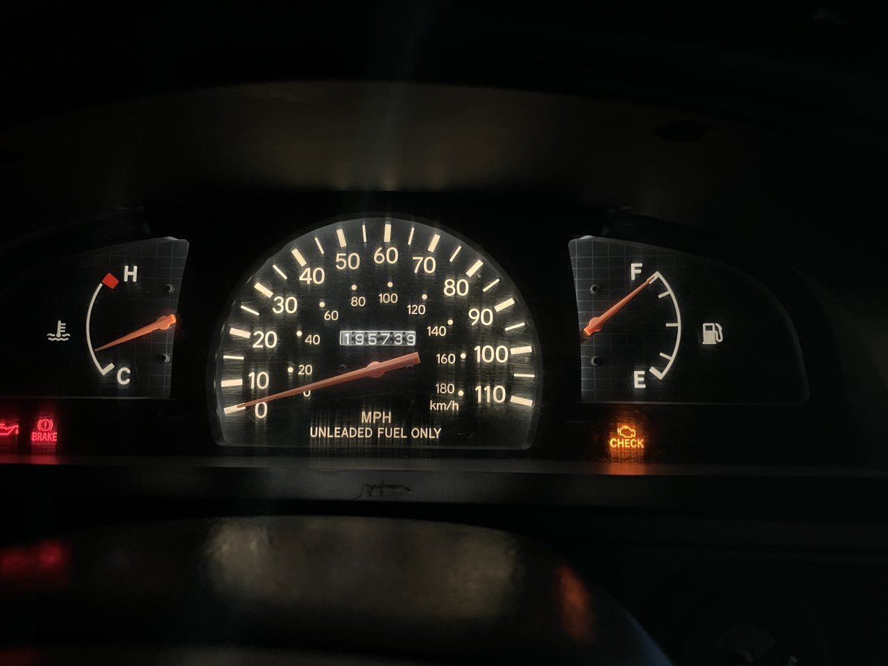

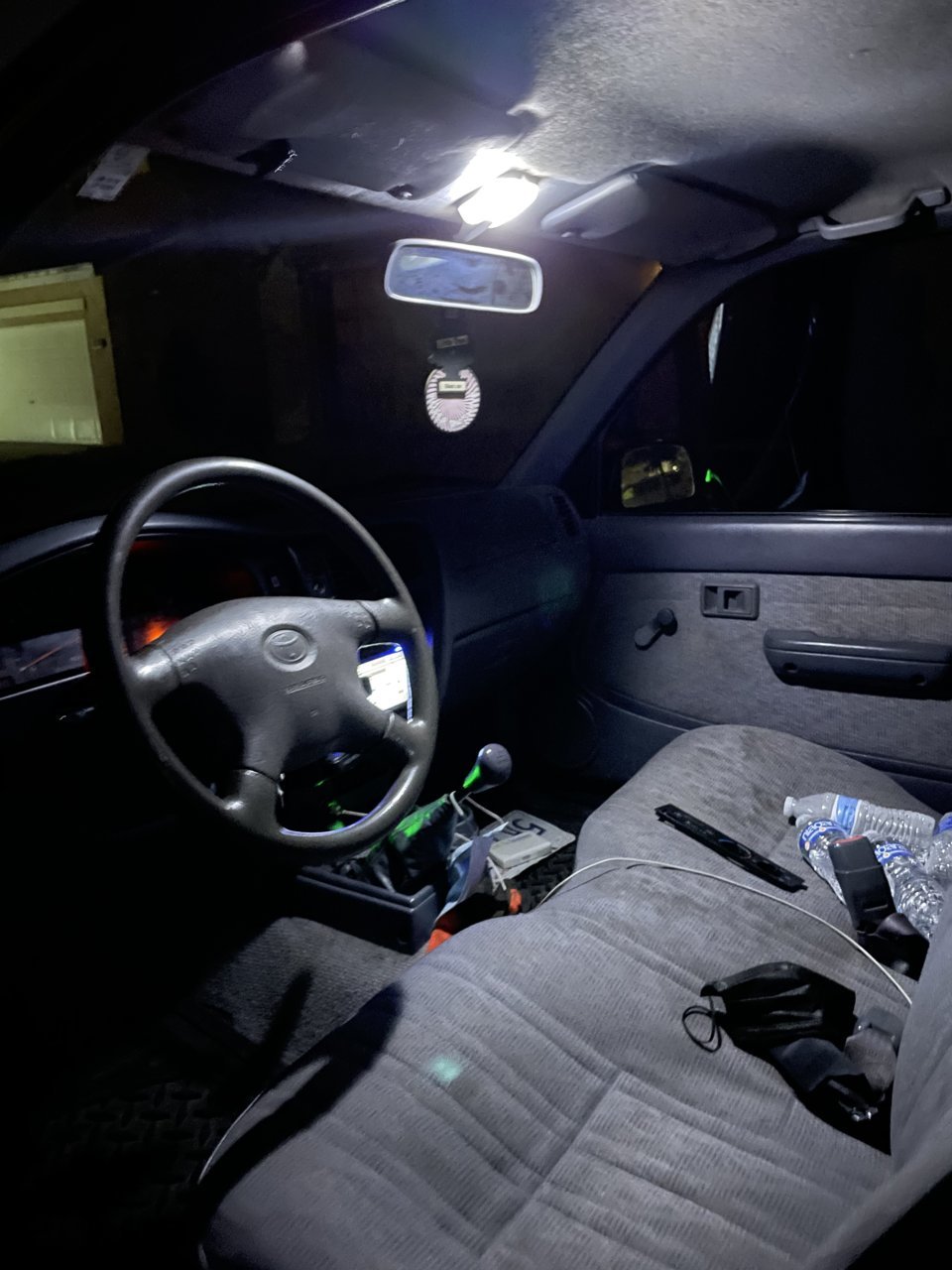

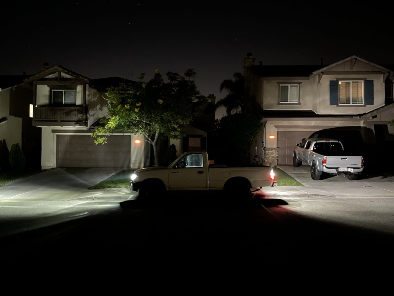

    Threw some leds in

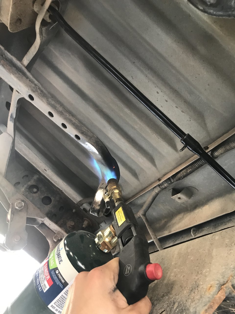

    y’all work too hard, I just unbolted those things and left them off. Cinched up the tire hoist nice and tight and it hasn’t moved since I put the 33 under there.

    Gettin those bolts from underneath seemed like a lot more work than I wanted to deal with without a ratcheting wrench

    That’s a very valid point. I did use ratcheting wrenches on those. Sometimes I feel like those things are a cheat code. Lol

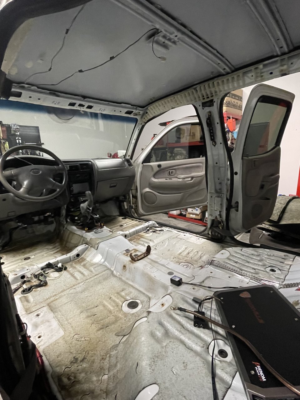

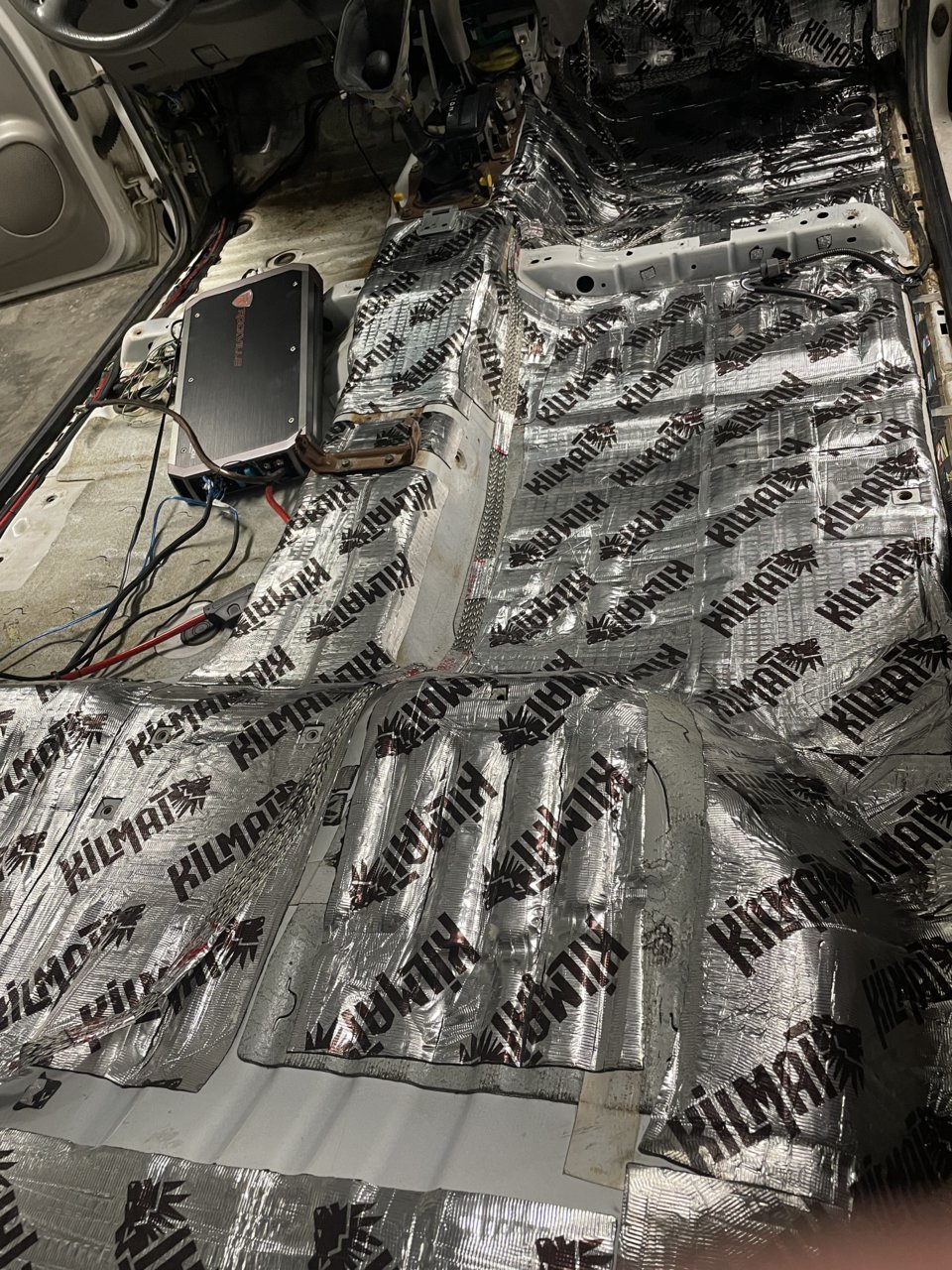

    I started the sound deadening project last night and made good progress. I’ll be installing some mass loaded vinyl on the floor in addition to the Killmat and closed cell foam. Hoping it makes the tuck a lot quieter. Also doubling up the killmat on the back of the cab.
