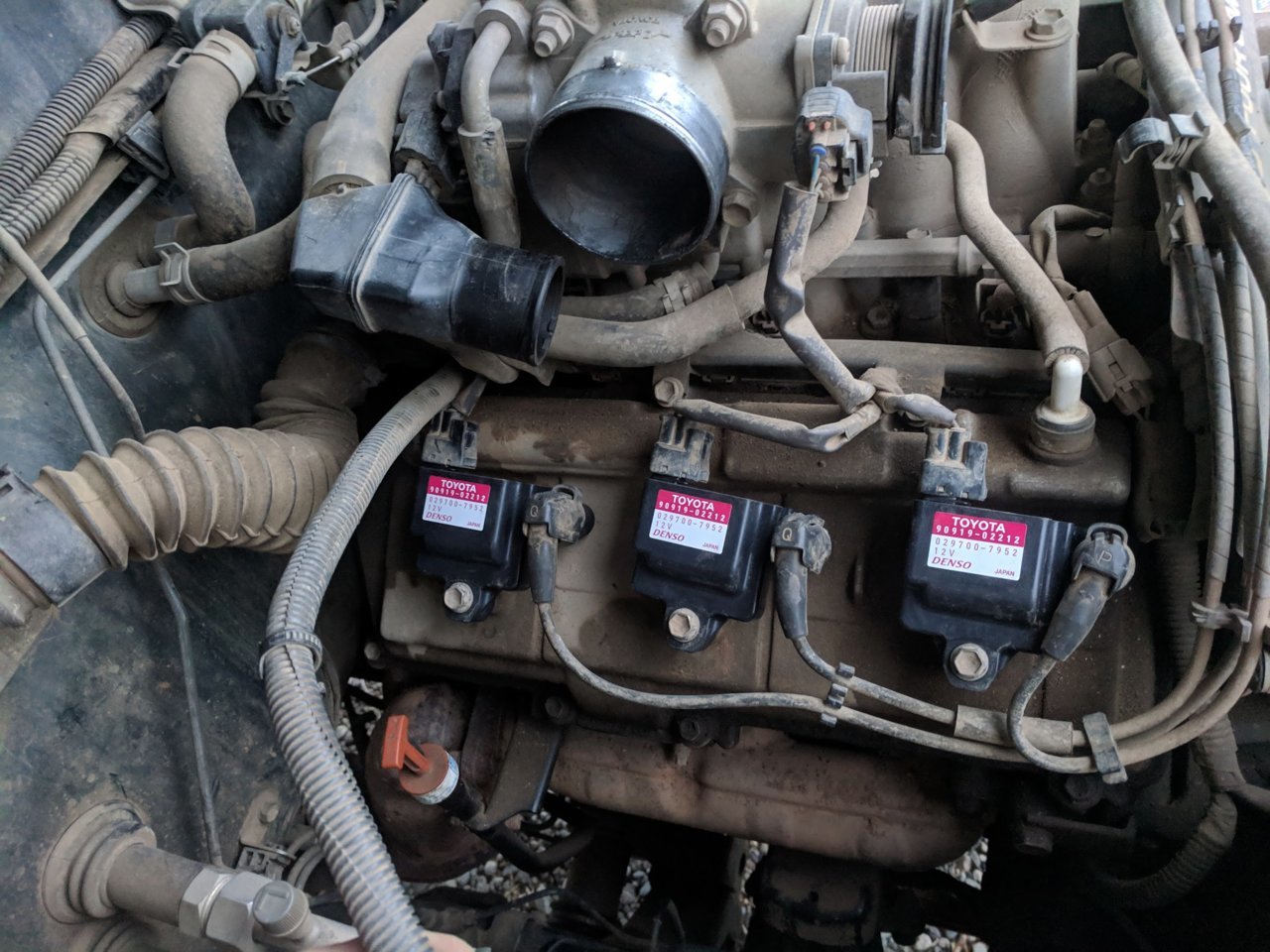

    Sounds like it's not the coil packs. Wires would be first thing, they go bad much more often.
    But here's the coil packs if you need them later:
    oVP1qV4dXed41o-W8Tr7L6UqEhRgWwH7-Ytz8pDI_3a49284905303bbb5476c59462999549f03f7371.jpg
    Hopefully that posted.
    Fernando[QUOTED] likes this.
