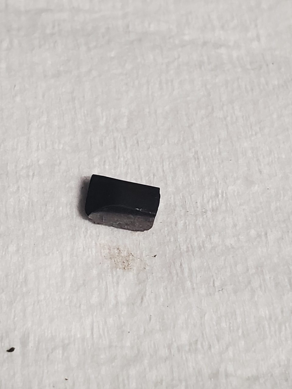

    I found this stuck to the plug in my rear diff when I went to change the oil. What do y'all think? Time for a rebuild? Maybe a locker as well?

    I would say that it’s time to pull that thing and See what the hell that’s from

    More pics? I've been all through the rear diff, but that's not sparking any memories.
    But we the last two said, time to pull the diff and find out what havoc that's bestowed.

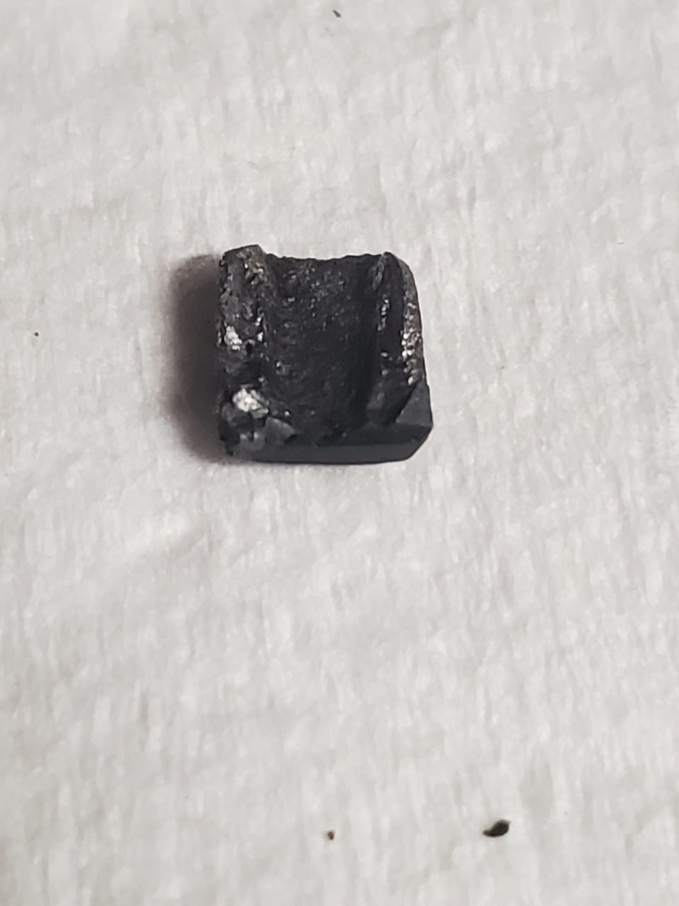

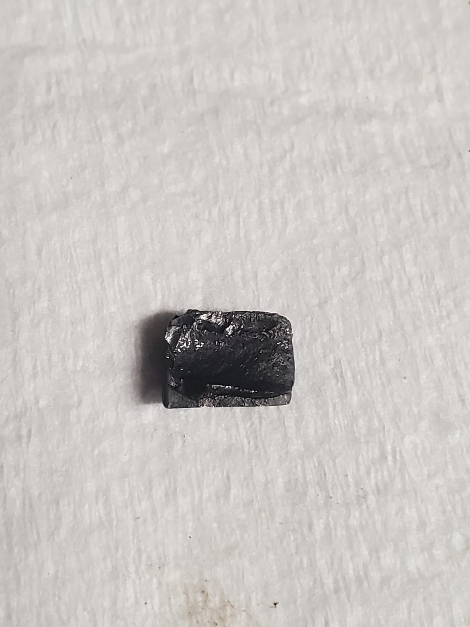

    This is the only other one I took. I am thinking it is just the tip of one of the ring or pinion gear splines. I got the oil done this evening so I will take it out in the morning before I change the oil in the front diff and see if I notice anything. And I'll see how much anxiety it gives me here in the next 4 weeks before deer season. It might get 50 miles on it before then anyway and it has been going for God knows how long before that. I have had it for 2 years and only put maybe 4000 miles on it.

    It doesn't look like a broken gear, looks like a cast part. If it was a gear or should have cleaner breaks, but it could've been chewed up in there. But the second pic does look like it could be a gear.
    My suggestion with anything that size in the diff, is pull it and inspect. Whatever it is should be noticable.

    Amy chance you've got a scale to reference the size?

    Looks like a tip off the ring gear. Definitely pull it

    It is 1/4" in length by 3/16" wide.

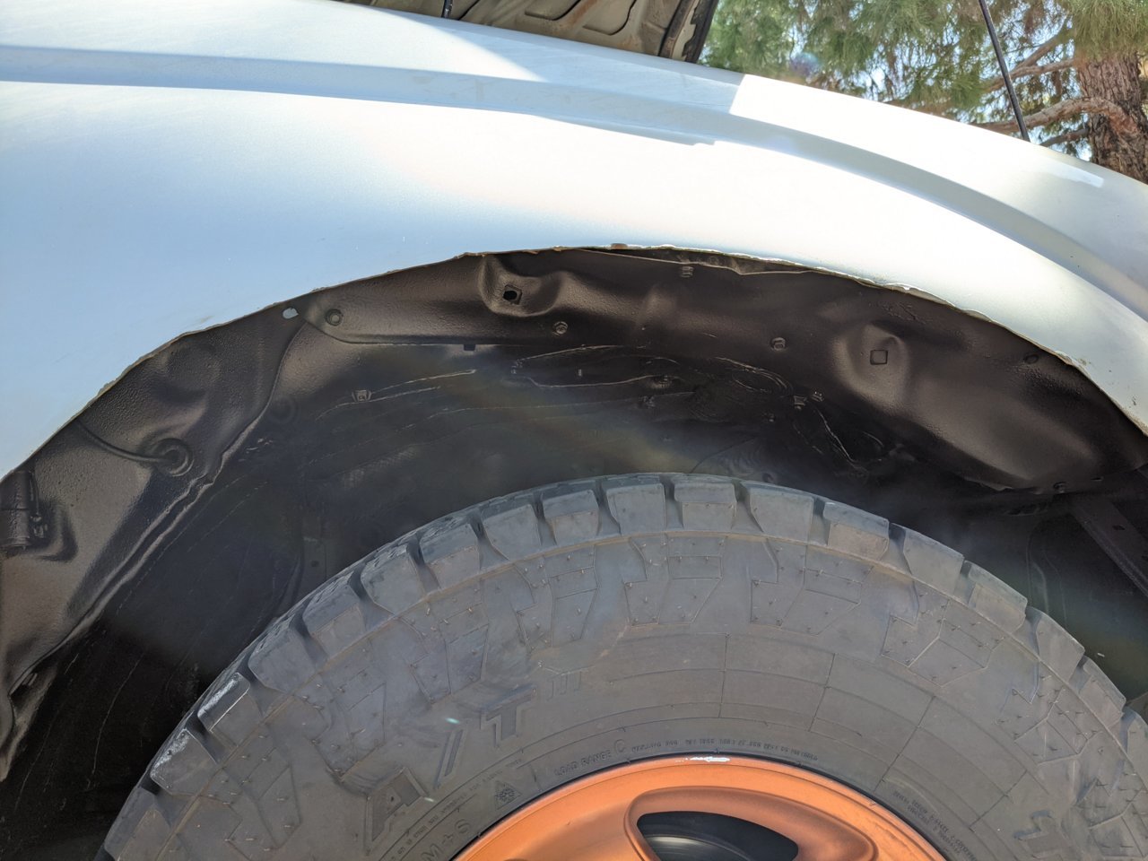

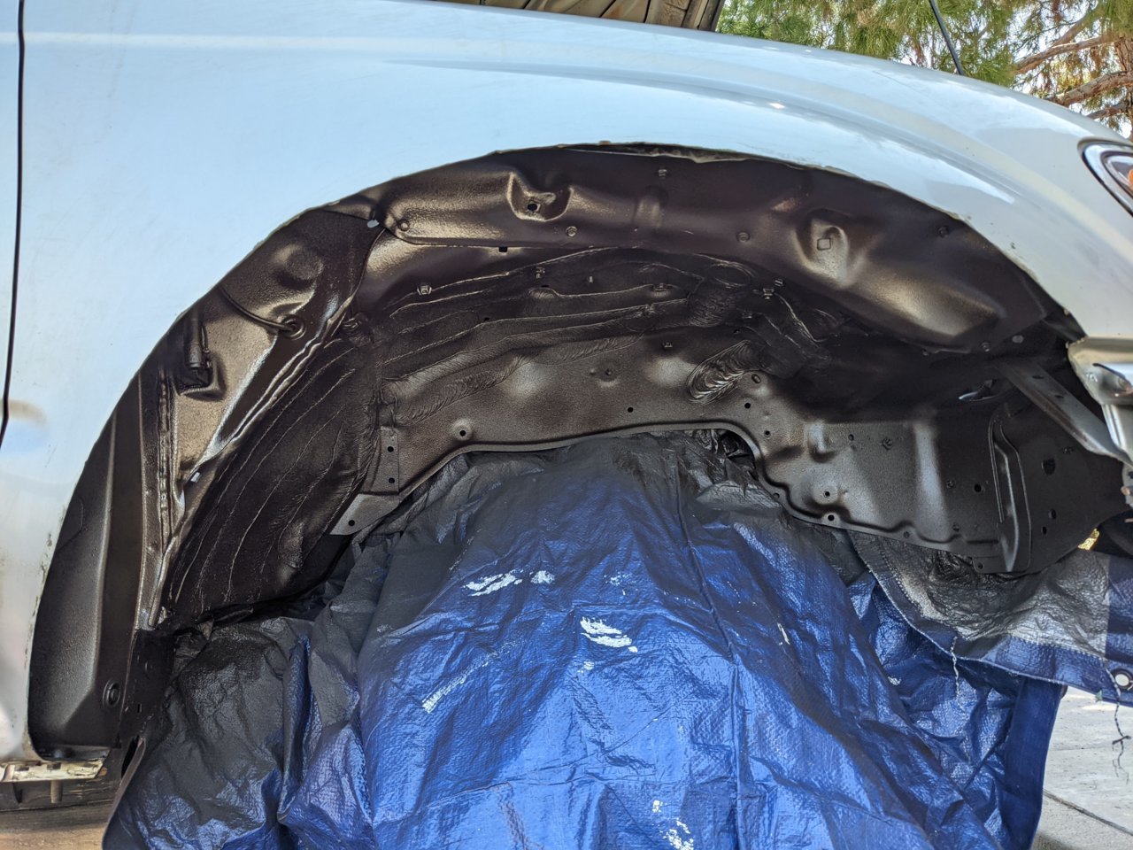

    Made an intake tube shield for when my deck plate is capped on trails, to prevent this:
    And undercoated my wheel wells bc i sledged the shit out of em and need protection there as well

    I'm thinking gear, pull that diff!
