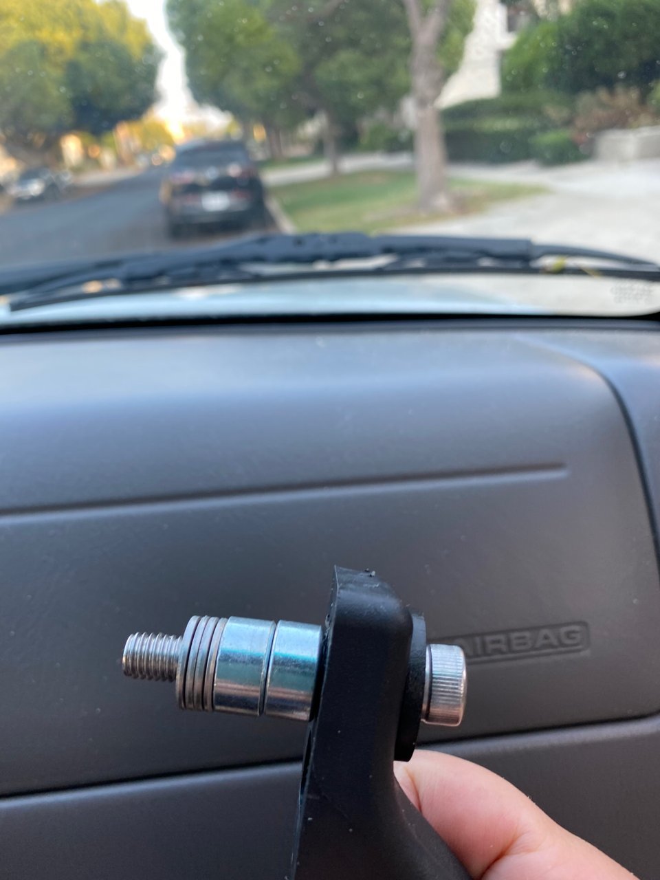

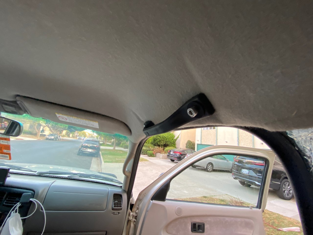

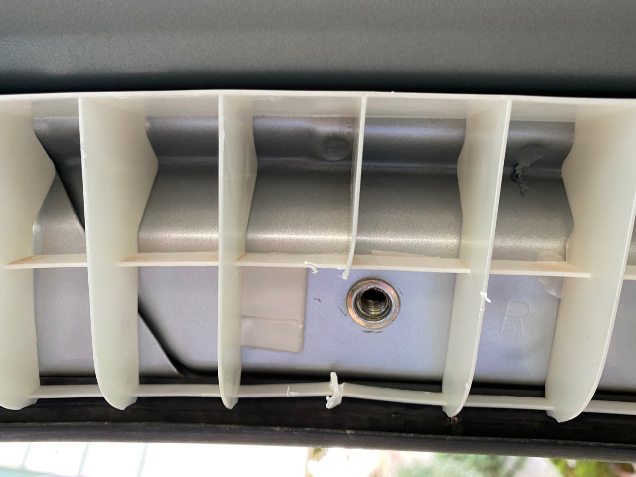

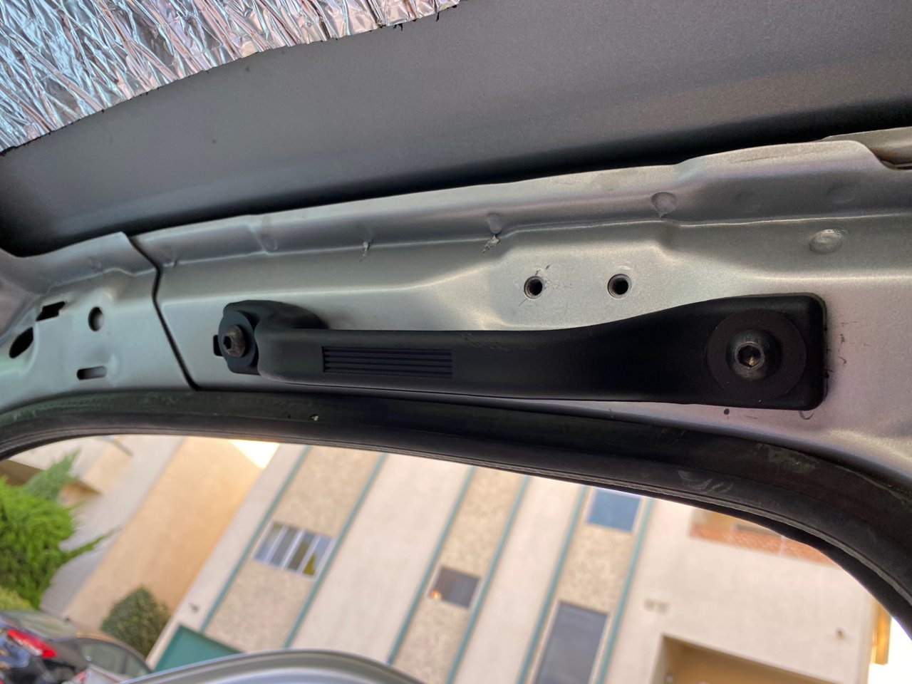

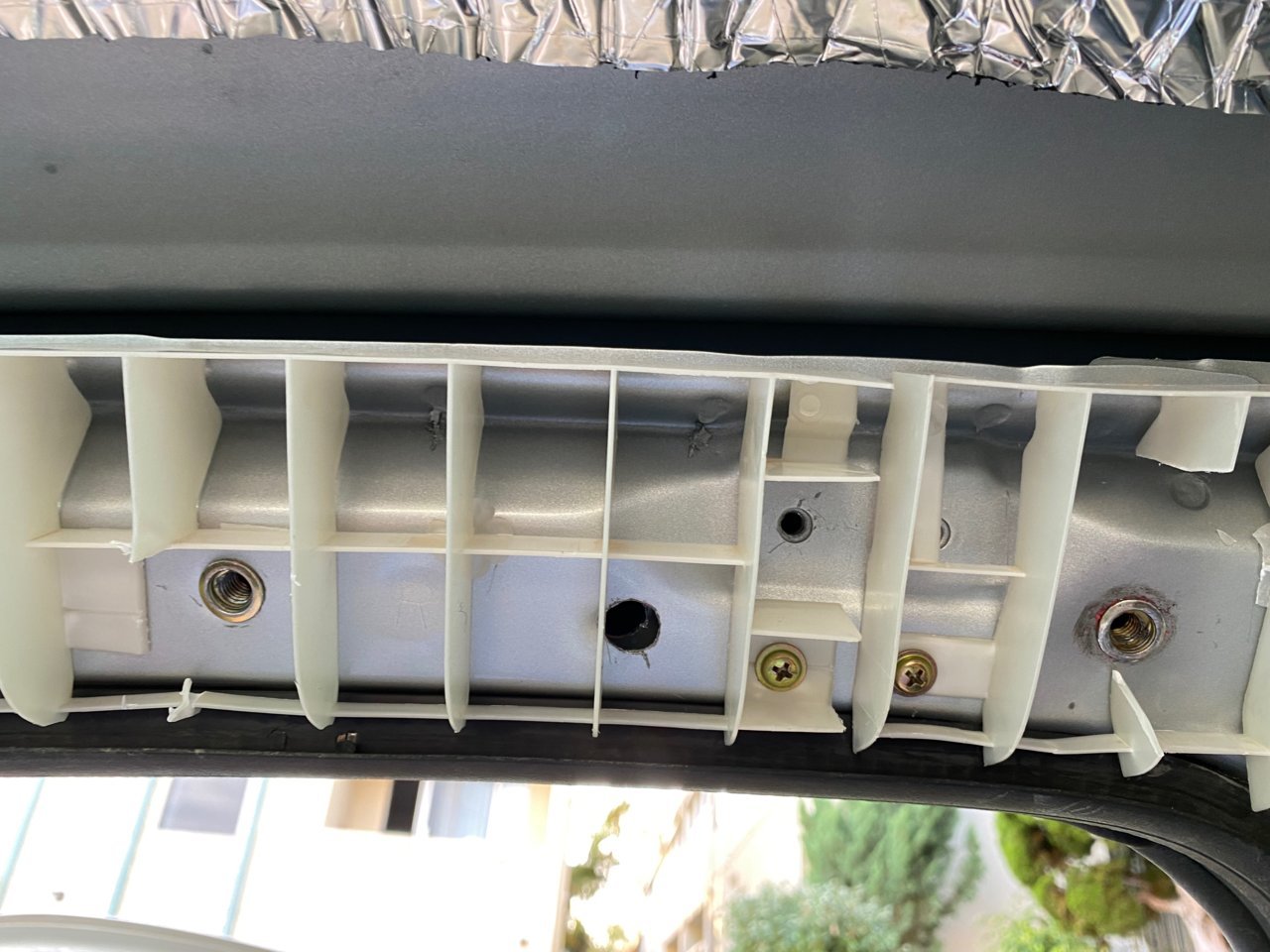

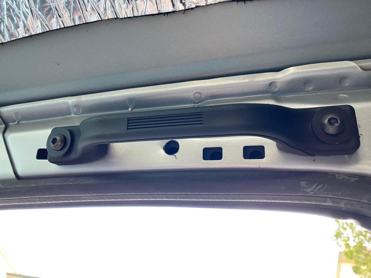

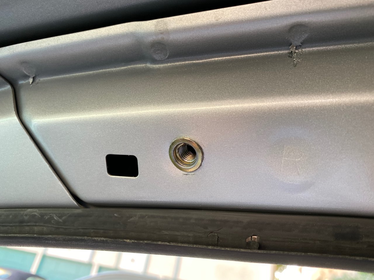

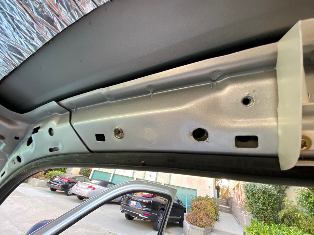

    Grab handle added to passenger side :)

    Nic but why didn't you just use the OEM holes? They are right there in your photos. Could have saved you a bunch of effort. Every cab has the mounting points for them.

    What holes are you talking about ? :D

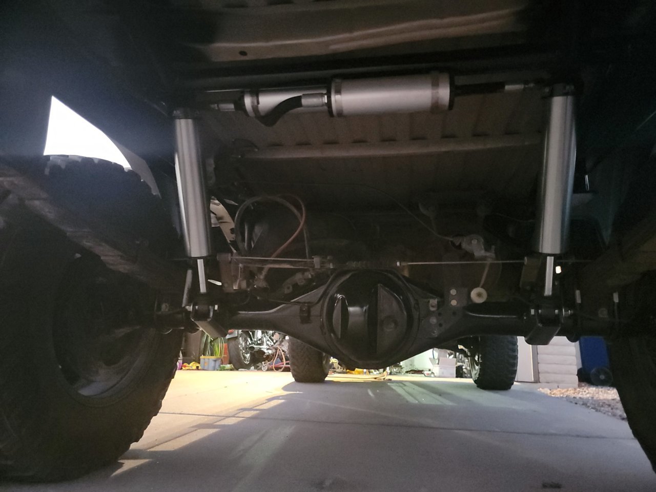

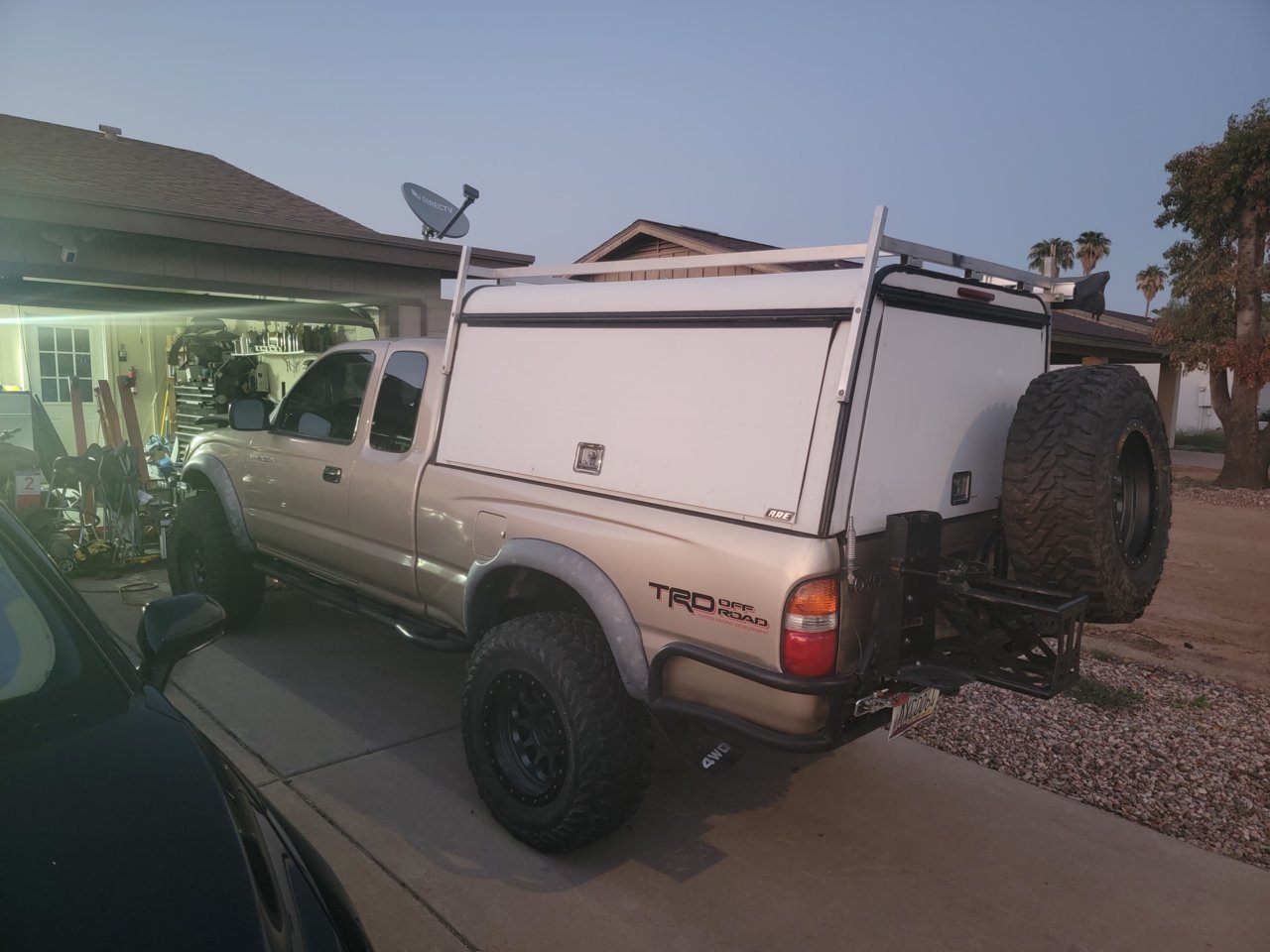

    Got my bed all bolted back on ,shell, carpet kit and swingout back on.
    I think I fucked my tailgate. It's not closing right .the top sides are separated out and the gate feels like it's trying close while it's on the bed.kind of like it's positioned just below the top of the bed.I may pull the shell and lossen the bed bolts and see if it helps. .

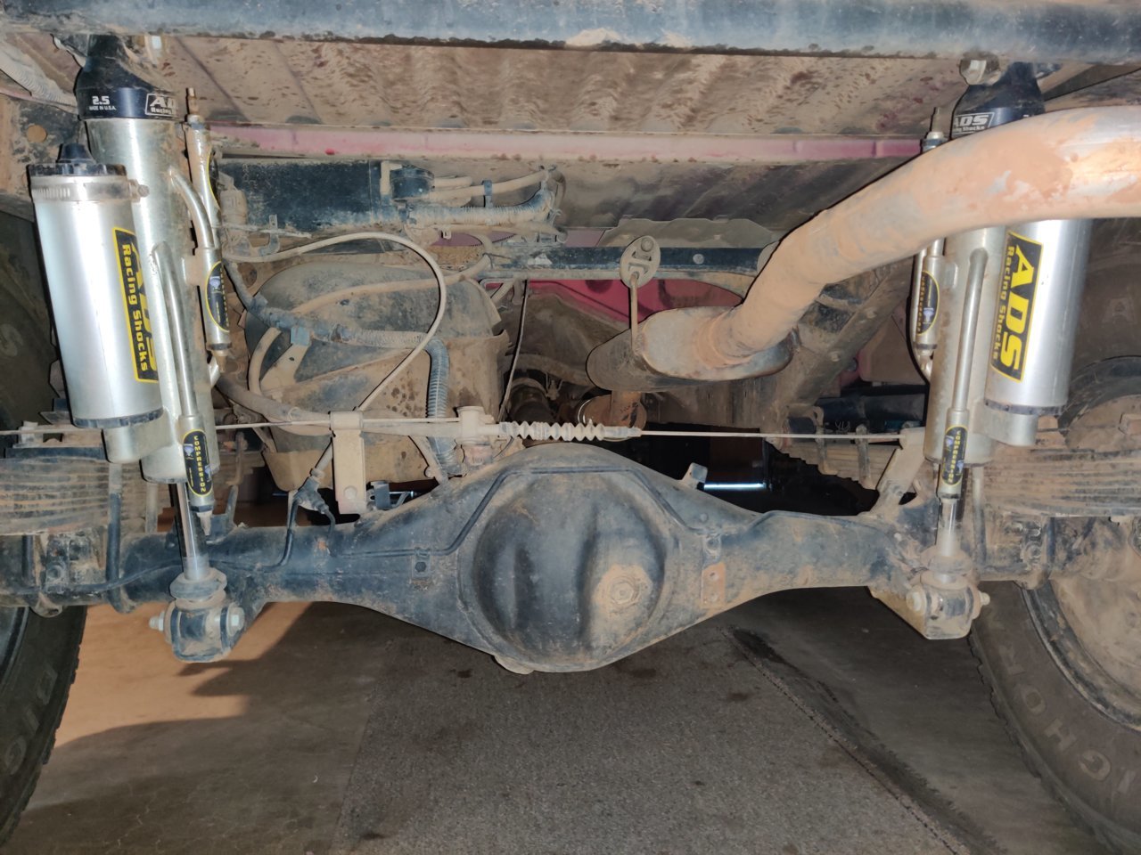

    Here's were the Shocks are sitting. I haven't found a place to flex it but I did hit all the big speed humps and jumped it a little. Didn't feel like it's bottoming out. The shocks are definitely stiffer than the icons I had before. They kind of look a little short.

    Do you have bed stiffeners? It could be separating because of your DCU

    I have some just not installed yet. Lol

    That's likely what it is. The bedsides like to flop around and move when you add weight onto the bedsides.

    they shouldn't be too short. But does look like maybe the mounting isn't 100% ideal. The tops look like they could be higher and the lower mounts could probably be a bit lower more parallel to the ground. probably okay for the most part though.

    Too many vehicles on your lot for it to be a toyota dealership.
    Awesome first post. Welsome!
    I think your gonna need to lower your lower shock mounts. Do the shocks have a 10" stroke?

    I agree it was hard to see without the bed on. If there not low enough I'll get them charged.
    [QUOTE="Digiratus, post: 26211735, member
    I think your gonna need to lower your lower shock mounts. Do the shocks have a 10" stroke?[/QUOTE]
    Yeah there 10" stroke. I told the guy I wanted them as vertical as possible. He said that he flexed it out and the leaves go slightly inverted at full bump. We'll see I guess. I'm thinking that they may have been too stiff if they were more vertical.

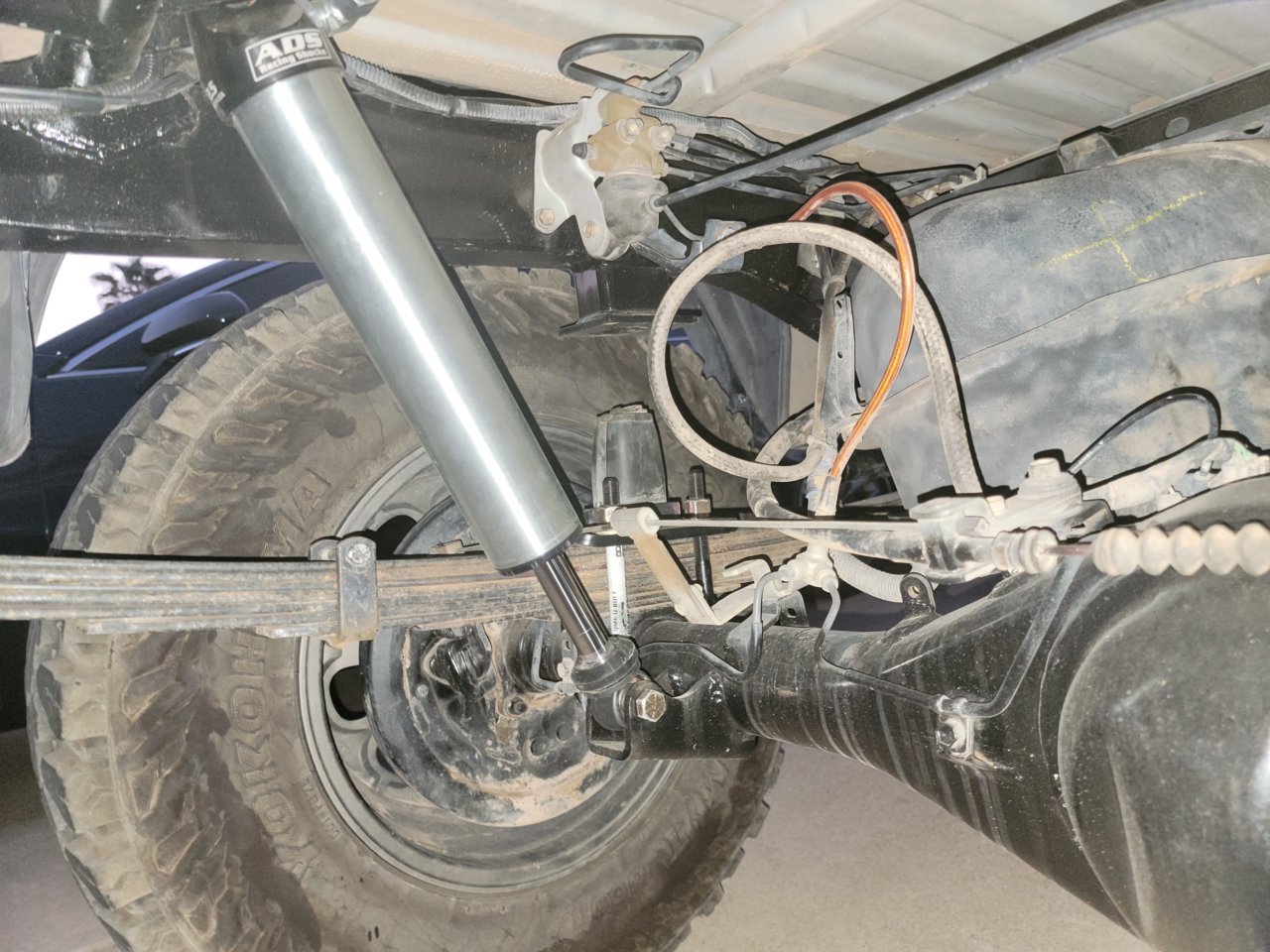

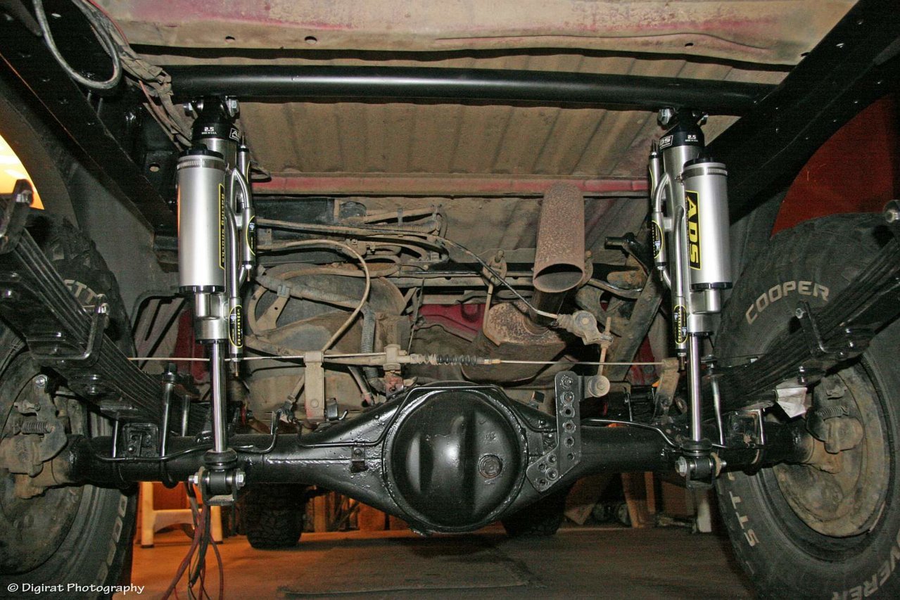

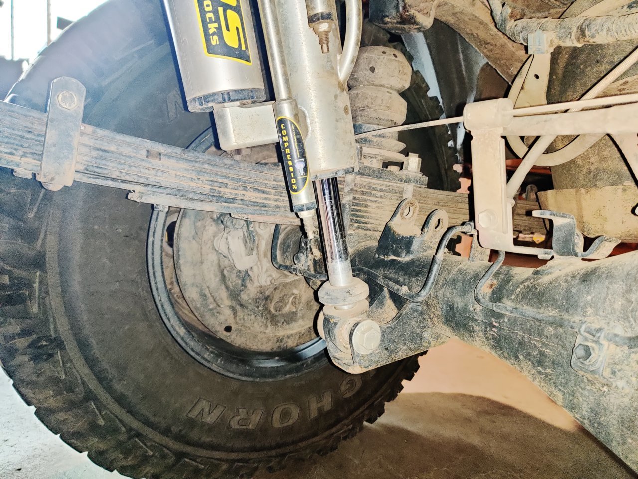

    Yeah, when you lean them back, it impacts how the valving works, seems to make them ride a little softer.
    In this pic you can see where the lower mount bolt is lined up with the bottom of the axle tube. Maybe an 1" lower than where your are. These shocks are 10" stroke. This shows it with brand new springs and no weight in the bed so it looks quite extended. Not the way it rides normally.
    _MG_9273.jpg[/QUOTE]

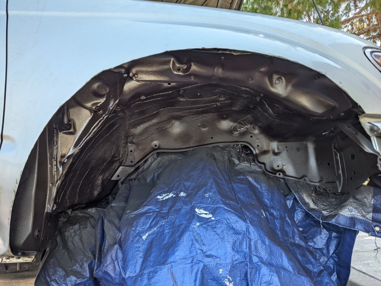

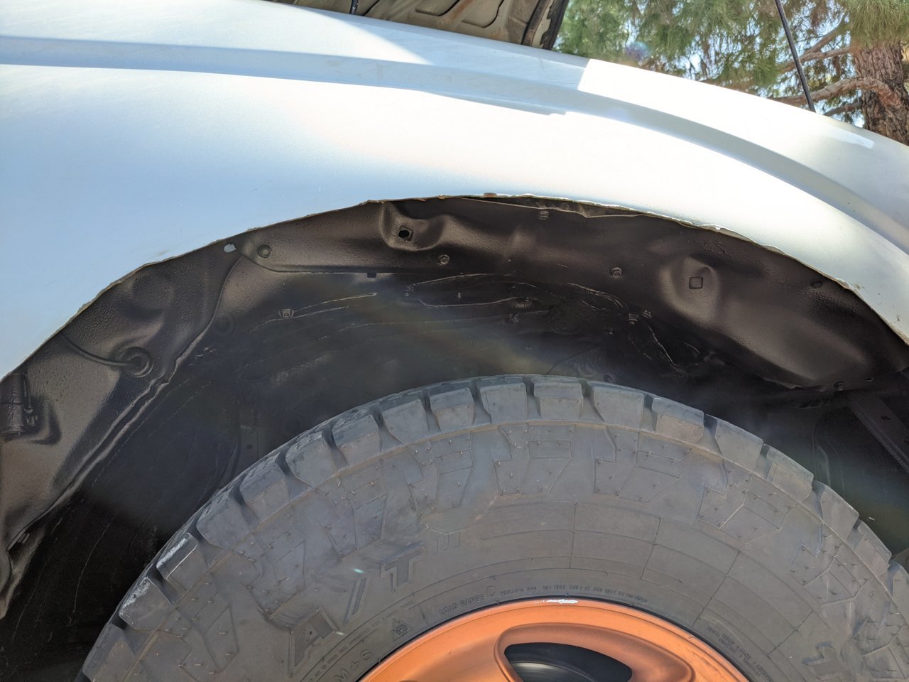

    Cut the stock fender liner to fit, threw tappers on it, should keep it safe till i can get a dorkle

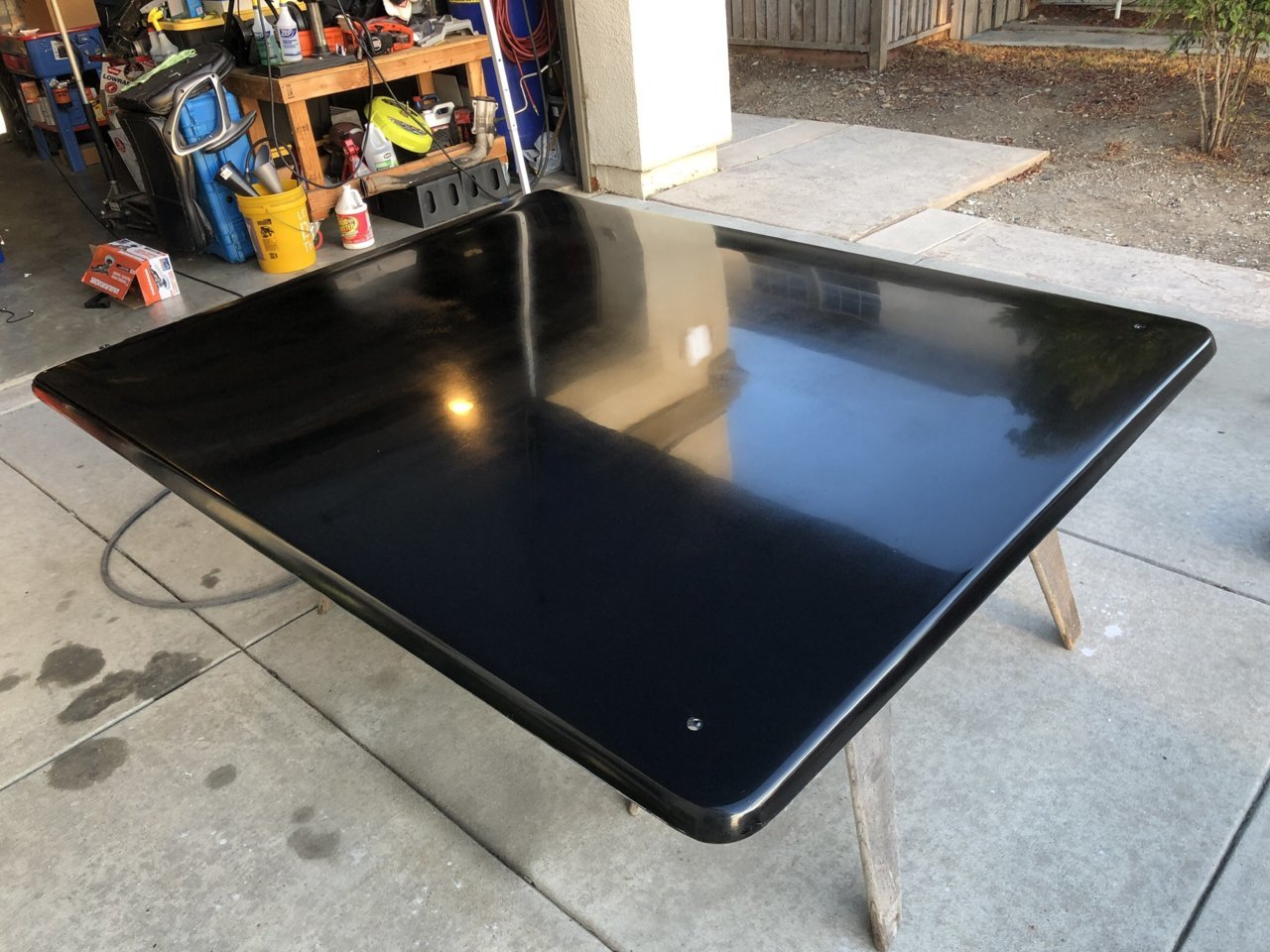

    Tonneau is painted. Too much orange peel but I’m tired of sanding so it’ll do.
    That’s just 1000 > 3000 > Hard Cut Compound. Needs more compounding then wax.
