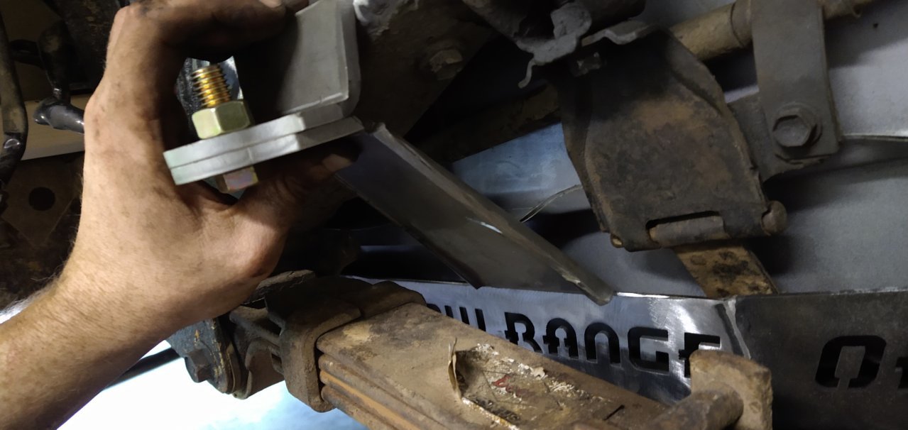

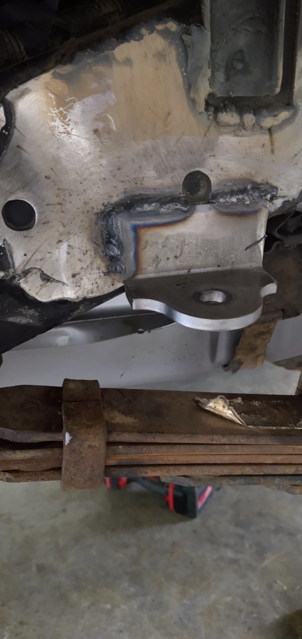

    Did a lot the last couple days, got the mock-up ready to test wheel position on my truck (moved slightly forward) and to make sure the shackle angle is close. Want to make sure I really test it all out before cutting in to the frame to french the main eye mounts.
    Might have to do a little height control haha, the old setup was a bit lower...

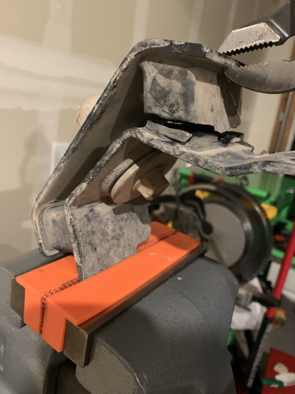

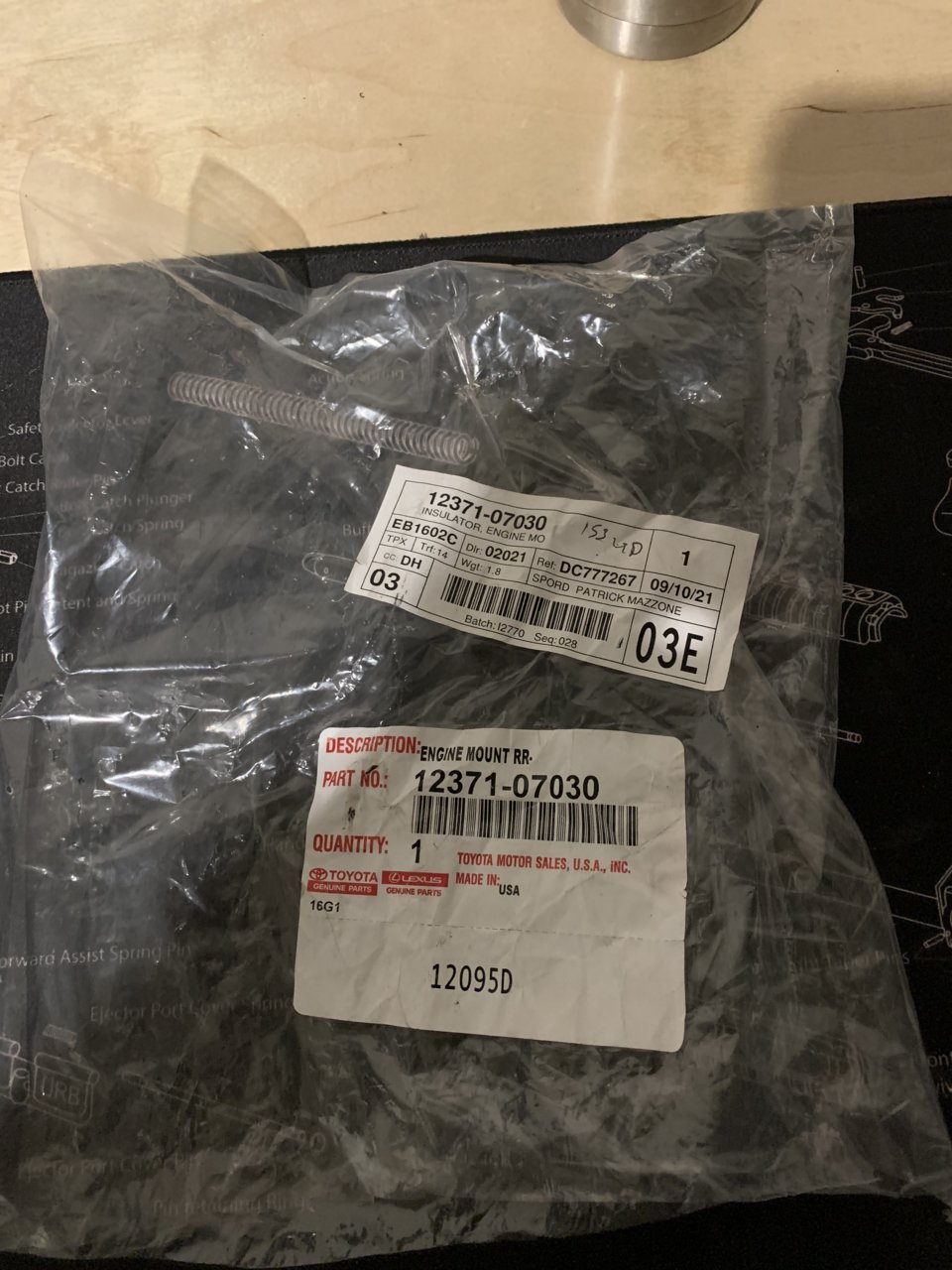

    Popped in a new trans mount this evening after dinner. I’d say this one was ready to retire, full separation on one side and almost a half inch of play in the center.
    Part number in case is looking for one for a 4wd auto v6 double cab. Paid $180 at my local dealer, but you can fond them cheaper online. I only did it cause the 2 guys at the parts counter know their shit and have been super helpful getting me part numbers for weird shit. Figured I’d throw them a bone this time around for all their help in the past.

    Won't frenching them in affect the shackle angle? Or will it be relatively minimal?

    I'm told it should only affect height since the spring end is still in the same position at the shackle end and forward or backward placement of either the main eye or shackle hangers affects shackle angle the most as well as the leaf getting longer from compression. This shouldn't do much but lower the truck, which is my main concern.

    Interesting, good to know. 63's have been on my list, so trying to learn as much as I can while I see other people do it.
