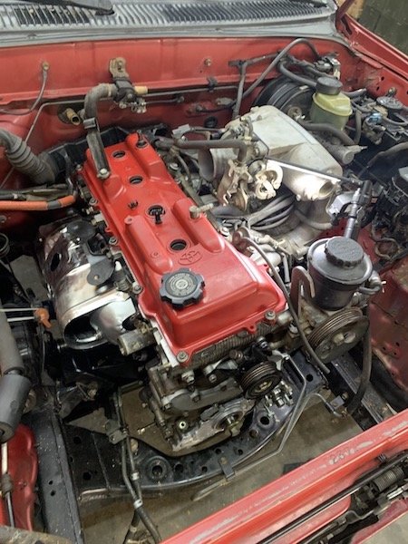

    I rebuilt this tired 1998 3RZ-FE and in the process of reinstalling.

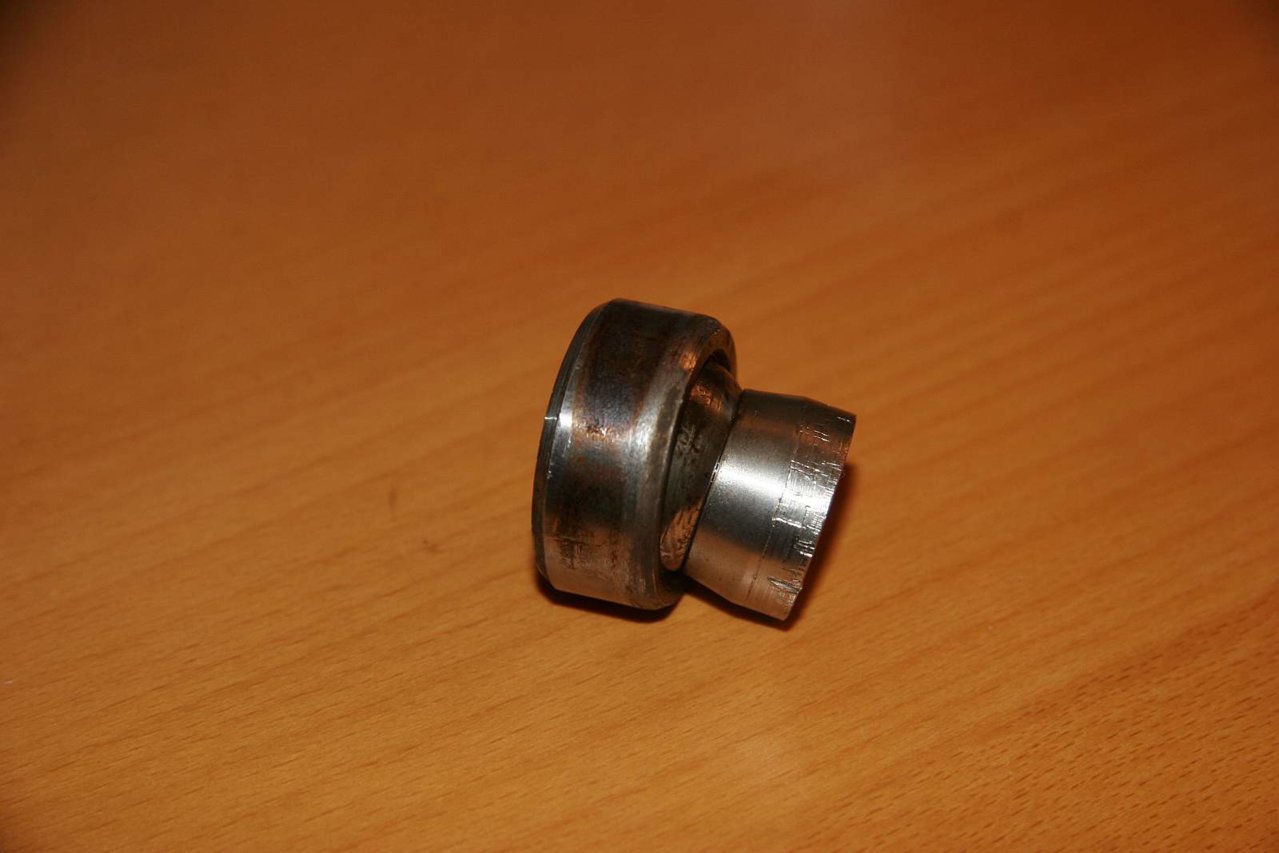

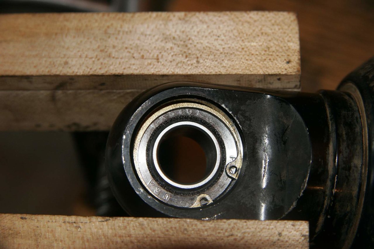

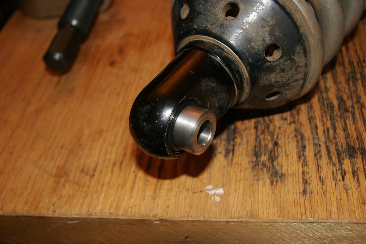

    Swapped in new lower spherical bearings on my ADS coilovers today. There are 18,000 miles on this original set from brand new.
    These had just started to squeak. I was surprised at just how loose they were. Upon closer inspection, these are not likely to be FK bearings and certainly not an "F1" fit. Pieces of the teflon sleeve liner were just falling out of the bearing.
    I am having trouble getting one half of the misalignment spacer out of this old bearing. It seems to be fused in there. Should be reusable if I can get them apart. I am open to suggestions or ideas on how to separate the two pieces.

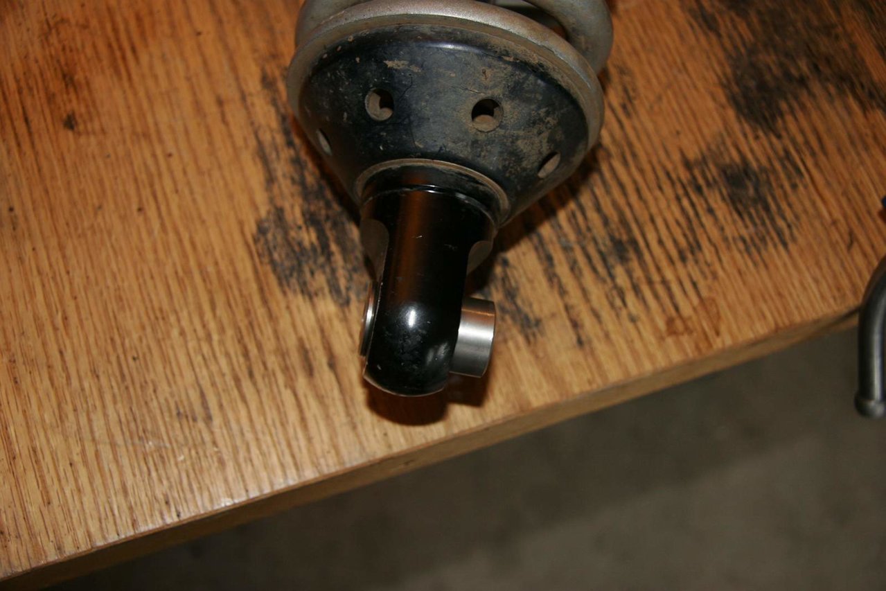

    I am going to try something new. Got these new Fox misalignment spacers with an o-ring seal from @TMFF
    Using new FK bearings with the tighter F1 spec. Hopefully I'll get more that 18K out of them.
    The new o-ring fit should be interesting.

    I've used a punch to knock them out. Then cleaned it up with a file. Maybe you have a tiny socket that could fit or grind down a bolt head until it barely fits through the bearing.

    You can use some heat to un-fuse the misalignment from the spherical bearing. And penetrating oil obviously. Heat the spherical bearing to make it slightly larger, then pull out the misalignment.
    And you'll like the FK-F1. Which FK did you go with? COM? FKS, or FKSSX?
    Lastly - the Fox misalignments look like they are actually misaligned, unlike the ADS ones, which (at least for mine) centered the shock in the lower mount. Am I seeing that correctly, and if so, is there a benefit to either way? (besides the obvious benefit of the seals, if those work)

    I'll try some heat along with Ryan's suggestion of a punch or maybe the perfectly sized socket to press it out.
    The new ones are not stainless. They are FKS10T and man are they tight when new. Much much tighter than some new, A-1 brand COM10Ts I had on hand.
    You are seeing correctly, these are misaligned. It should not make any difference in terms of performance. I installed them so the spacer pushes to bottom of the shock forward.

    Nice on all counts. I agree that the -F1 is great (and very different). I wanted to try those FKS10T-F1's next, since they are a step up from the FK-COM10T-F1, and (at least a bit) cheaper than the SS ones. So I'll be watching closely to see how yours perform. And I'm very interested in those seals. I really hope they work for you so I can get them too, hahahaha. I guess the risk is that they could trap water in there. Please do keep us posted.
    Edit: and I see the markings on the bearing now. Sorry for the dumb question earlier. :thumbsup:

    Yeah, this is a possibility. I guess we'll see.
    I was a bit disappointed that ADS does not use a better bearing by default.

    Man that's looks so clean. Love it.
    Wow i like those rubber misalignments.
    Hope they last longer!
    Your's aren't misaligned? Mine are stock. Help keep the lower spring perch out of the CV axle.

    All of the ADS COs that I've seen have all come with 'centered' misalignment spacers. Even the Kings I had came with centered ones. It has never been an issue. Hell, these fox ones only move the bottom of the shock a 1/4" so :notsure:

    Lol no consistency. My king's were offset.
    I know it doesn't matter though. Just odd.
