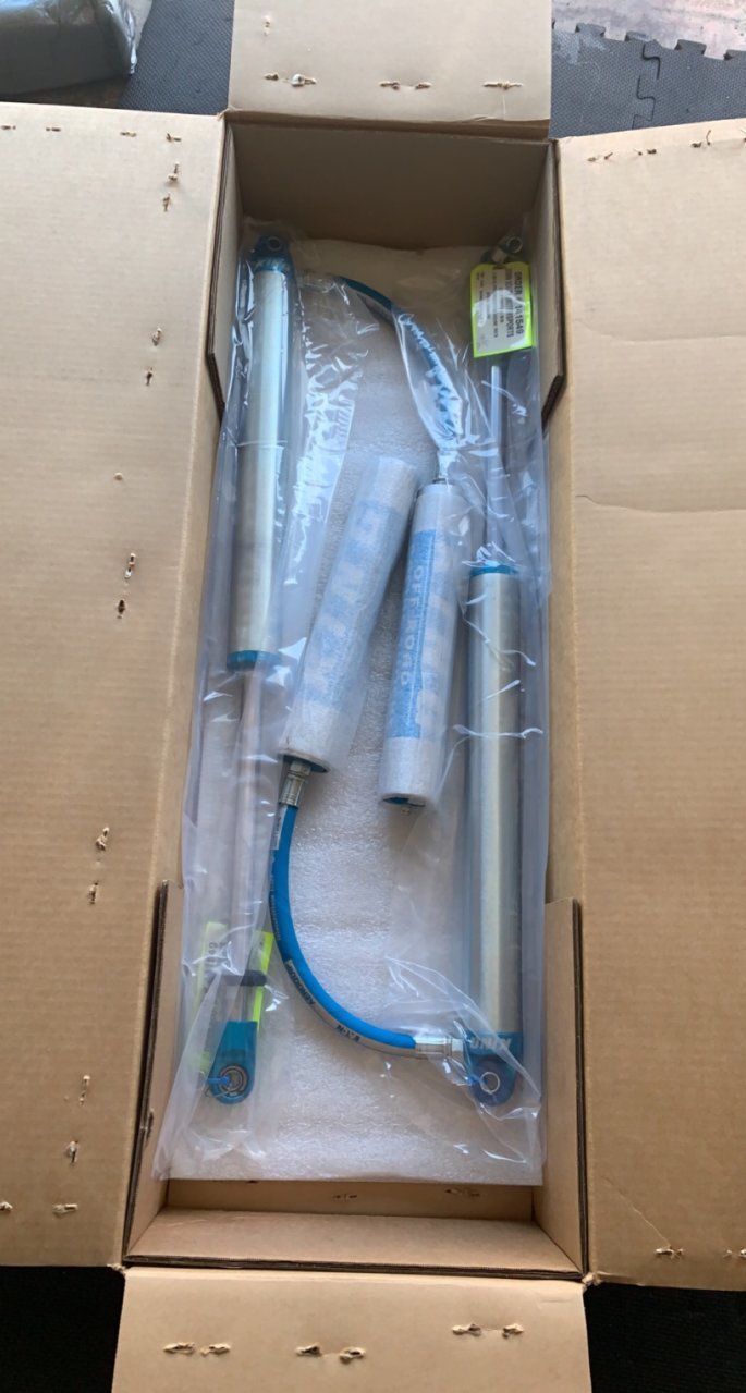

    Picked up some goodies today:D

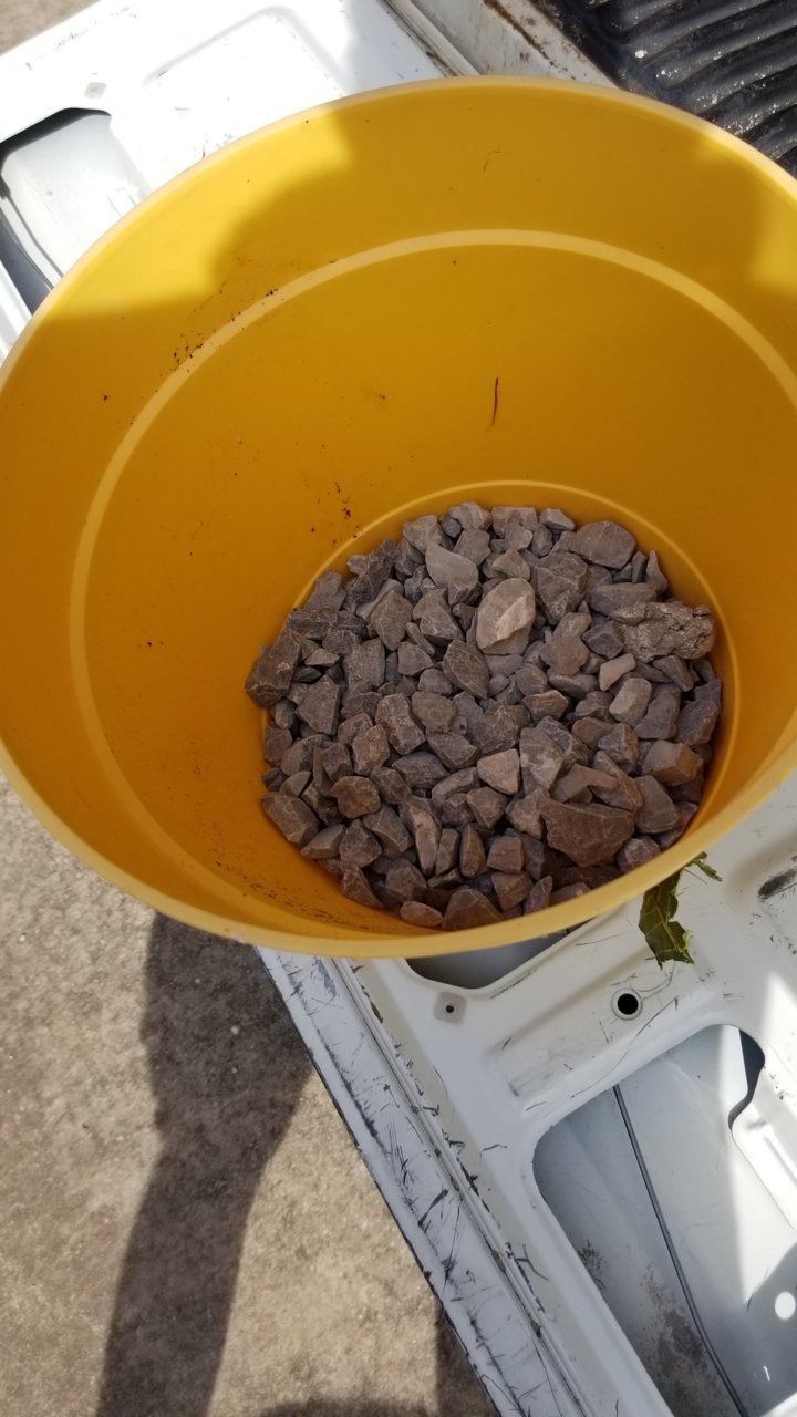

    Replaced the tailgate latch. Removed a bunch of gravel the previous owner gave to me and shop vacced inside the tailgate. Need to get a new access panel and might try tracking down a tailgate piece to match the plastic bed liner.

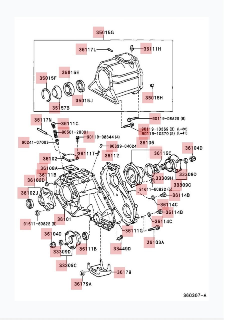

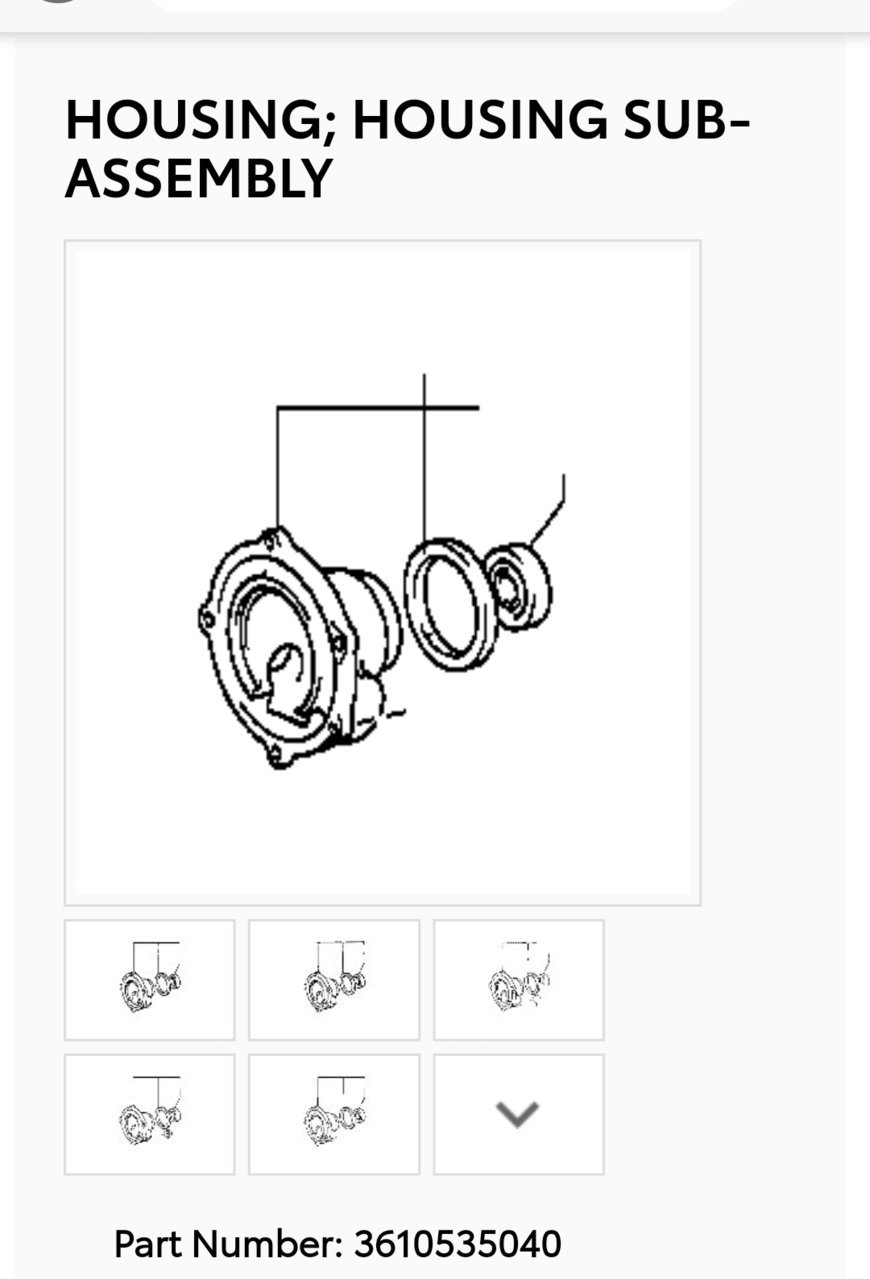

    Having some issues with what turns out to be the T-case.
    Symptom has been a squeek that (relatively) coincides with wheel speed.
    Most accurate way to describe the squeek is the sound made when the brake heat shield gets bent where it rubs on the rotor.
    The sound is not the heat sheild rubbing the rotor, or the bearing, or the hubs, or the CVs... those were already ruled out by replacing pads, bearings, re-lubing hubs etc.
    Lifted the truck on a lift, put it in drive, and got under it. The squeek is 100% coming from this area under the "Housing, sub-assembly" cover.
    I'm looking on the parts blow up and I am not seeing anything that is a bearing.
    #36105 is that sub assembly there is a part (the middle of the 3 parts) that might be, could be a bearing, but it is not labeled as such.
    Has anyone had a similar issue? Or, have additional info that might help narrow this down?

    Looks like a bearing to me. But who knows with those diagrams. I bought a part the other day and it was totaly different than the diagram and was wrong. So...yeah. Should be a bearing in there though to support the output shaft.

    Kind of what I'm thinking. Sucks that the diagram isn't more useful. (actually the diagram is fine, the descriptions suck).
    I guess I'll be buying the assembly... at least it comes with the seal. lol
