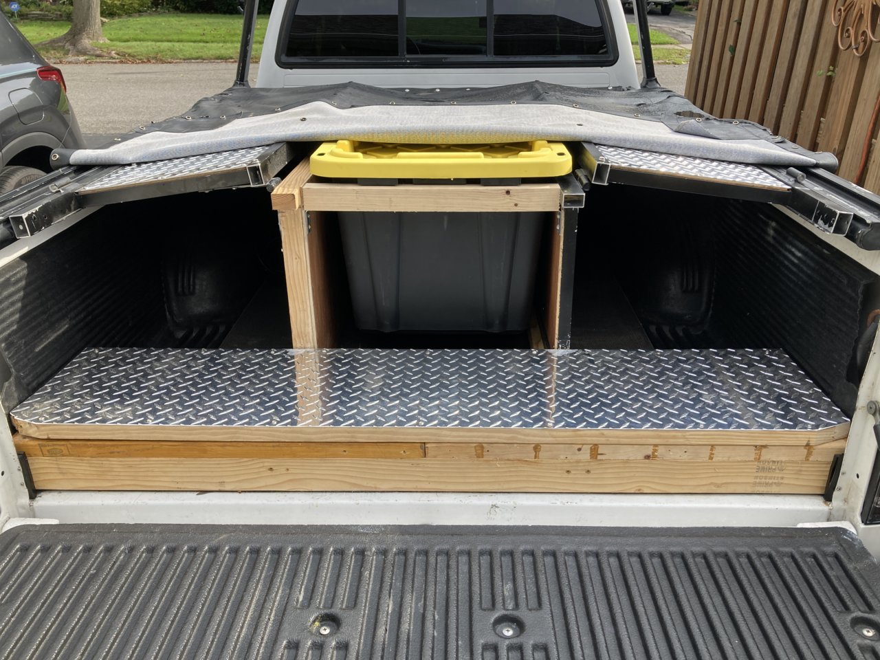

  14. Sep 25, 2021 at 6:07 AM
    HansWorldTravels
    HansWorldTravels Well-Known Member
    Jun 3, 2014
    #131202
    164
    Hans
    Colorado/NY/Germany
    '03 Toyota Tacoma 3.4L Ext Cab TRD
    Roll & Ram repairs on '95 Front end crash repairs on '03
    Not worth a new thread, what/where does this go?
    I suspect in a front wheel well, but I may be wrong. It has 3 threaded studs and a stamped ‘hook’.
    It is in my bin of ‘extra’ parts with a bunch of water/mud flaps from when I replaced the DS inner fender/radiator mount 5-6 years ago.
    ontarioyota likes this.

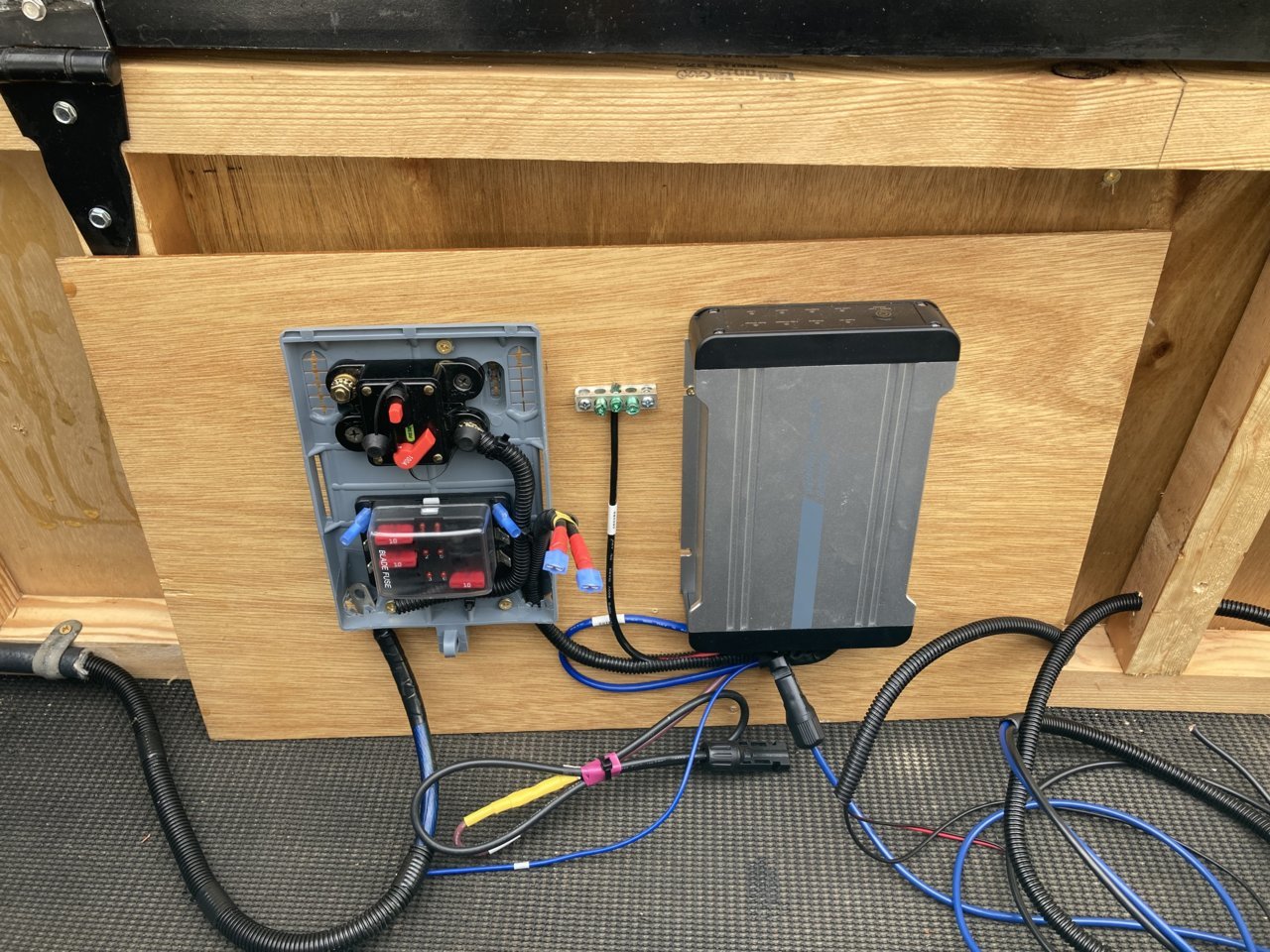

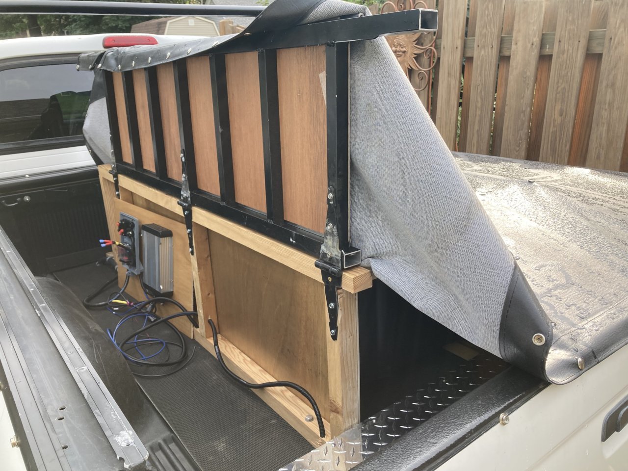

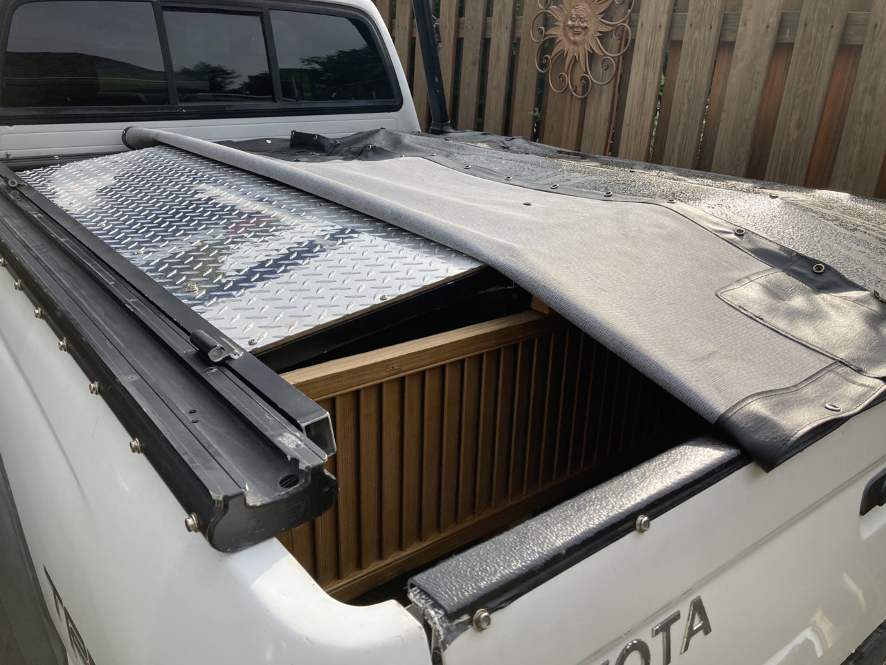

  16. Sep 25, 2021 at 7:16 AM
    HansWorldTravels
    Jun 3, 2014
    #131202
    164
    Hans
    Colorado/NY/Germany
    18657487-3AE3-405A-B193-9D4BC1E5C7F4.jpg Working on this again. I need to decide on a couple strategic locations to add locks for the back fold down and 2 side hatches.
    Wiring from battery/engine compartment and into a 7-pin plug completed, plus an ACC line from center console, to use a 20amp DC-DC charge controller for my tiny house on wheels.
    482F5FD4-8D9C-46EF-9345-211462F5E96F.jpg CB00C1A7-5E48-4314-9B6F-0C03103F978D.jpg image.jpg
