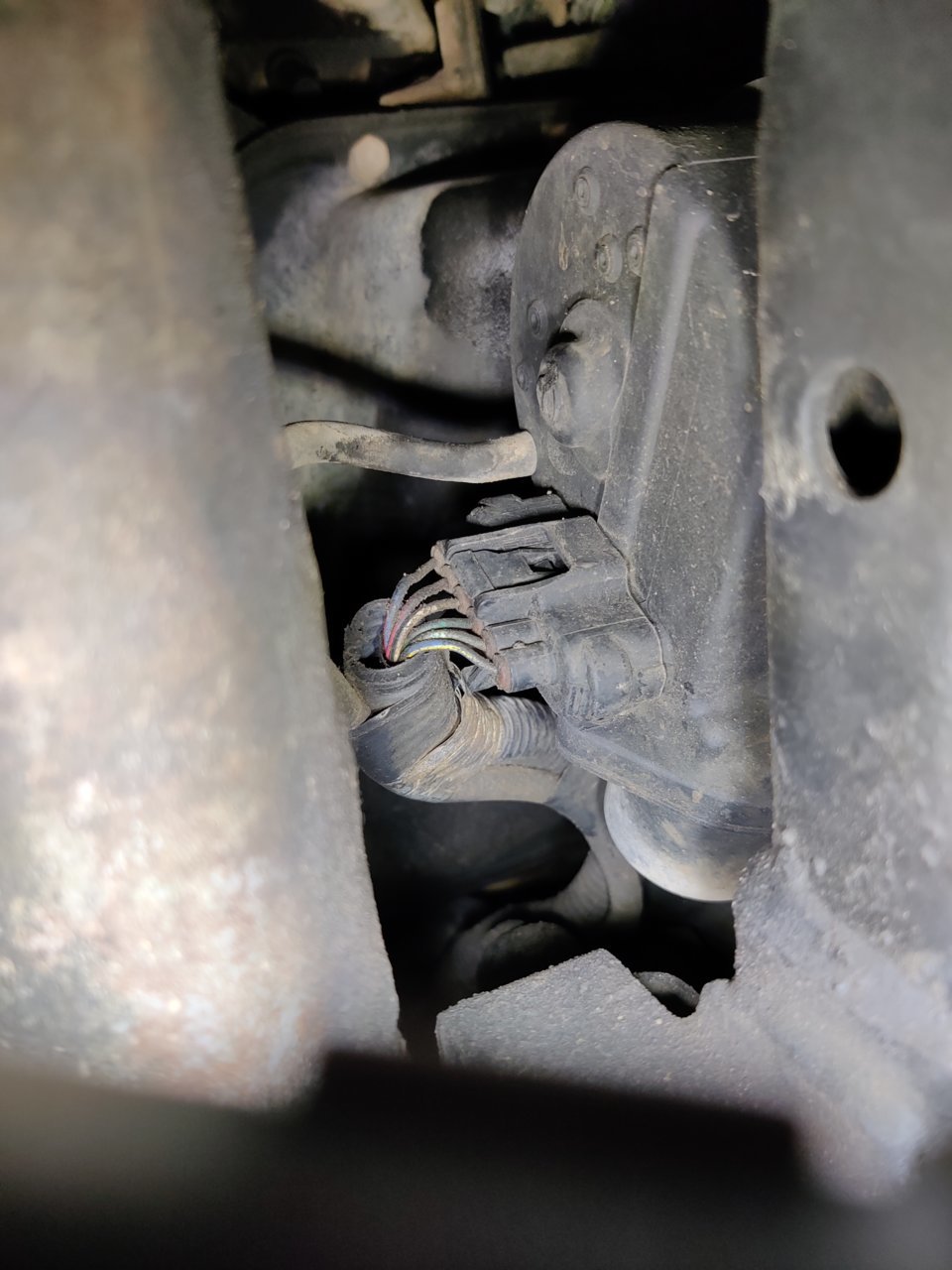

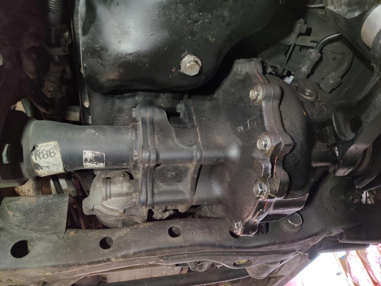

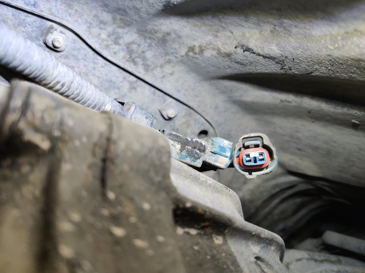

    I just saw the breather tube coming out of the actuator and assumed it was a Vacuum line and a quick look through my Haynes manual starting pointing towards VSV's so I jumped to conclusions.
    I'm still not sure what is wrong with the 4x4 system. I did see a thread in the 2nd Gen section of people soldering the terminals of the Actuator motor in place and I believe that's the same differential (from 00-06) I'm not sure if that's what my deal is but I'm not sure where else to look.

    what is the issue? 4wd not working? Actuator could have seized/died but doesn’t look like you have enough rust for that. Typically that happens out here where salt water gets into the actuator from a damaged breather and lack of use makes them seize. What are the symptoms?

    totally different diff than 2nd gen tacomas. They have an 8'' clamshell that is also a wider setup than our 7.5'' clamshell.
    Id first check the switch on the tcase to make sure it's sending the signal for the actuator to actually move first. Common for those to go out.

    When I shift into 4Hi / 4Lo the light never comes on and the front drive doesn't engage. The locker and low range is working beautifully. The last time I used it when I shifted back into 2wd the dash lights stayed lit for maybe 5 minutes and then the light went off and I haven't seen it since then.

    Do I just ground the connector for the 4wd position switch

    Unless it's different on the 03, that shouldn't cause any issues. Mines unplugged for 2 low.

    I unplugged it to test it

    Is this a j shift or push button tcase?
    I think it's pins two and six at the actuator that should show voltage when engaged disengaged. Not sure if it says in the Haynes manual but the fsm has it.

    J shift
    I have the Haynes manual on my lap and the owners manual on the table next to me.
    The Haynes manual shows a different Actuator Connector Terminal (im assuming it's for the button push shift selector T case) the connector on my differential is in a single row of six pins vs the shown two rows of three pins.
    It's still 6 pins so maybe the order is the same if I can determine one from six

    Are you positive that your front driveshaft is not spinning when in low? That would indicate a mechanical problem with the tcase not the ADD.

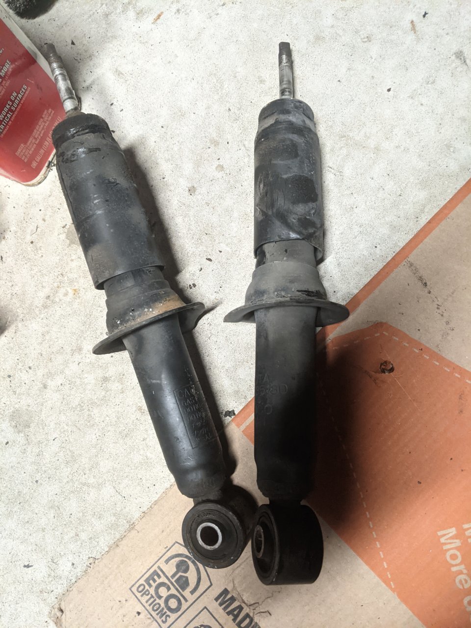

    Finally got around to swapping out the front original (2004) shocks for a new set of 5100's: left it on 1st clip, stock height with stock springs. Ride is soooo much better, feels better planted over bumps. PXL_20210930_122506409.jpg

    Good call and easy enough to test. Put on 4 jack stands and see what's happening. If the front drive shaft spins but not the passenger tire then it's an issue at the ADD. If the front drive shaft doesn't even spin then it's an issue at the tcase. J shifts don't have an actuator on the t-case do they? I have a push button.

    @cynicalrider. Just the actuator on the front dif.
    I'll put it on jack stands this afternoon and see what's spinning.

    The front driveline does indeed spin. I think it's something to do with the actuator. I'll try and find a wire diagram for that straight 6 actuator plug and maybe pull the case off for the actuator motor and take a look in there. The truck does have 300,000 miles and Utah has a large surplus of salt and is all too happy to throw it on the roads.
