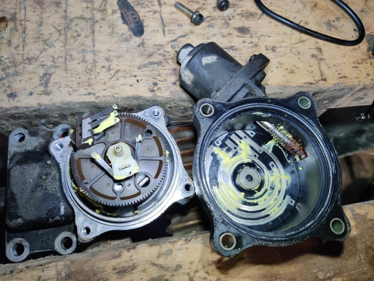

    Make sure the brushes move freely. I was able to salvage a bad actuator because one of them was sticking.
    I attached the fsm, that should help you figure it out.

    Yeah that's the toyota lube they put in all their actuators and it's not cheap. I need to rebuild my locker actuator soon and I plan on just trying diaelectric grease.

    Thanks for the FSM pdf. I tried to pull it up front the sticky thread but it was redirecting to a second gen diagram
    The brushes all seemed to be in working order but the electric motor is toasted. It would be nice if you could just replace the electric motor
    Dorman makes a replacement at around $220
    OEM from the nearest dealer is $500

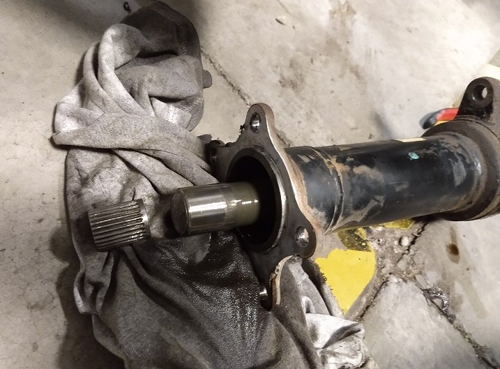

    Anyone know the length/size of the 4 bolts used to attach the manual tube to the front diff?

    Dang. Is that your picture?
    That sucks. Reminds of the guys that break CV's and the spline side gets stuck in the diff.

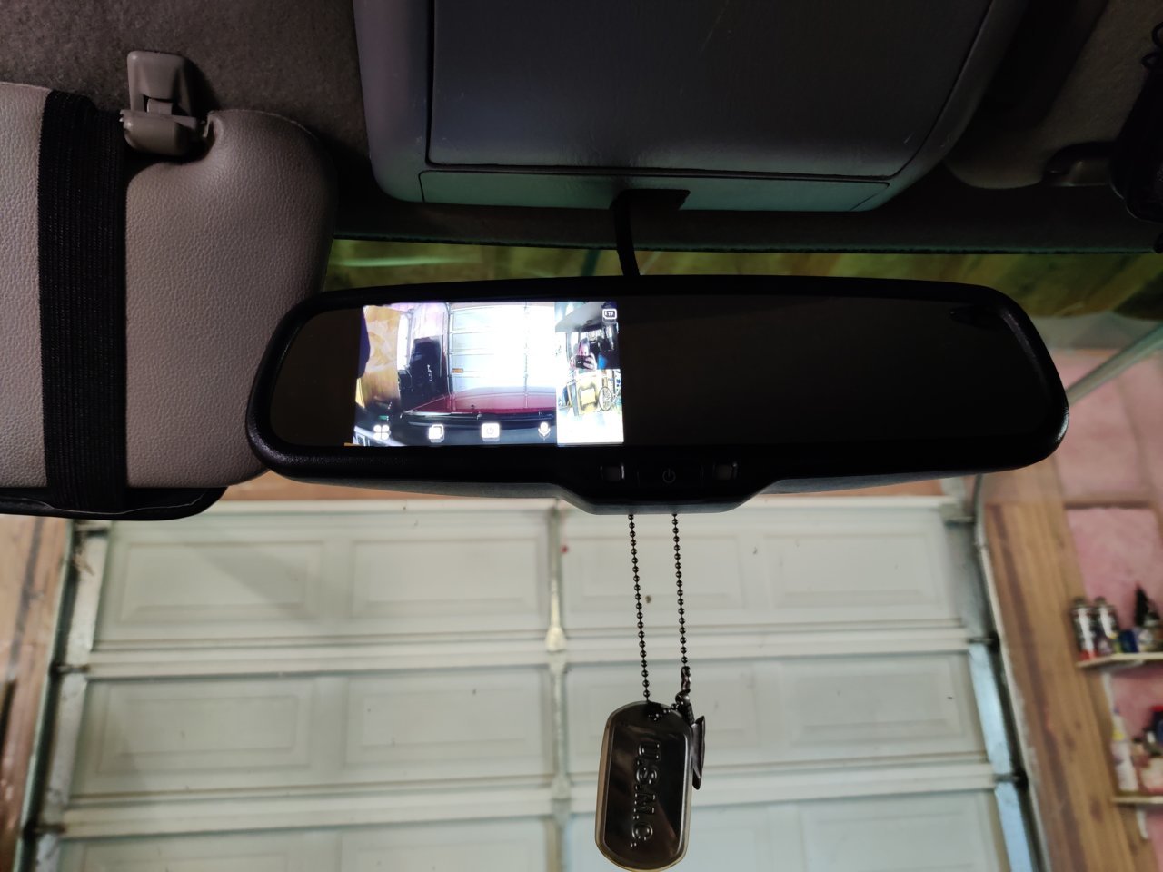

    "Master Tailgaters" makes several rear view mirror with a lot of bells and whistles including WiFi transmitter, internal battery, and G shock sensors.
    They look identical to the mirrors in the 2nd and 3rd gen tacos
    They have several options to choose from and can be found on Amazon.
    I installed one a couple months back but have hardly messed with it
    Some of the menu options are obviously translated from Chinese and not very well haha

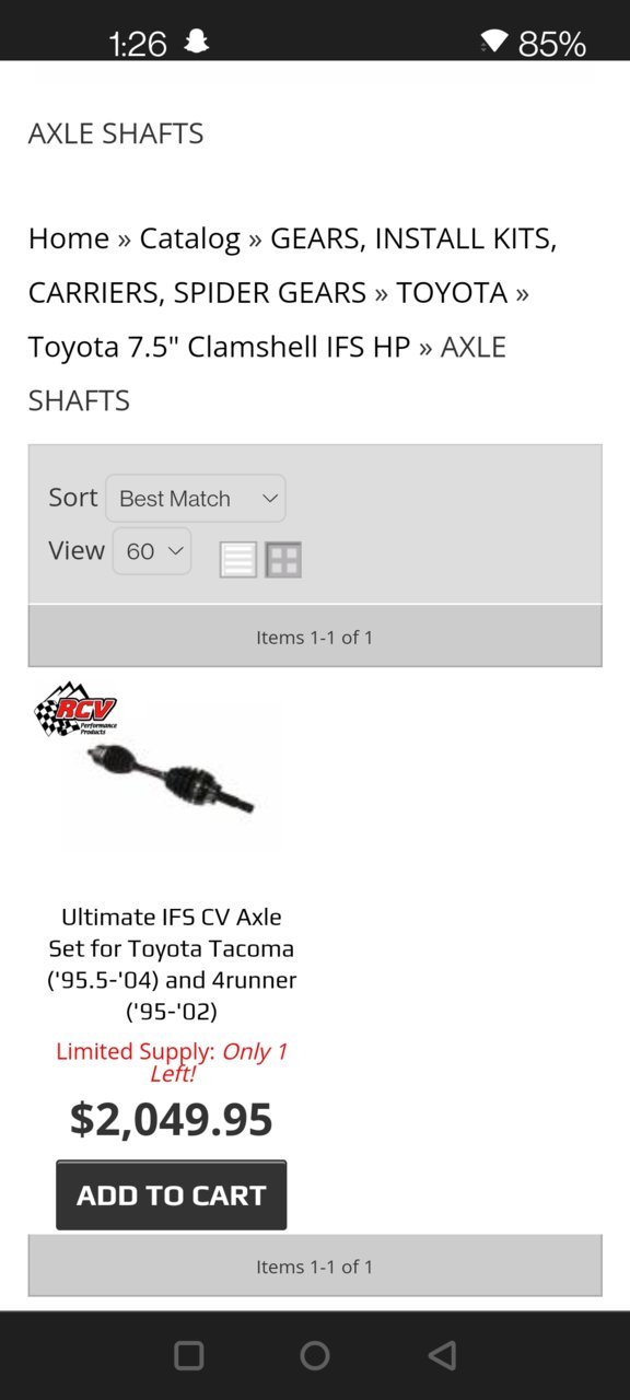

    @cynicalrider I believe ECGS has the RCV CV axles
    Or at least one haha

    Damn, 2k for just one?
    Last I checked it wasn't 4k for a set...
