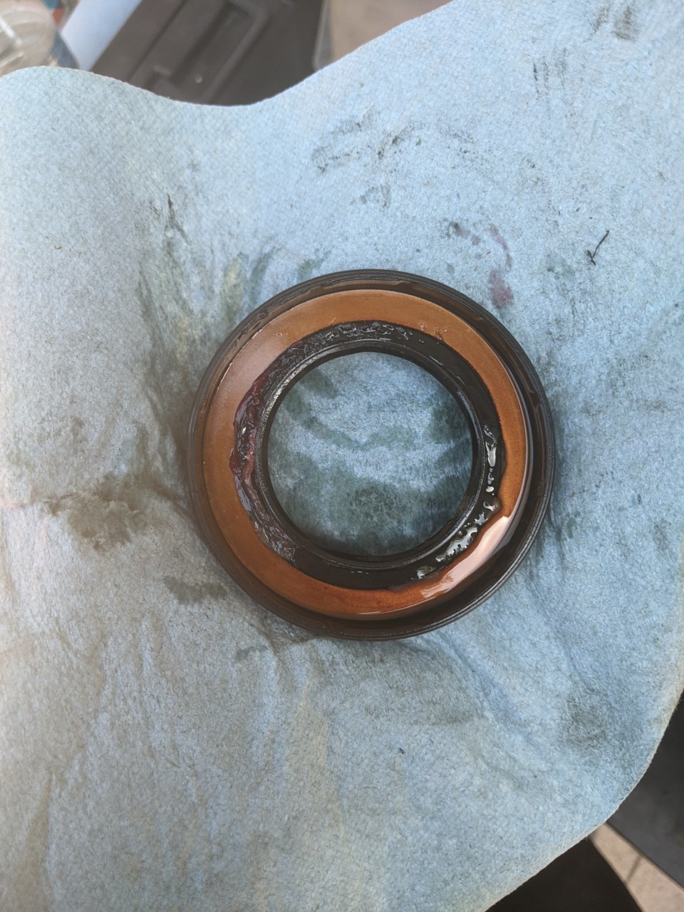

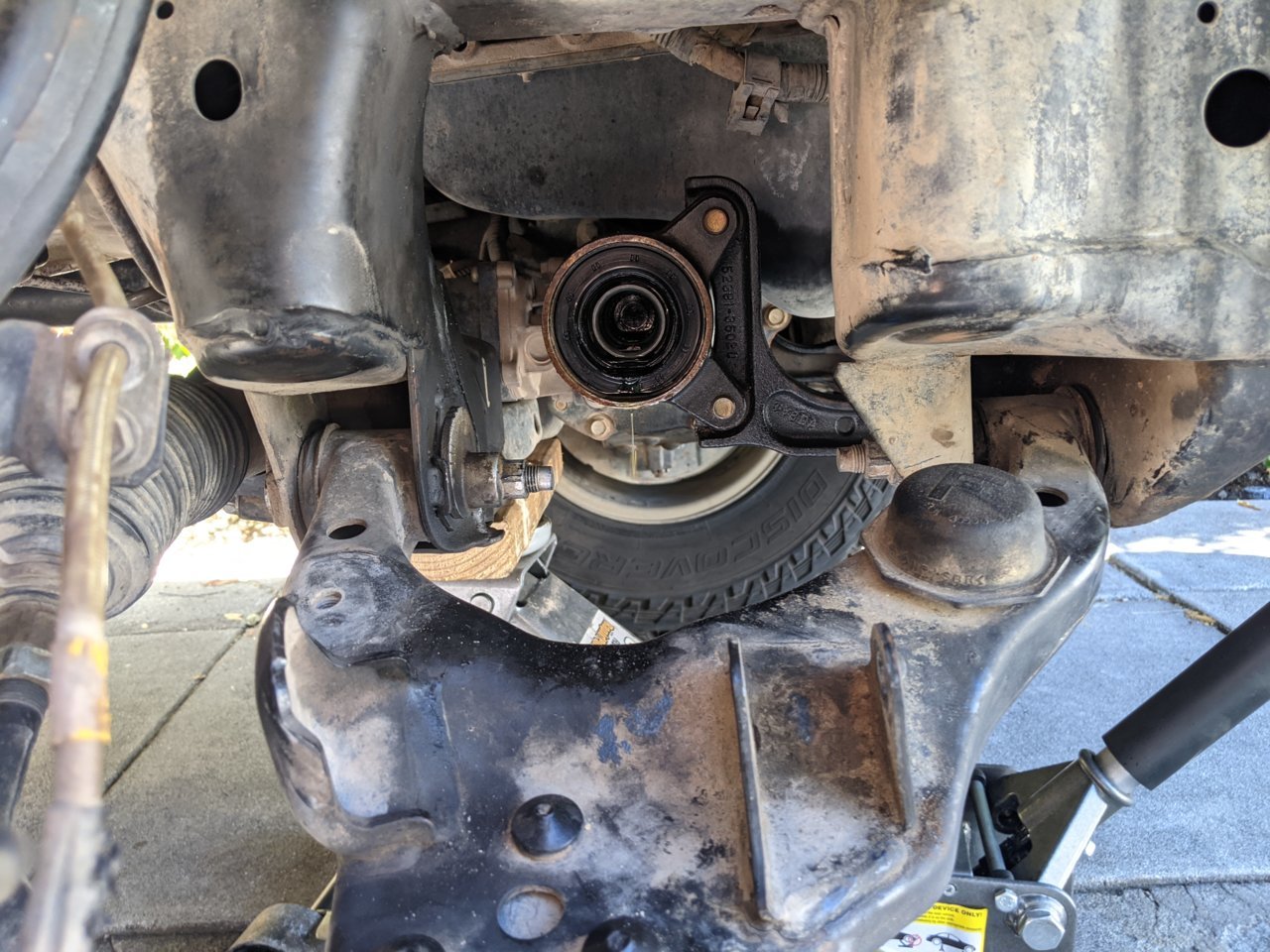

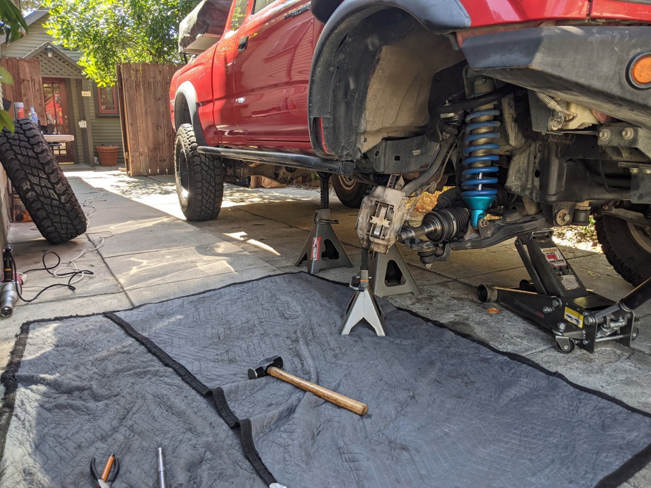

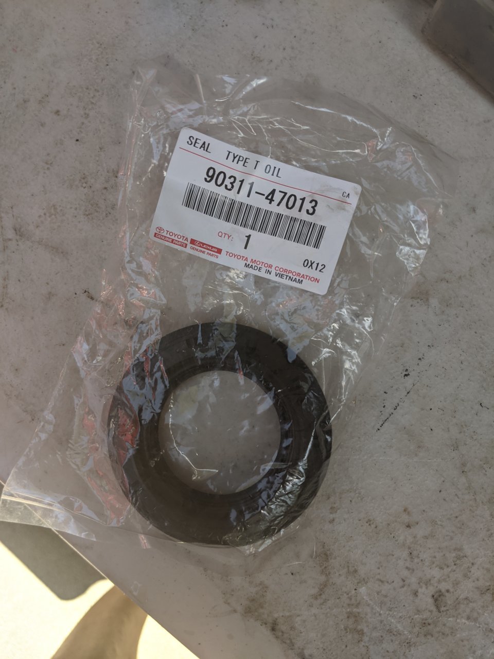

    Third time this year I've replaced the passenger side CV axle seal...hoping the third time was the charm today.
    First time I just let the axle drive it in, started leaking again within a week. But it was a slow leak so I lived with it for awhile.
    Second time I replaced it was last weekend. Used a seal driver and ended up driving it in a bit too far on one side and didn't want to damage it by trying to pull it back out. So I put it all together and the next day it was puking oil, lol.
    So today I took it all apart again, froze the new seal overnight to make it easier to slide in and pulled the coilover out so I could go straight at the seal with the driver instead of having to work around it. Made it way easier. Measured the depth at a tad over the FSM recommended 4.5mm. I did have to back it out a tad in one corner, hoping I didn't screw up the spring on the back of the seal when I did.
    Here's hoping it works :fingerscrossed: did a test drive around the block and so far so good. This seal is a temperamental bastard.
    Old seal
    New seal

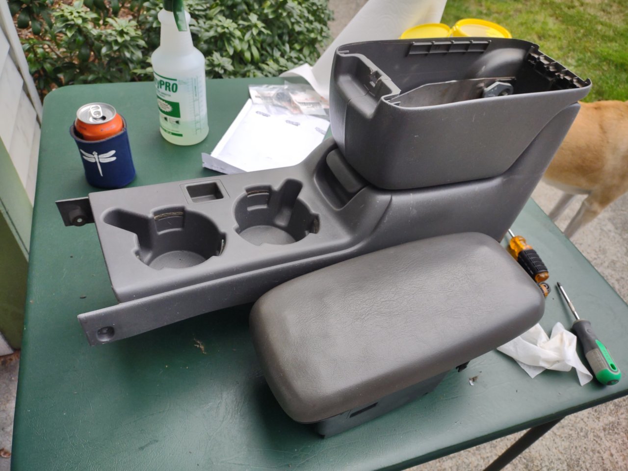

    I tried to buy a new center console but they are discontinued and out of stock nationally. Had two ordered canceled. I needed the entire base and the armrest, which is not swappable with any '95.5-'00 armrest. Plus the wrong color. So I bought one from a wrecking yard in California. It was disgusting but nothing was broken. Cleaned it up and put it in today, with new cupholder inserts as well.

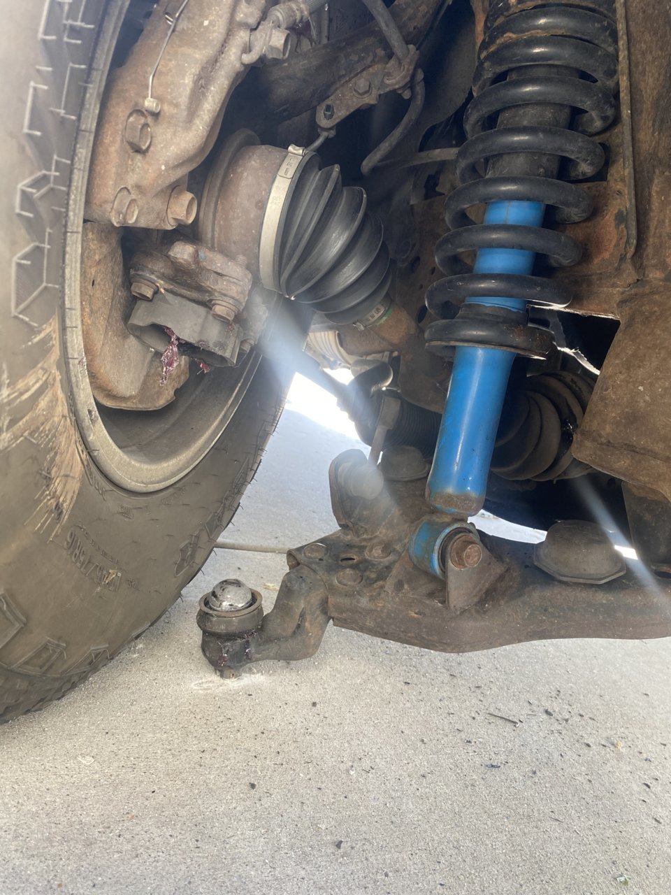

    Not really, checked them about a week ago for movement or anything and they looked fine then I hit them with grease. Heard a squeak yesterday checked again and looked online for a replacement set but fell asleep before I ordered them. Then today, popped off while pulling into my driveway! Just the LBJ and my CV is jacked. I can’t tell about my tire, I think there is a chunk out of it but can’t tell yet.

    Yeah man, lucky day! Pulled into the driveway and it popped!
