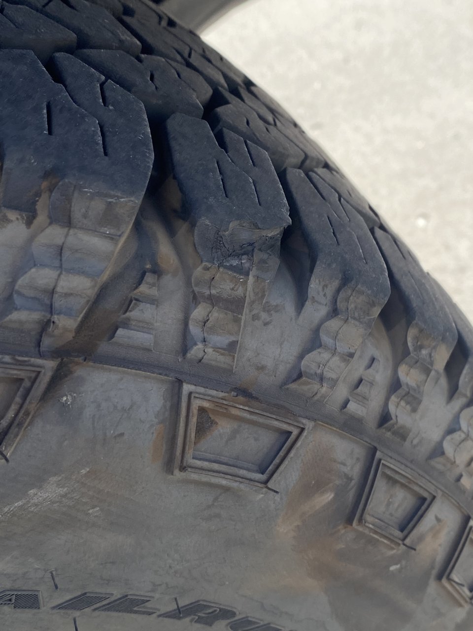

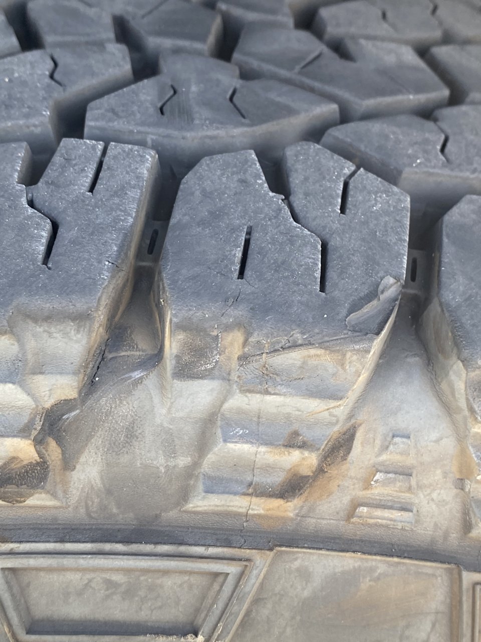

    I got my lower ball joint all fixed, but it left some gashes in my tire. Do you think these are bad enough to replace my tire or should I still send it?

    Those are totally fine to run with. They seem to be into the tread blocks and not the tire casing

    if u have no issues with shaking while driving or problems with tire shop balancing it out then no. Doesnt look bad imo, ive chunked worse on curbs/rocks

    You can do more damage to a tire on a single off road trip, and still be fine :anonymous:

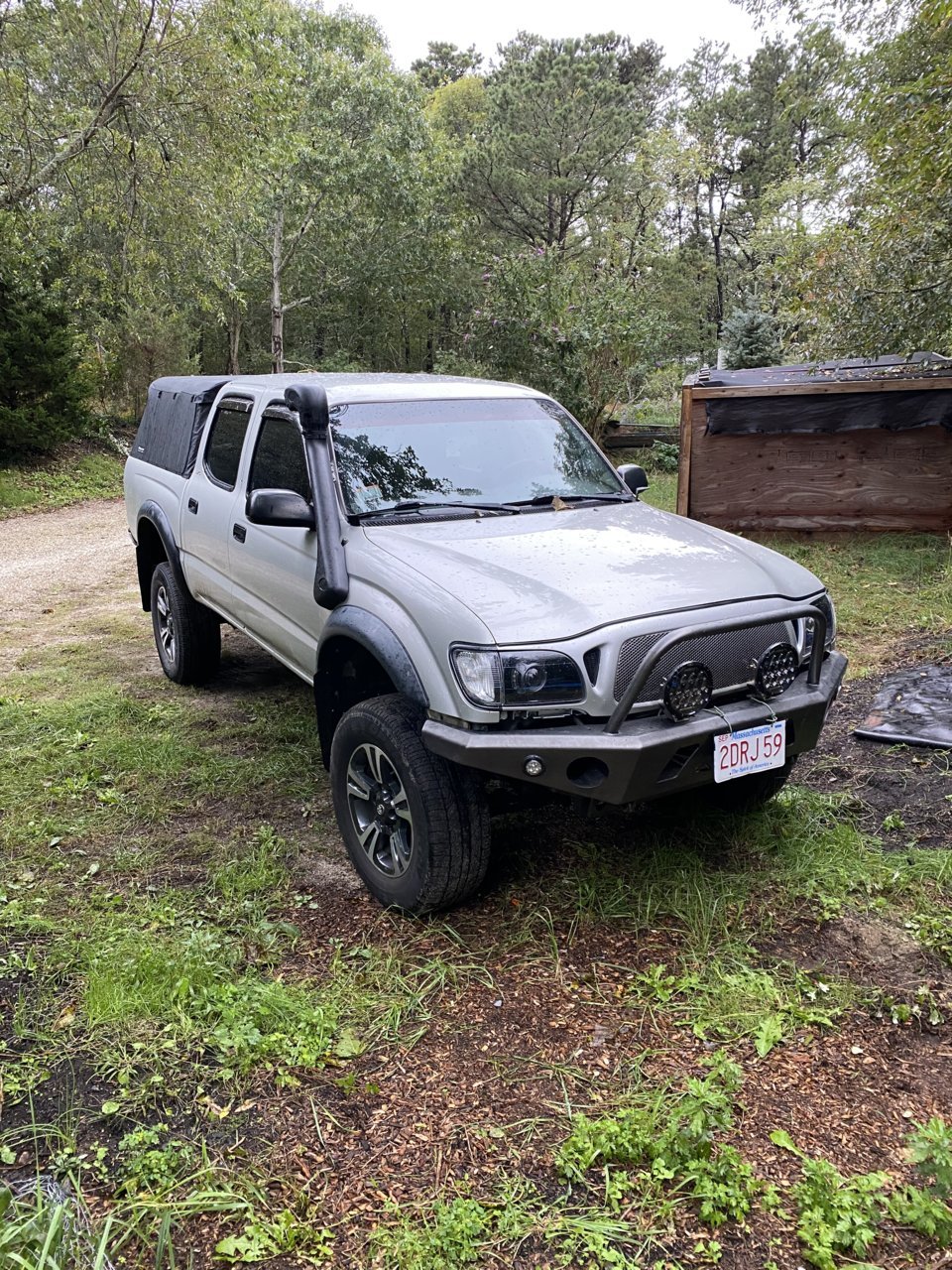

    Sold the 1st gen today.. the new owner is a local Toyota enthusiast and plans to solid axle swap, supercharge, and 5spd swap. He’s got all the parts. Couldn’t be happier about this dude buying it.

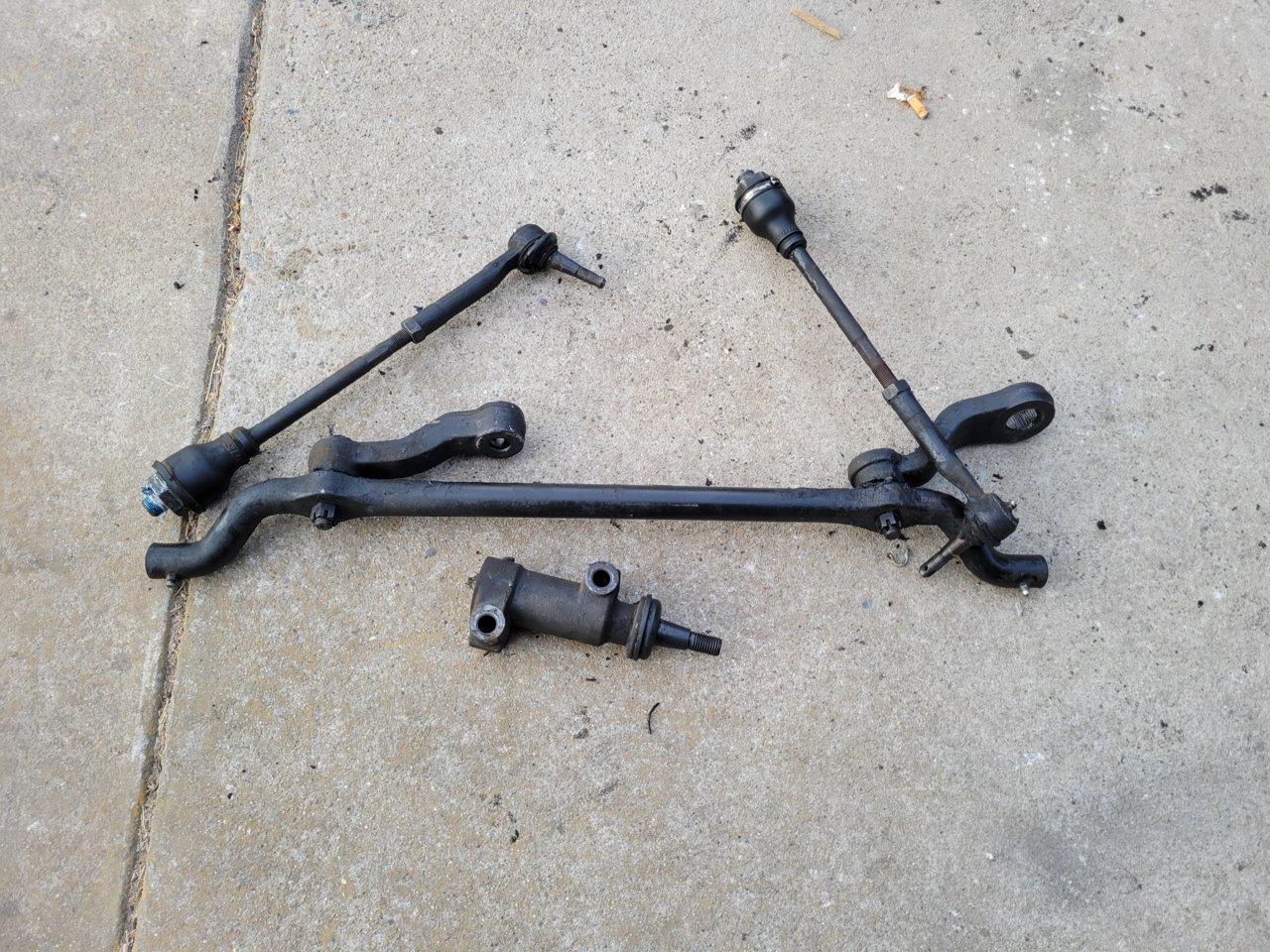

    More tear down on wife's truck. Not Tacoma, but fun wrenching stuff none the less. :rofl:
    Pitman arm, Idler arm, Idler arm bracket, and drag link removed.
    Had to get the Pitman arm off because there are 3 spline or 4 spline for her truck. Needed to find out which. Also, the pitman and idler connection was really wobbly, needed to find out if the holes in the drag link were ovaled out. (they weren't, so I don't have to replace it)
    Also found the nut holding the Pitman arm was bearly finger tight, and the Pitman arm wasn't even pressed on to the splines... if that nut would have fallen off, the Pitman arm would have fallen off the steering box... and no steering :eek:

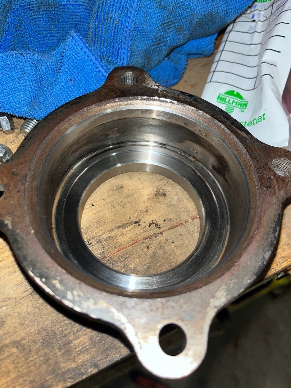

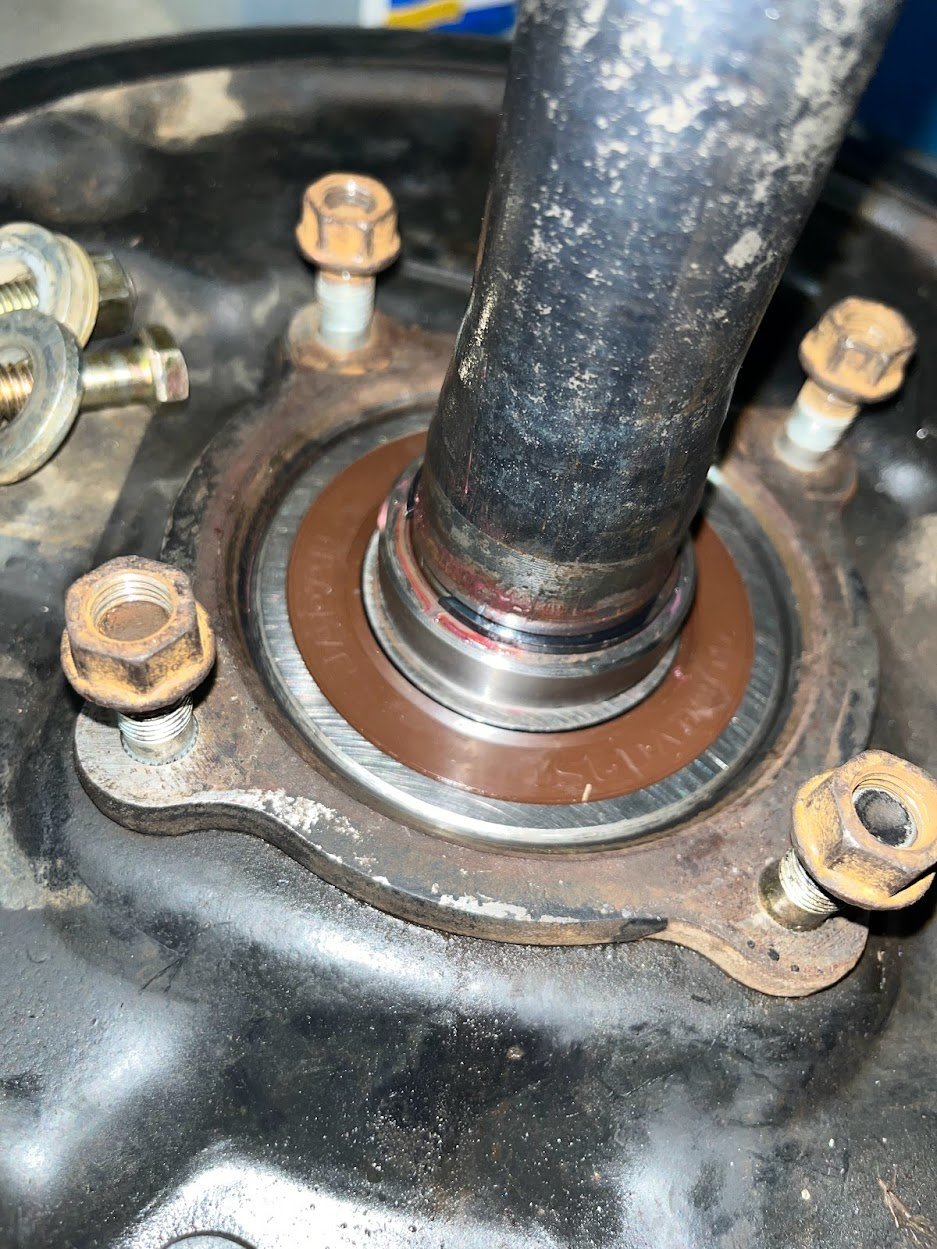

    Finally got around to changing my rear wheel bearings out...well...one of them. Also got my tires road force balanced today, very excited to see how they ride now
    I have no idea what this staining is, sanded it down and went with it.
    ISeBkYoq9vd0INWbKm9_HmPfTv2lgWfJ4GdHb5qW_25737dc430b161983ae8c01cb550fd06c5806d8f.jpg
    Once I got the right press setup and stopped stripping studs :facepalm:, it went smoothly
