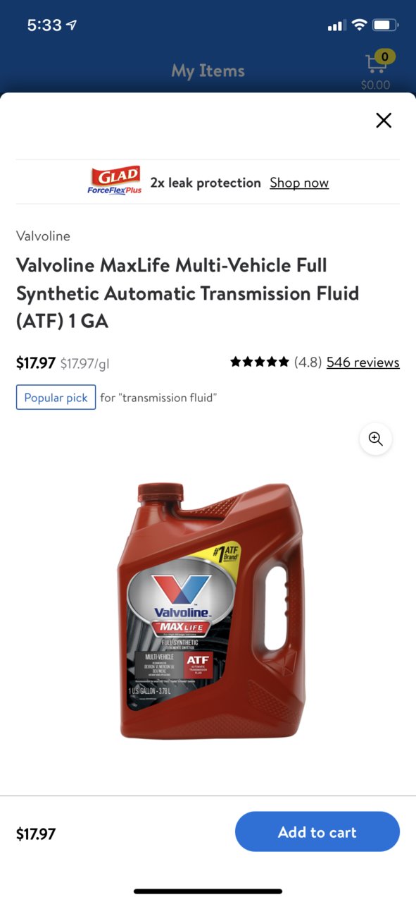

    Thanks. Looks like it doesn’t have a certain number like motor oil does like 5w30 or something.

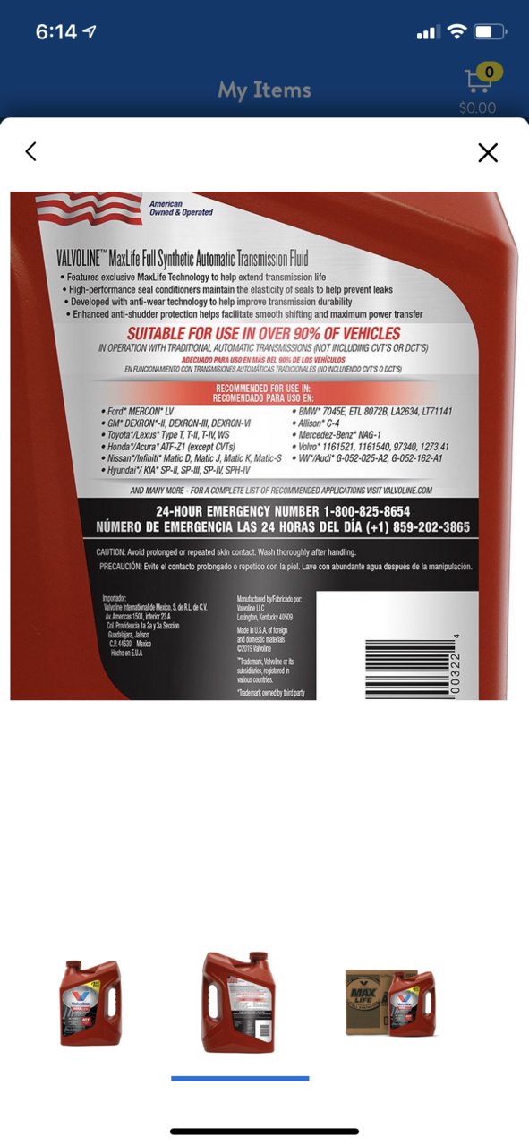

    You can look it up on Walmart.com. Here’s the back of it where it lists the info

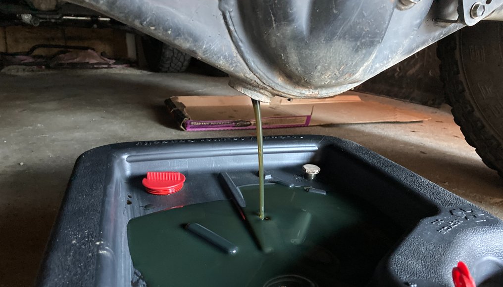

    I've always left the oil in there for those things as well, and so wasn't worried.
    This time, I removed the oil (so it'll just be fumes) since I'm going to be drilling and don't want it leaking out the holes (and crack) as I weld. Plus, Ryan had a good suggestion of thoroughly torching (propane) the crack area prior to welding to burn out as much oil as possible.
    But yeah, there isn't going to be much air in the housing anyway - esp with the axles still in there - so even if there was an issue, it wouldn't last long.

    ATF type IV is what mine asks for so I'd double check

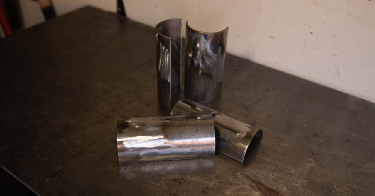

    how much would you charge if you ever made these to sell? It looks hella time consuming.
