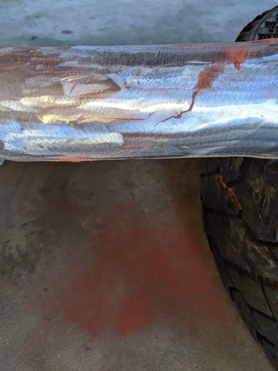

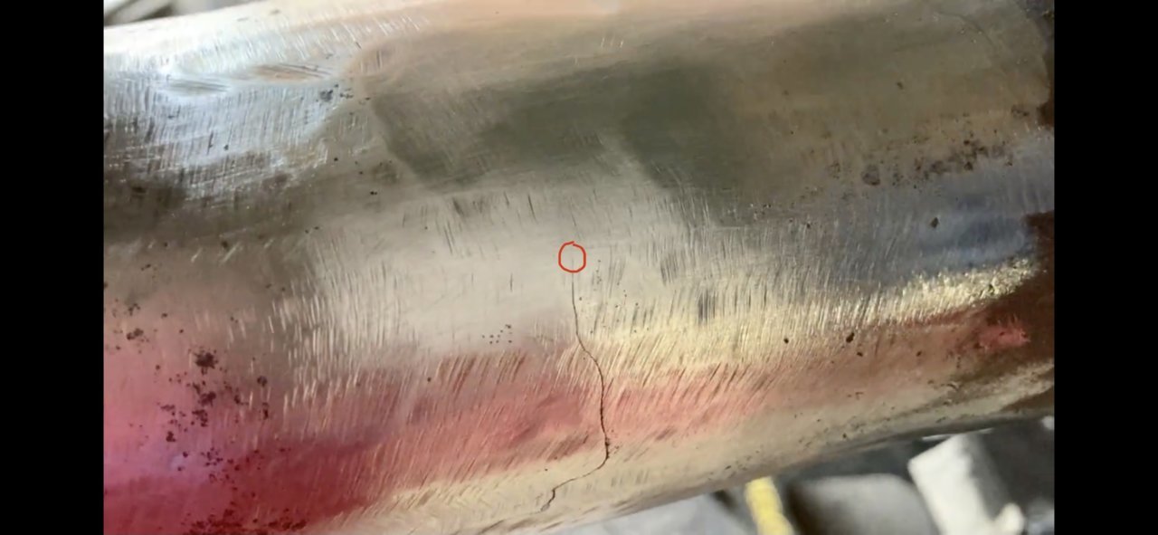

    Started work on the rear axle housing. Everything going reasonably as expected so far I'd say, but I only had a couple hours to work on it, so only got through the destruction part today.
    Cracking looks extensive to me - or at least more than I expected. I don't think it's all cracked through yet - only the largest (one side of the spring perch) has started to make its way through - but it appears that there is also a crack along the front of the perch (to me).

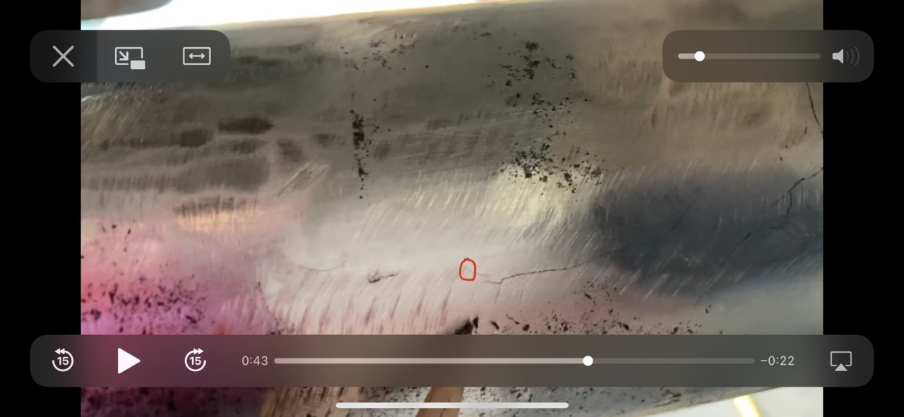

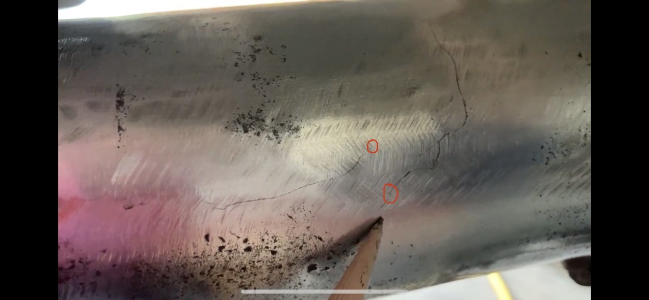

    So, I could use some help/second opinions on the drilling. I tried to use a pencil to show where I think the ends of the cracks are (hard for me to see).
    1. I think there are 2 cracks. One "vertical" and one "horizontal."
    2. These look like the right places to drill to others? The more detail you can give to show me where you think the extent of the cracks are, the better. Feel free to screenshot and mark up with your favorite paint app.
    3. There is a 3rd spot at the end of the video where I sort of point at an area with the pencil. As I look at it on the video, I don't think this is a crack. Agree?
    4. Lastly, does the "waviness" of the cracks give anyone pause? I wasn't expecting that. Esp. you Ryan @Reh5108 and Brett @Squeaky Penguin.
    And thank you for your time. Very much.

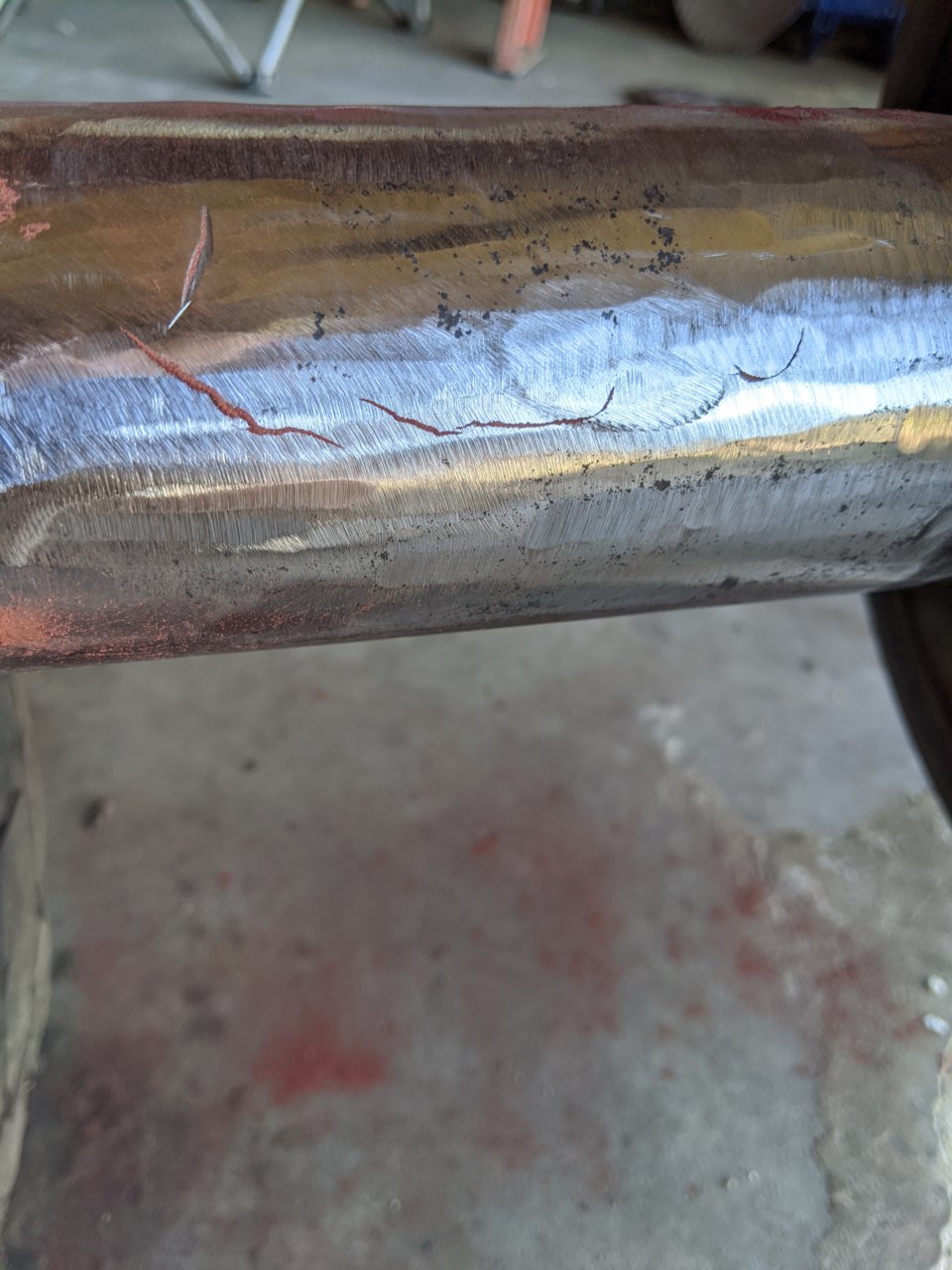

    I never investigated the extent of the cracks on my old housing before it went to the scrap bin, but there were definitely cracks running along the front of the perch as well. What you really need is Ryan's magic powder that makes cracks more obvious.

    I see four spots to drill. Sorry about the tiny red circles, hopefully you can see them.
    This looks like pretty classic stress fatigue, you’re getting tearing around the perch which is a stress riser where it’s attached to the axle tube. I was originally going to say that you could probably weld it and live with it for a while, but after seeing this I think it’s a good idea that you’re getting a new housing.
    That other area to the left, hard to tell. You could grind it down a little more and see if anything appears.
    Are you going to groove the cracks before welding?

    Mag particle would be ideal, but some dye penetrant is a lot cheaper and more readily available to further inspect cracks

    Thanks very much. Same four spots and questionable spot that I saw. Makes me feel better.
    I'm definitely planning to groove the cracks a bit after I drill. Wish I had a die grinder for that, but the angle grinder will have to do. Or maybe a square file for a bit more control.
    And then I'm going to hope that my fix gets me 2 months of trips. :fingerscrossed:
    I considered some food coloring. I'll have to look into dye penetrant, never heard of that. :thumbsup:

    Like @DashMaple said dye penetrant would be good here. Usually airgas or other welding supply shops have some.
    The way the housing is cracked, I'm guessing it's compromised passed the extent welding will help. But if you partially grind out and drill the cracks followed with a cover/patch plate it could hold.

    I would say those are all cracks. It looks pretty similar to mine. I did not find any additional indications of cracks after doing a dry mag inspection that I couldn't see with the naked eye. IMG_20200713_184210.jpg IMG_20200713_184032.jpg
