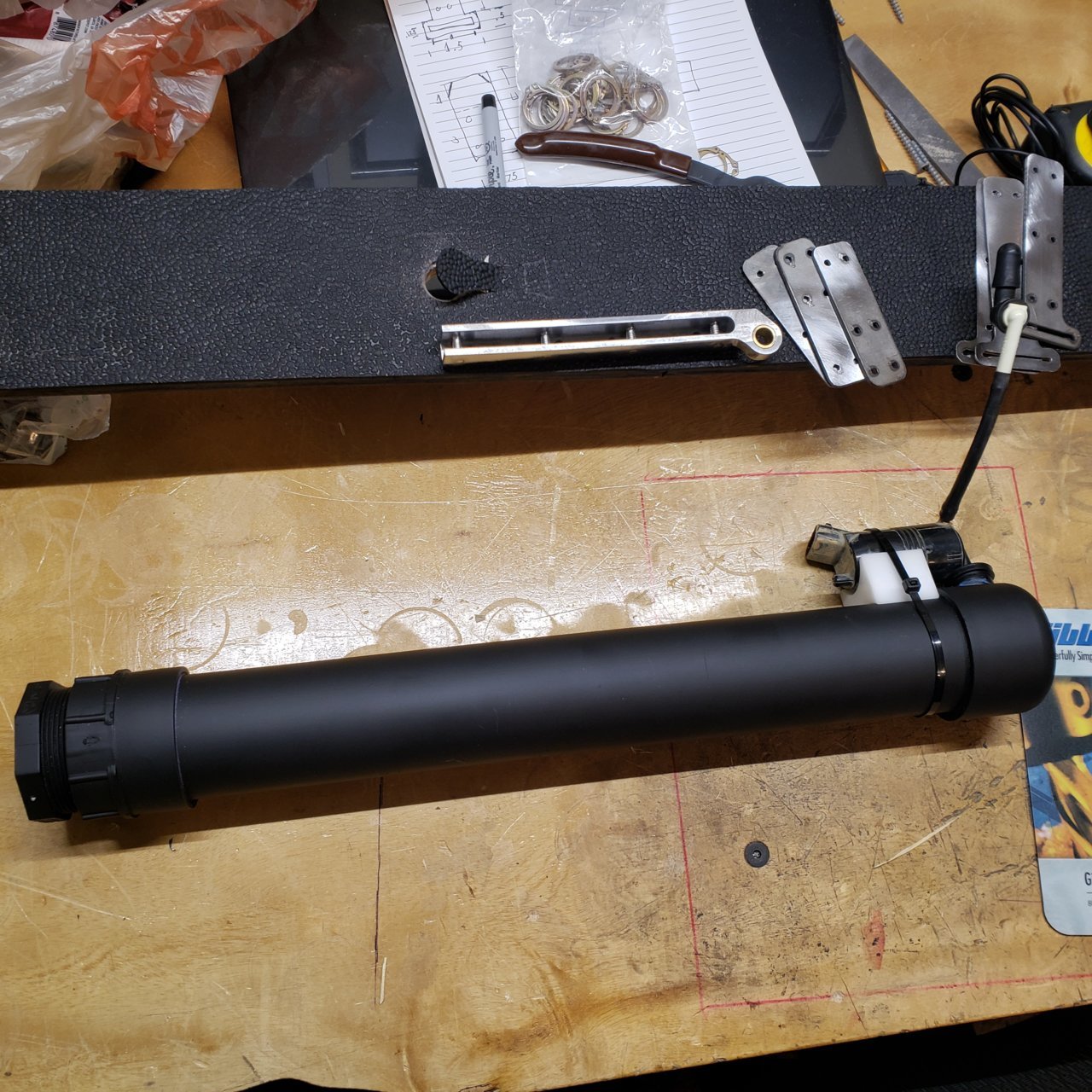

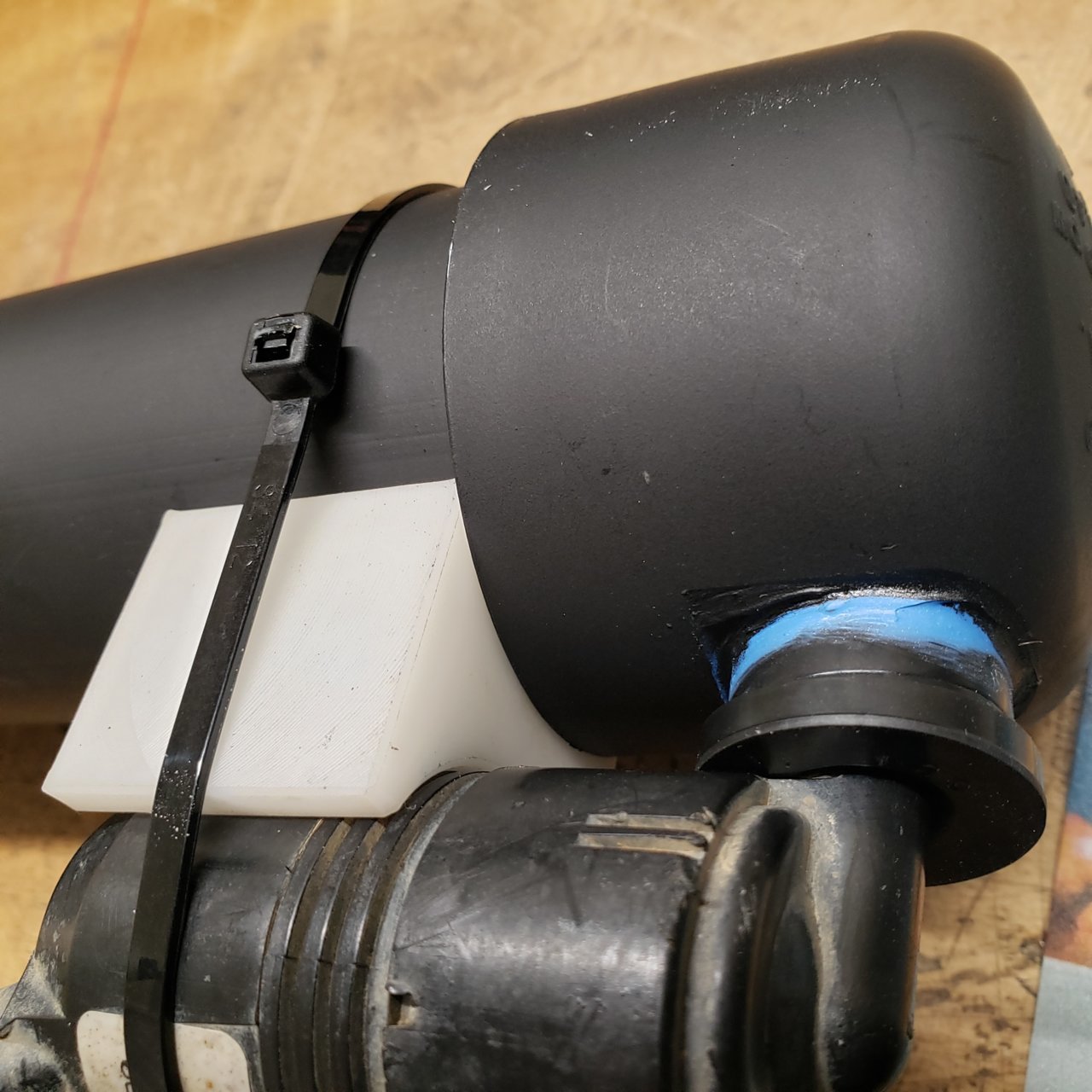

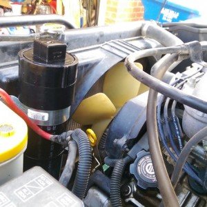

    I don't have any good pics of it mounted, it's just zip ties.

    just do the pre taco swap. Works awesome.
    otherwise: https://www.tacomaworld.com/threads...trail-rig-and-bs.159436/page-398#post-8802626
    Id recommend using hose clamps instead of zip ties for holding it around the frame. Zip ties are fine everywhere else.

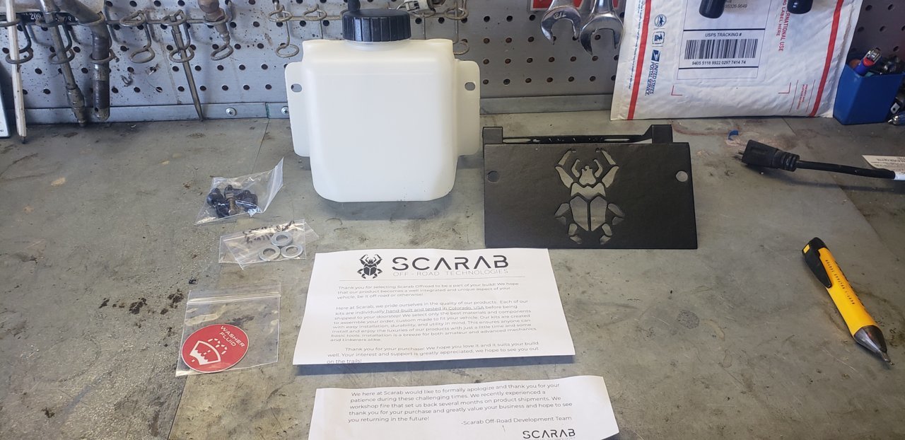

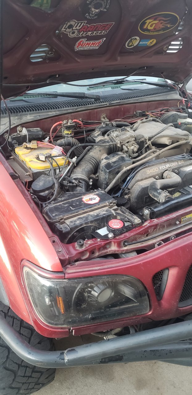

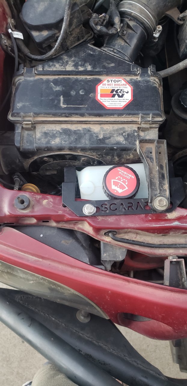

    Thanks. Can't do the pre-taco since I have both ABS and CC. My engine bay is super crowded. Evap stuff on the other side too. Easier access than you I suppose for that, but still, I'd love more space. Thx for the link, yours was the one I remembered, but couldn't find it in Igor's build.
    And here's why I had to remove the reservoir. It was for *another* reservoir, hahahaha. So nice to get them off the top of the frame rails. Was a pain to get them positioned and clamped in up there. (obviously on the other side)
    Even better. Thanks dude!

    ahh nice. Moved the resi's. I don't think they are too bad to remove now anyways. Also...i didn't have to remove my washer tank for the my resi's...
    Wow yeah you don't have shit for room for that hahaha
    Seen people do what Ben Did with the Nalgen with just PVC too.

    Yeah, I had to remove my washer fluid bottle too. I went the Nalgene bottle route as well.
    turbodb likes this.

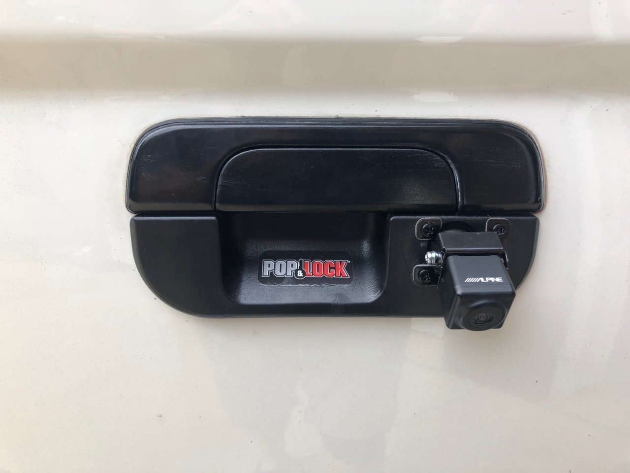

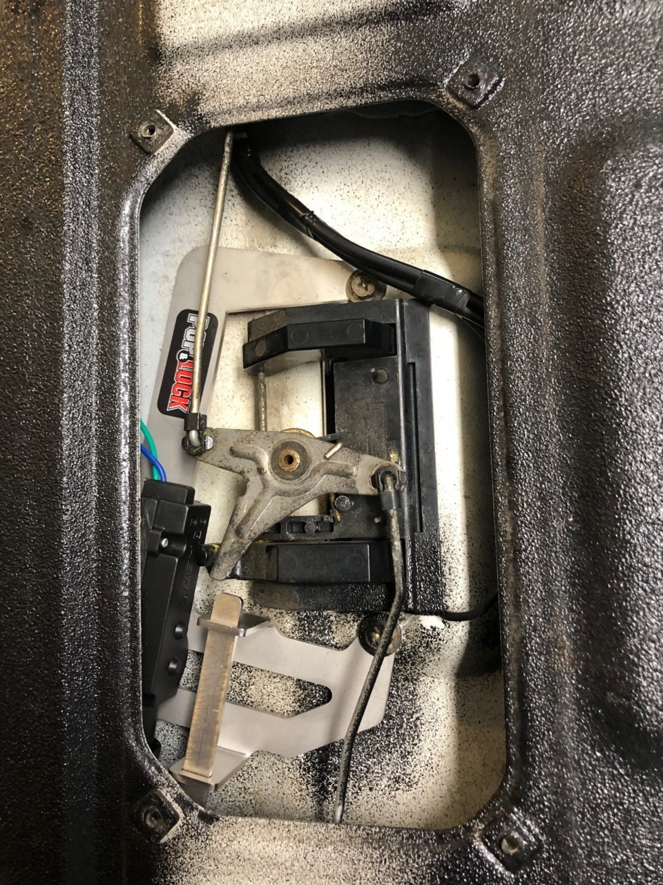

    OK, it's been a few days ago but I moved my Alpine camera from the license plate up to the tailgate latch and installed a new Pop & Lock power lock:
    Paseo and SwampYota like this.

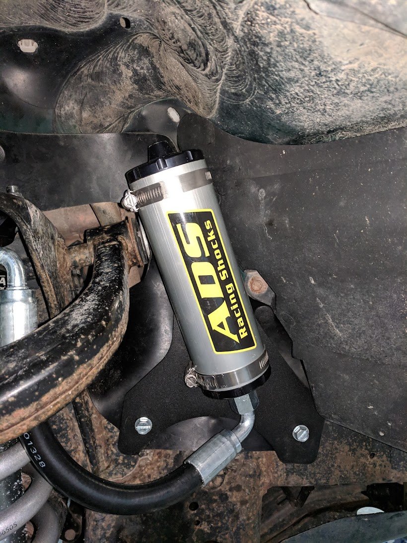

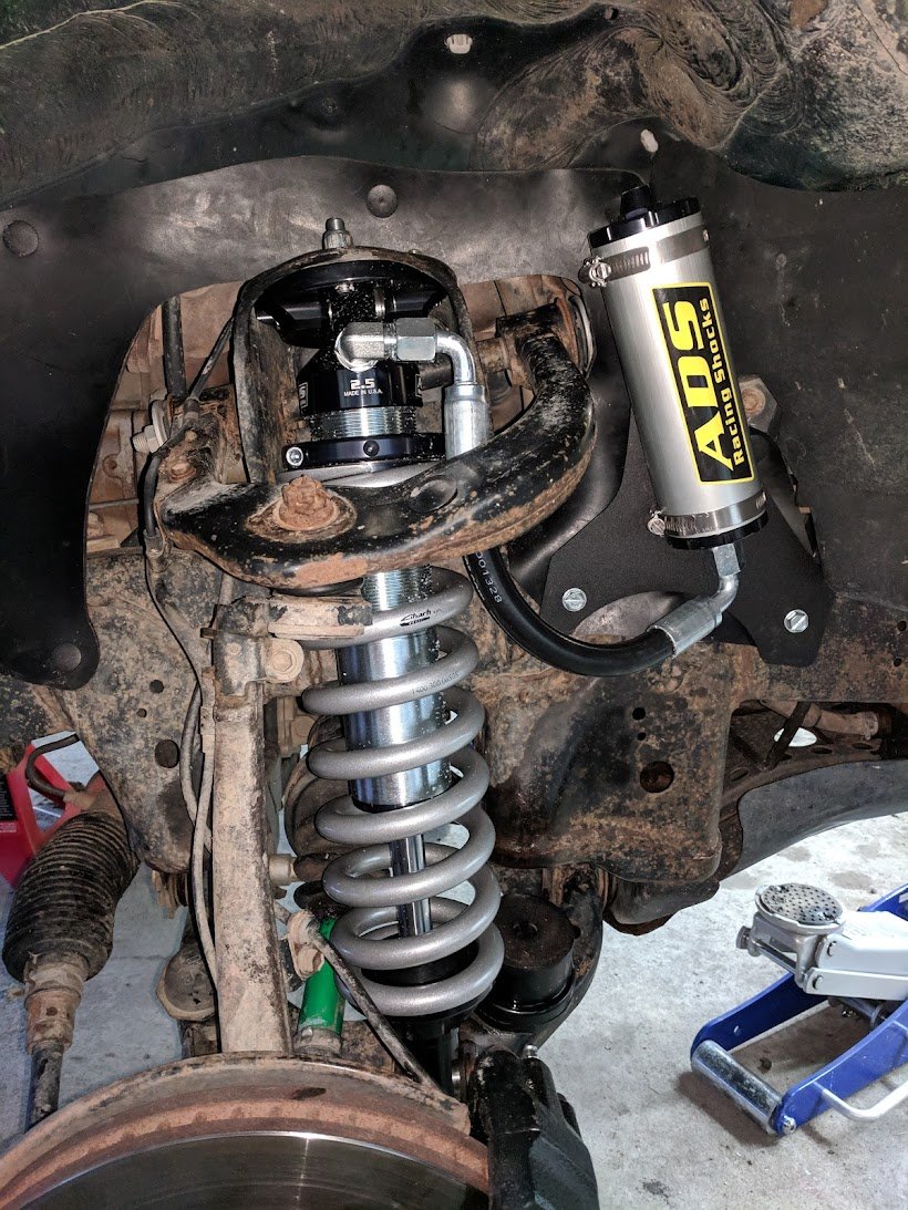

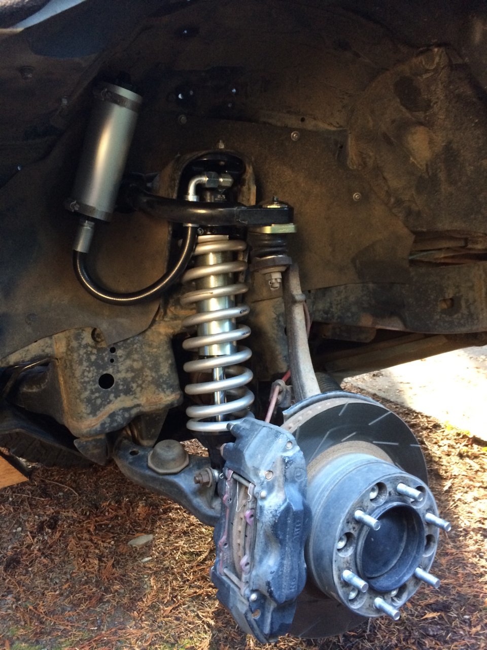

    hopefully you can see these:
    0CyF4gtwaic4EZyCeguHOLDB0vFSRquenYUtbhQq_f4980ad86db70c7ca9691ad54d65b540b6faa2f0.jpg
    1Dwd9PJjBt3DClN5HzOvB9nWBMDd6nzGe6GBHJ3b_a818c43a66e91f2818ca96fcdd597c12958fd549.jpg
    turbodb[QUOTED] and SwampYota like this.

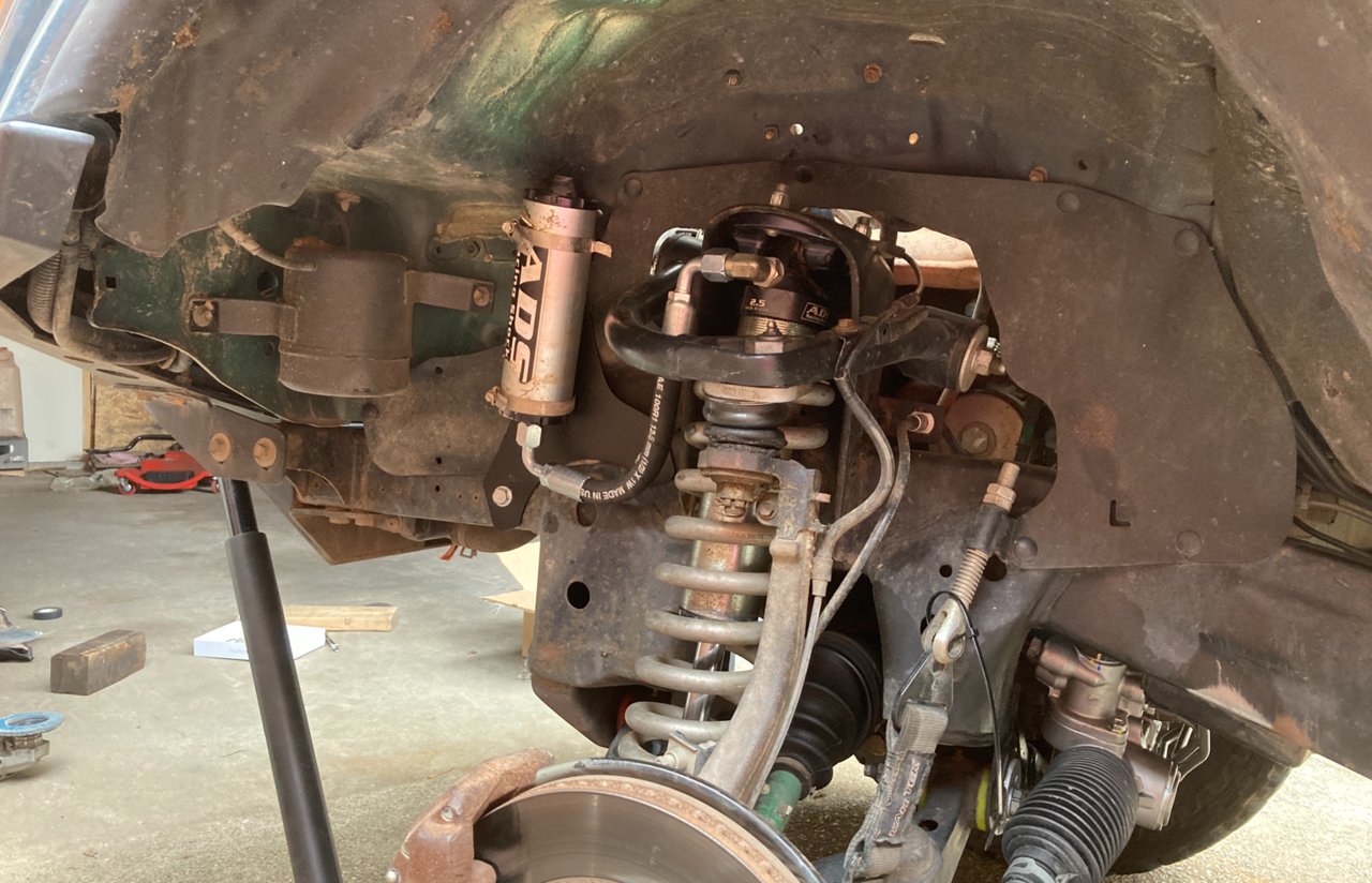

    Not that exact hose configuration, and not the MGM resi brackets, but my resi’s are in approximately the same spot with the stock hoses. Plenty of clearance with 35’s with 2.5” total backspace.

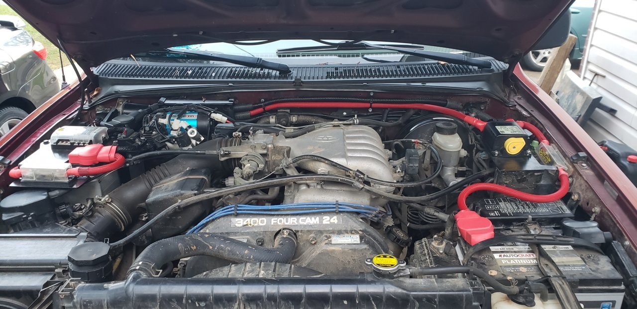

    Smoked them boys :rofl: what are you running under the hood?

    Interesting. I got custom hoses to mount mine differently for my setup and I still rub them a tiny smidge. I'd say the hoses could be about a half inch shorter and it would be mint. Of course then I'd need to re weld my mounts again so for now they are just fine as is. My total BS is about 3.25".
