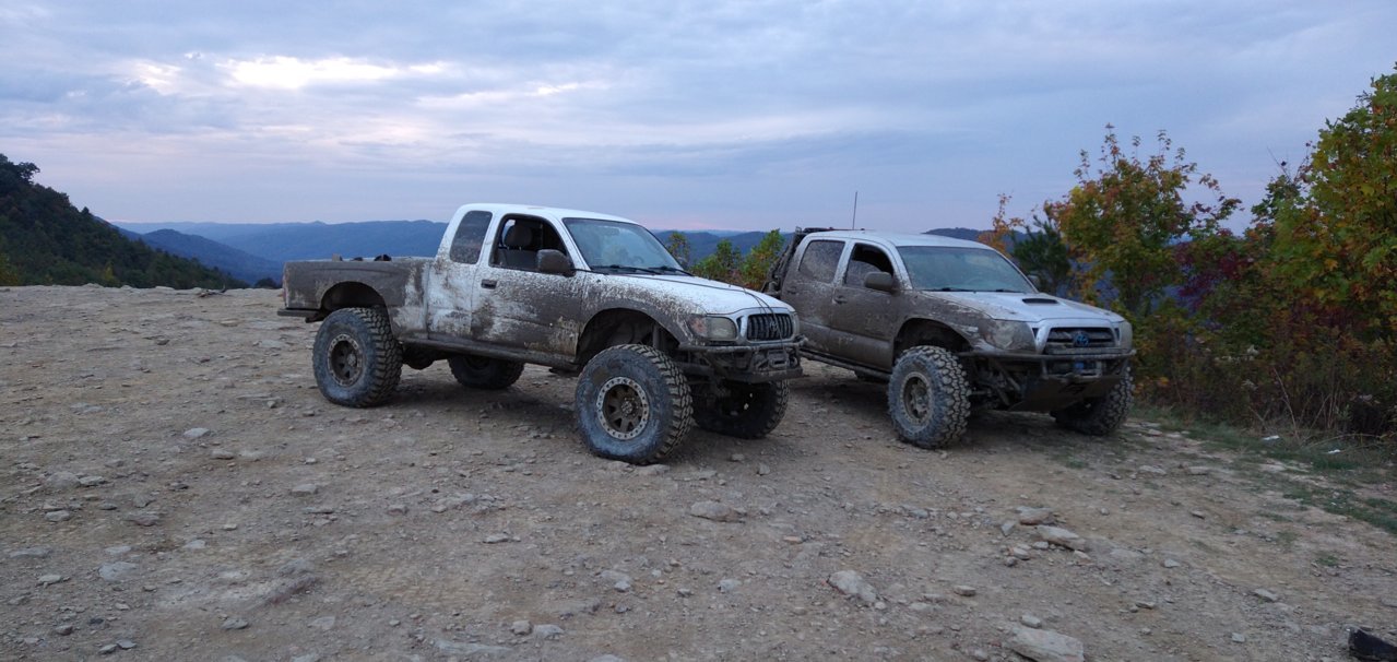

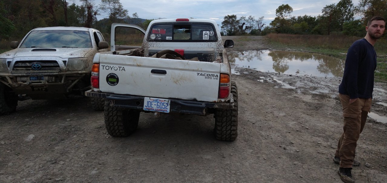

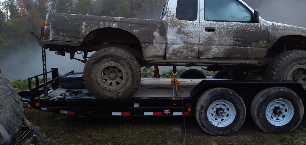

    Did this over the weekend:
    Bent my frame winching out of an obstacle
    Straightened it on a trailer and then drove it home 4hrs
    It has tighter body lines now than before the trip LOL

    Make sure you chain it down, a strap just stretches.

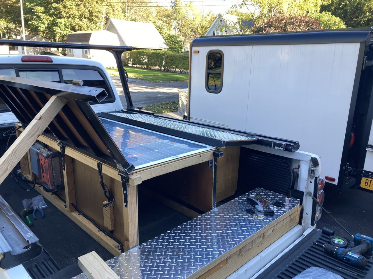

    Added this solar panel (only one that worked of 4 even though it’s the only one that had visible signs of damage) to a compartment cover that I have plastic snap buckles holding down so I could tilt if I wanted/needed to. The panel feeds a 20 amp DC-DC charger going to my THOW.
    This all lives under a tonneau.C5AF158D-D43E-465D-BA1A-78178AF9F780.jpg5C3675D8-0B28-417A-A863-314C462C1699.jpg

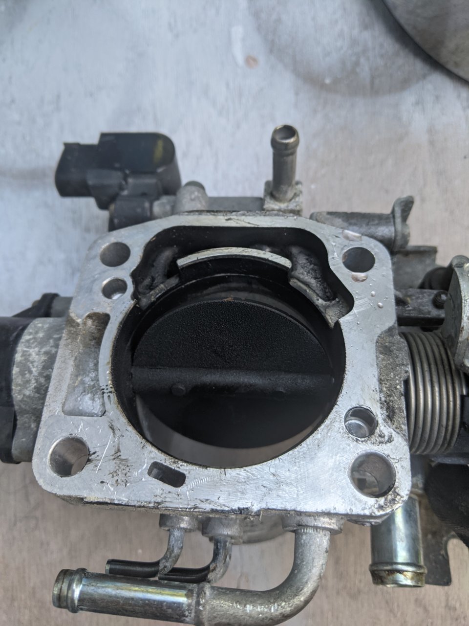

    Not today...was actually a week ago...but got around to replacing all the gear/front-rear diff fluids....then cleaned up the MAF and Throttle Body.
    Also swapped out the transmission mount...I'm trying to resolve for the vibration at idle...it's getting better! Next up is probably the engine mounts. PXL_20211002_123330522.jpg PXL_20211002_131808354.jpg
