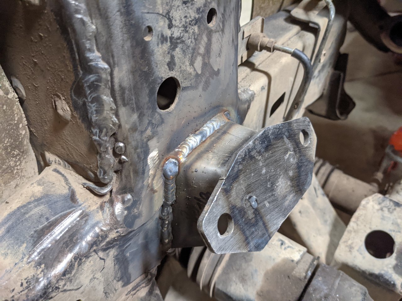

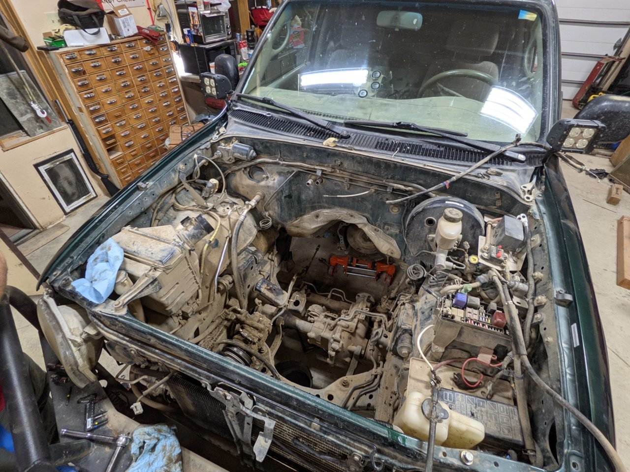

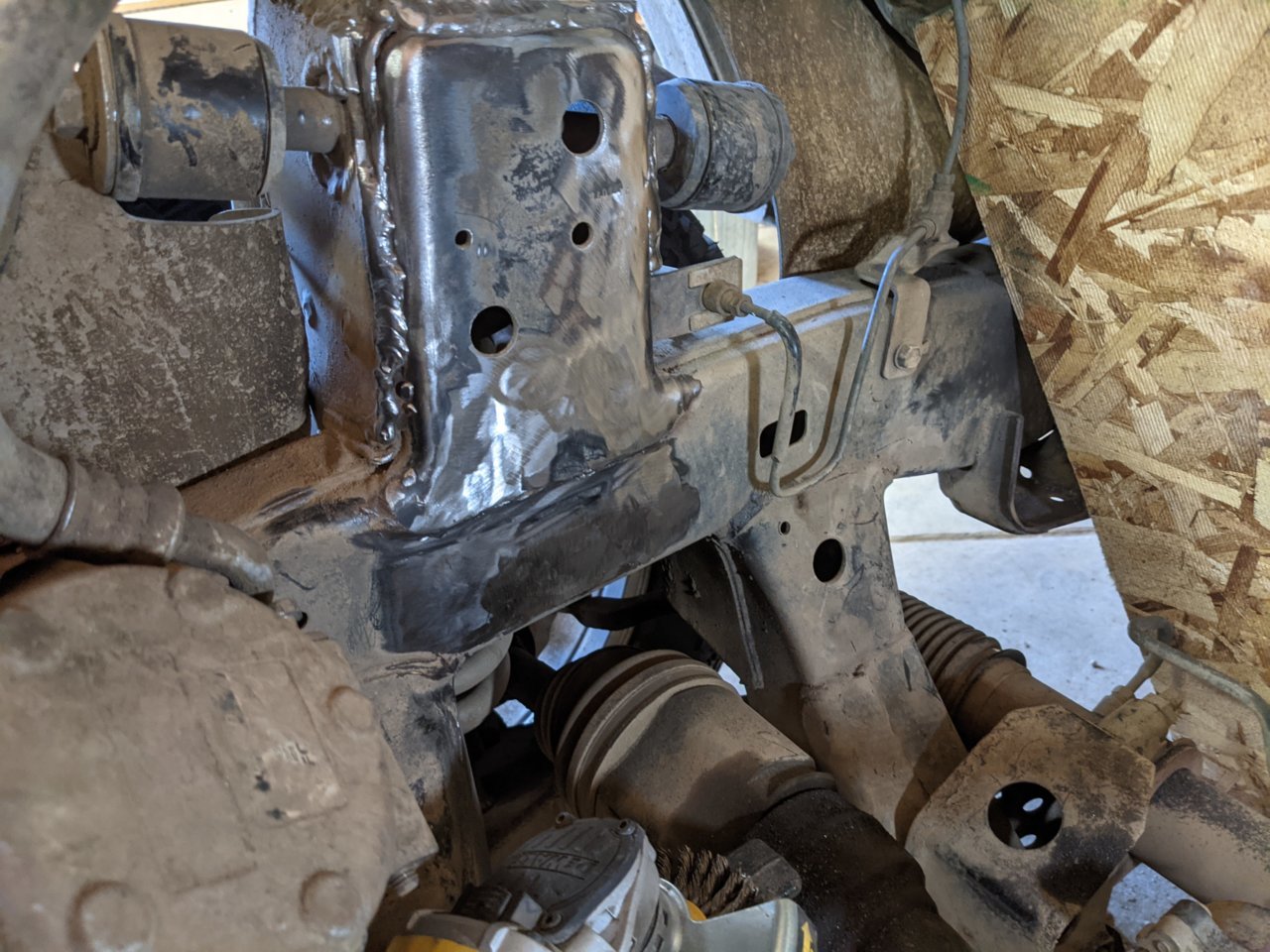

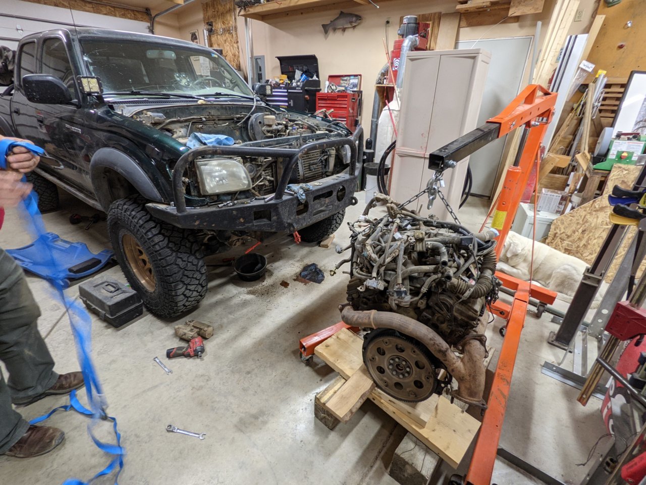

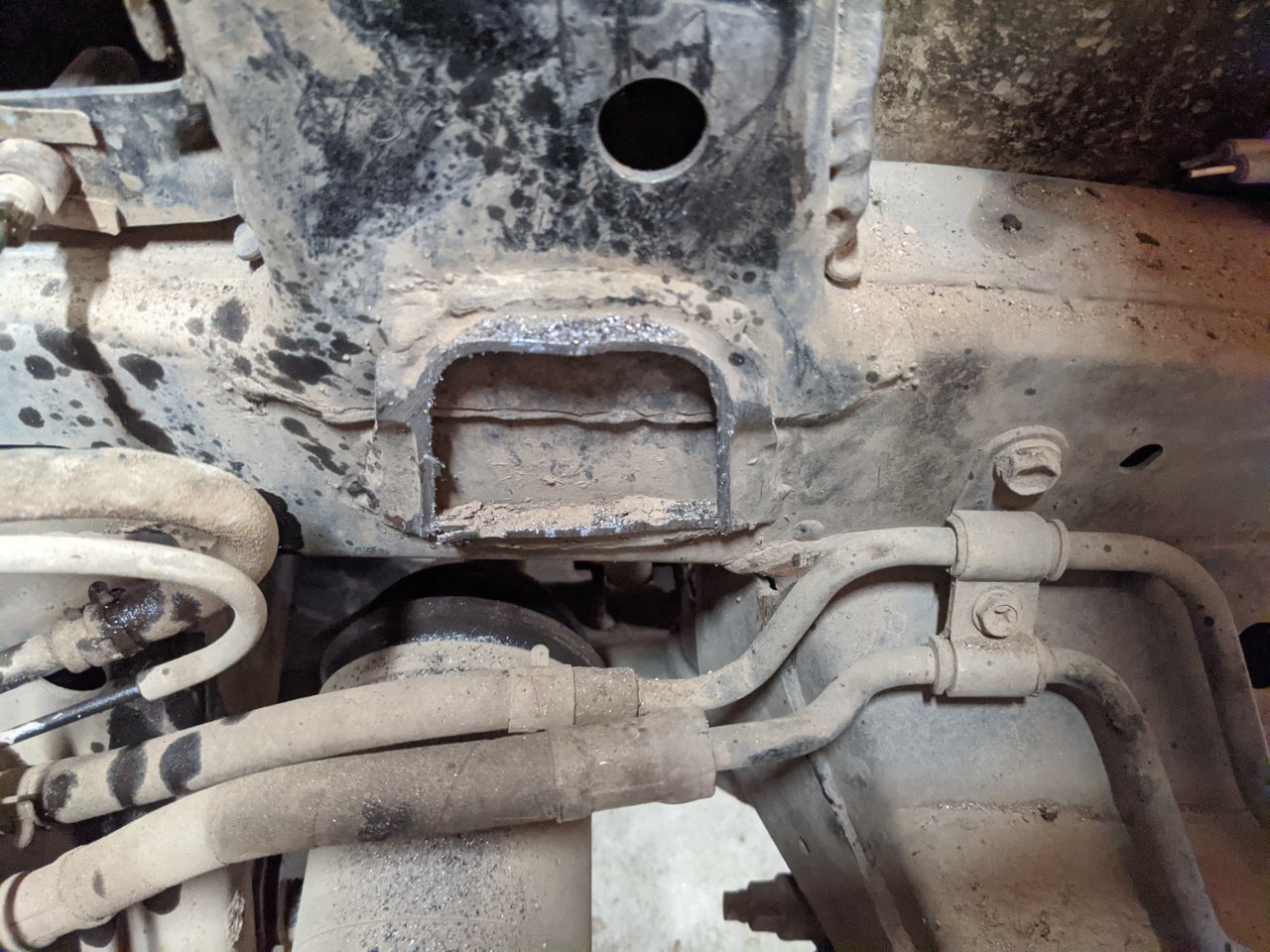

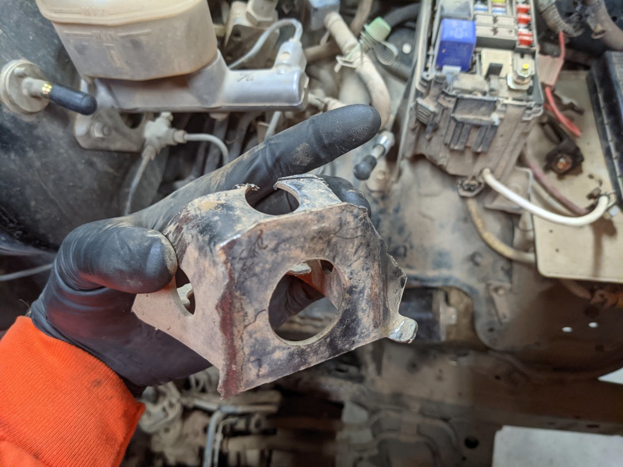

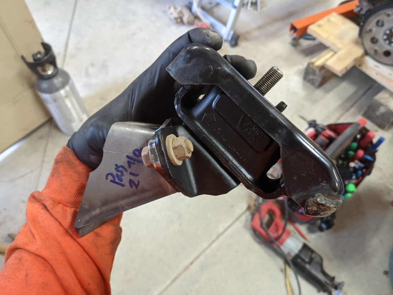

    Time consuming and a lot of little shit to get to the point you do the actual work.
    I did skip plating the back of the coil buckets. Didn't seem needed and wouldn't do a lot I think considering there is an internal brace on the back anyways.
    Now the long road of putting it back together.

    Did you break anything in the process of getting it all apart? Like one of the 8 billion trans wiring harness clips or diff breather studs? :anonymous:
    Getting it all back together will be so satisfying. Is that a project for next weekend?

    Only electrical issue is the ac plug wire needs replaced.
    Diff breather clips are not good ha
    Worst was I nicked the driver side brake line with the sawzall.
    Not likely next weekend. Following weekend.

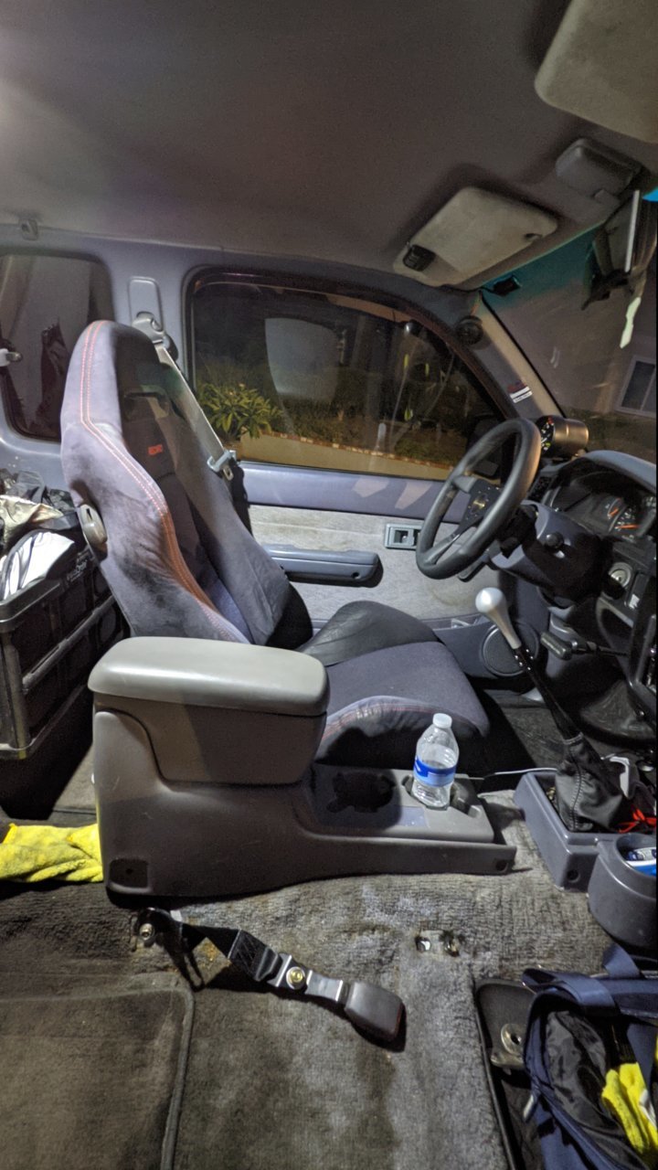

    Awesome. Looks like the center console fits with the recaros. Also, that console came off a 01-04 taco.

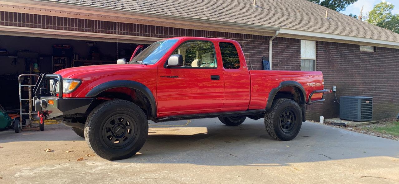

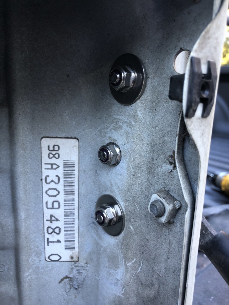

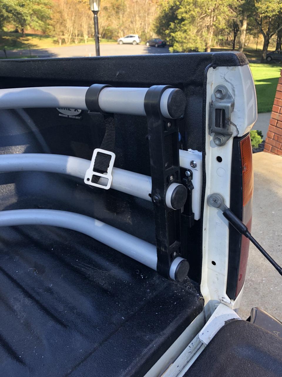

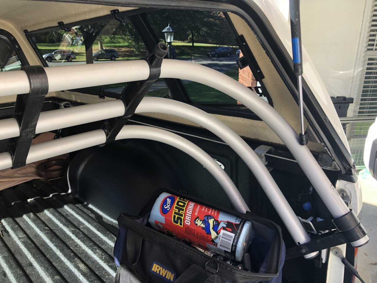

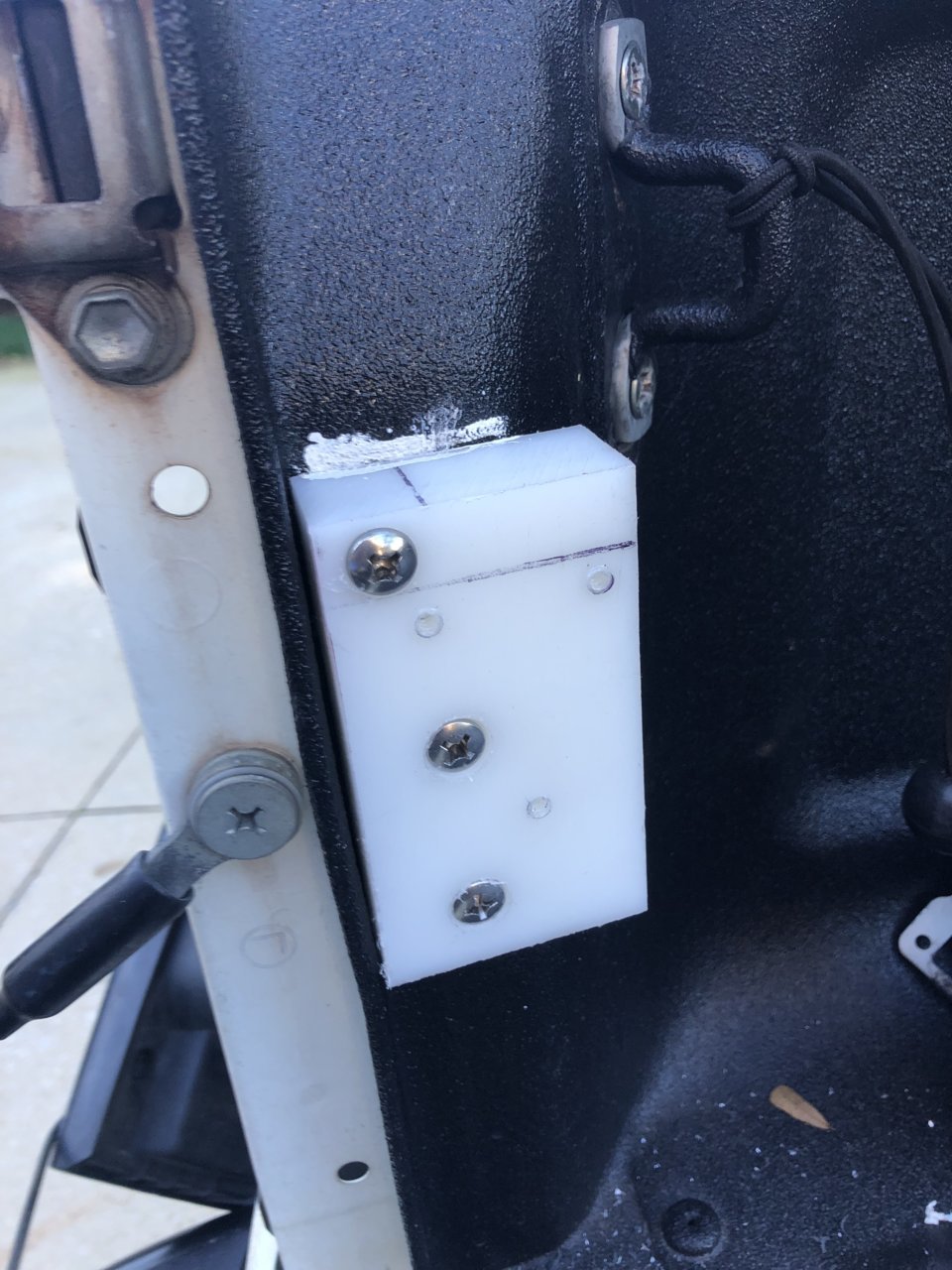

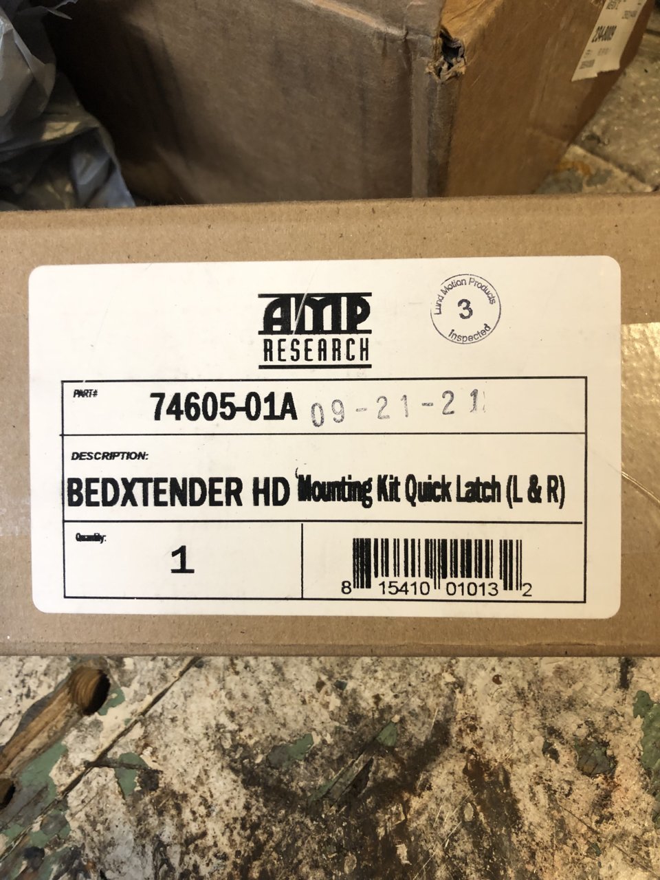

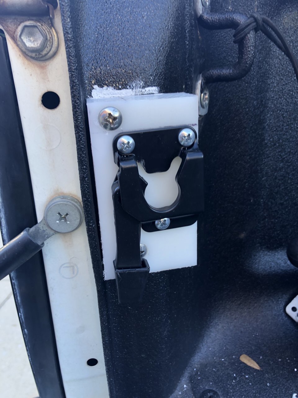

    My old bed extender brackets wouldn’t work once I installed the cap as the extender hits the cap door shock brackets. Ordered new brackets from AMP research that release the extender without having to rotate it 90 degrees first. Made a new mount bracket out of 1” thick UHMW block and bolted to the bed with SS hardware. I used what I had but black UHMW would blend in better:
    3FEE8EB4-363A-4638-A107-4434154D292D.jpg F69F1C2E-CA1B-4323-B837-A1CA32523B24.jpg 1A20F669-6BC3-4C44-B6FC-0EDD5BF95409.jpg E503F2A1-5212-4ED7-96C3-920F336ABA11.jpg 96094AE2-651D-40B8-AC53-85B6F0096680.jpg 5203FDB2-CDF7-4FA6-A3FE-EB7BE44DB937.jpg

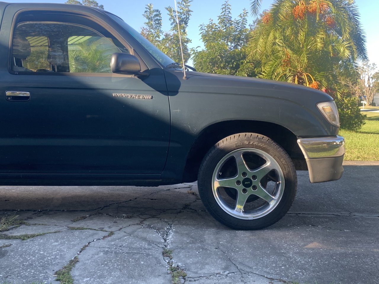

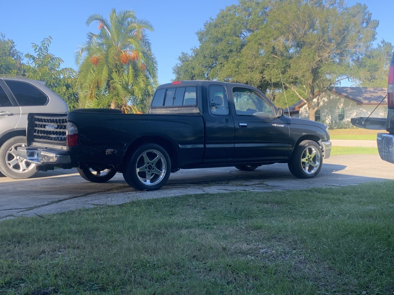

    Saw a deal on Facebook marketplace for some SVT cobra wheels with almost new tires. I figured why not.
