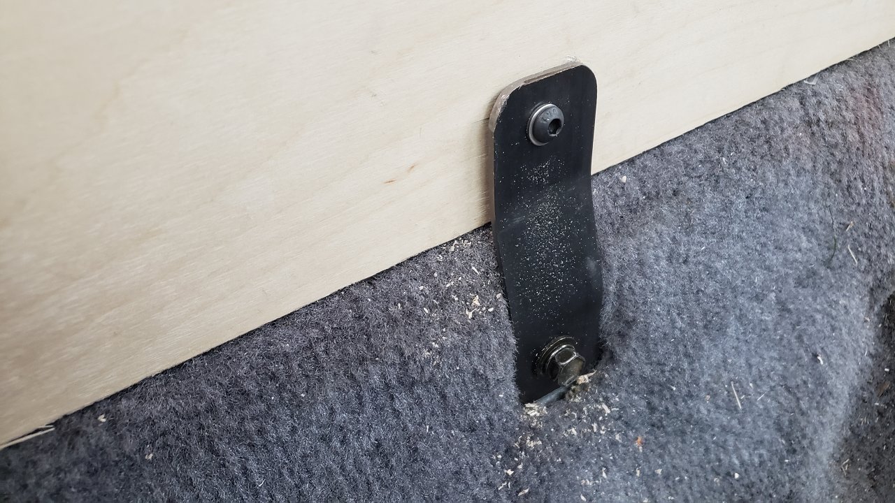

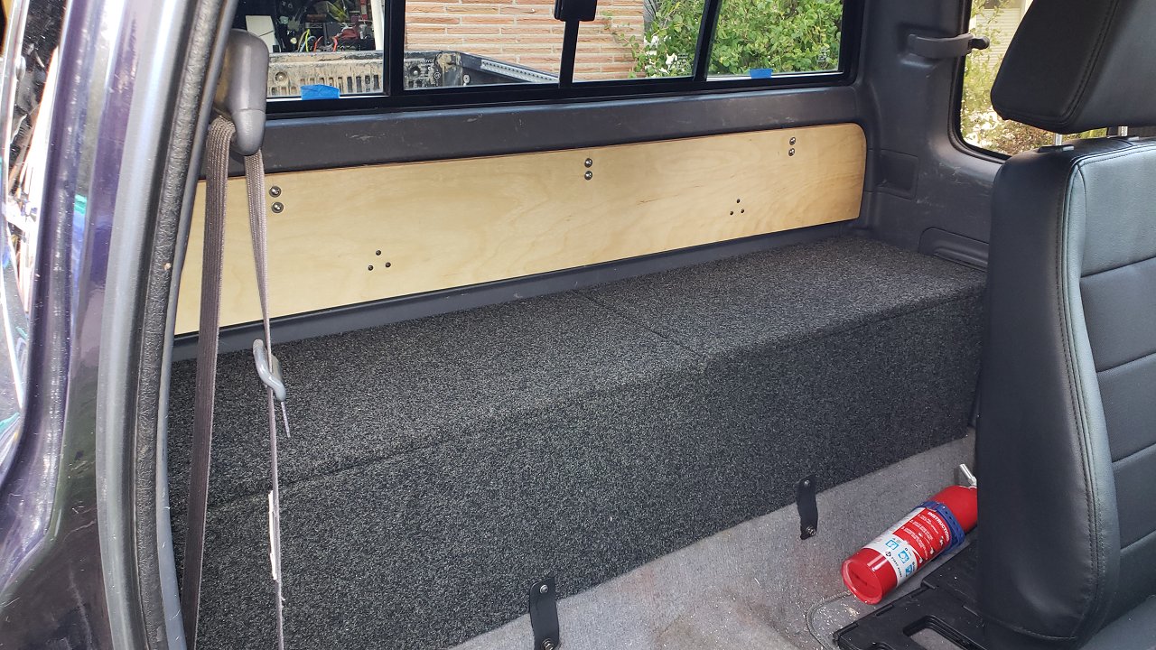

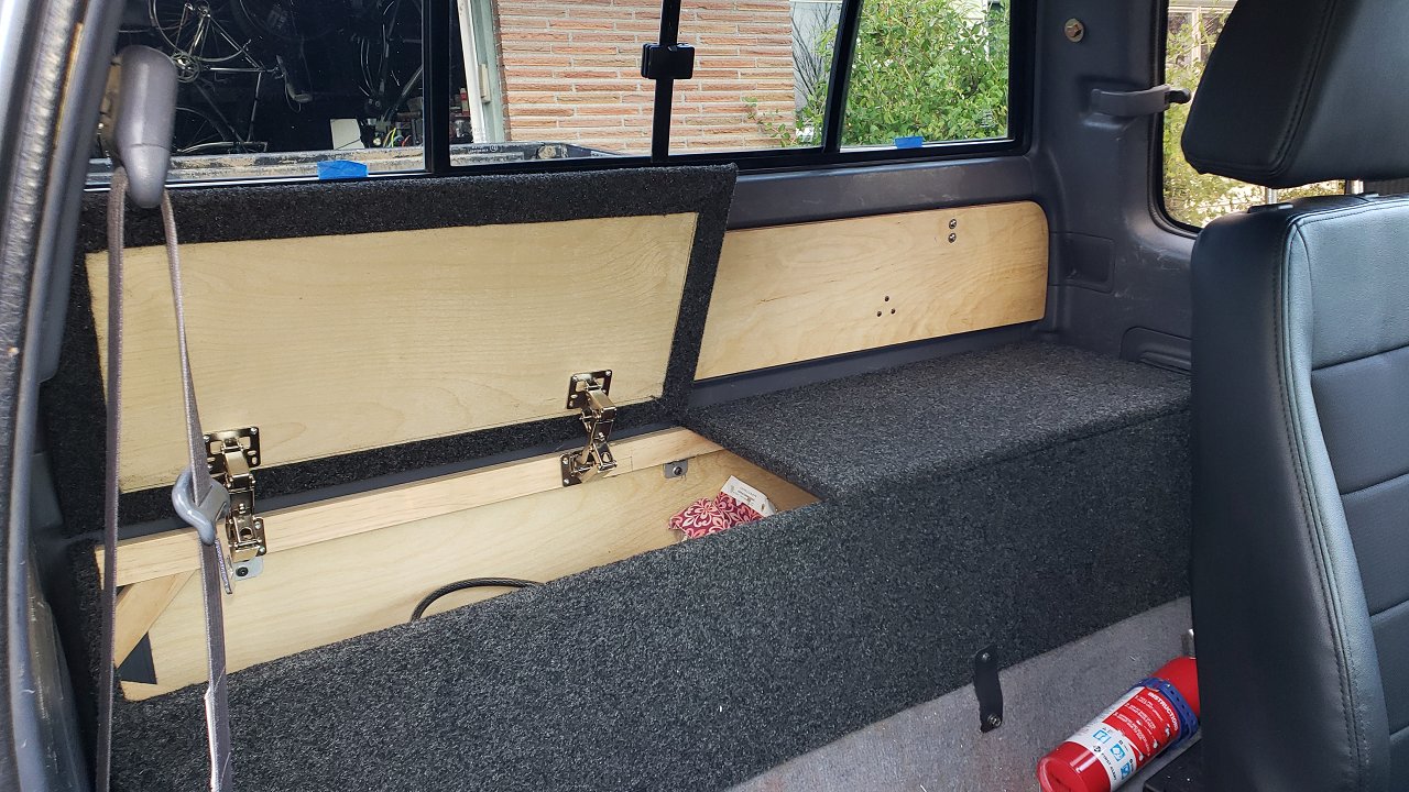

    Finally, finally after many mental pictures, then sketching up ideas, then cardboard templating, then some R&D and trial and error ... I finally have my extra cab storage! The upper back panel will have some sort of additional storage, still finalizing thoughts around that. I used 1/2" Birch plywood, some steel, some aluminum, and flush-mount, invisible hinges.

    Looks like you kept the "pockets" accesssible on each end? Looks nice and clean, lots of closed storage.

    Yes, both pockets are accessible. Thanks much!

    Any build pictures? Curious how you secured it to the floor. Thanks

    I cut the rear panel replacing that section with plywood, attached to the back wall using the seat belt fasteners. I trimmed the side panel edges so the plywood sits behind it.
    The main box is attached to that panel with "L" brackets at the rear stringer using M6 threaded inserts to make removal/install easier. The front of the main box is secured at the factory location for the drink tray - I located the driver side one and cut a small section of carpet. I cut and bent the steel brackets. I used M6 threaded inserts to attach the bracket to the box.

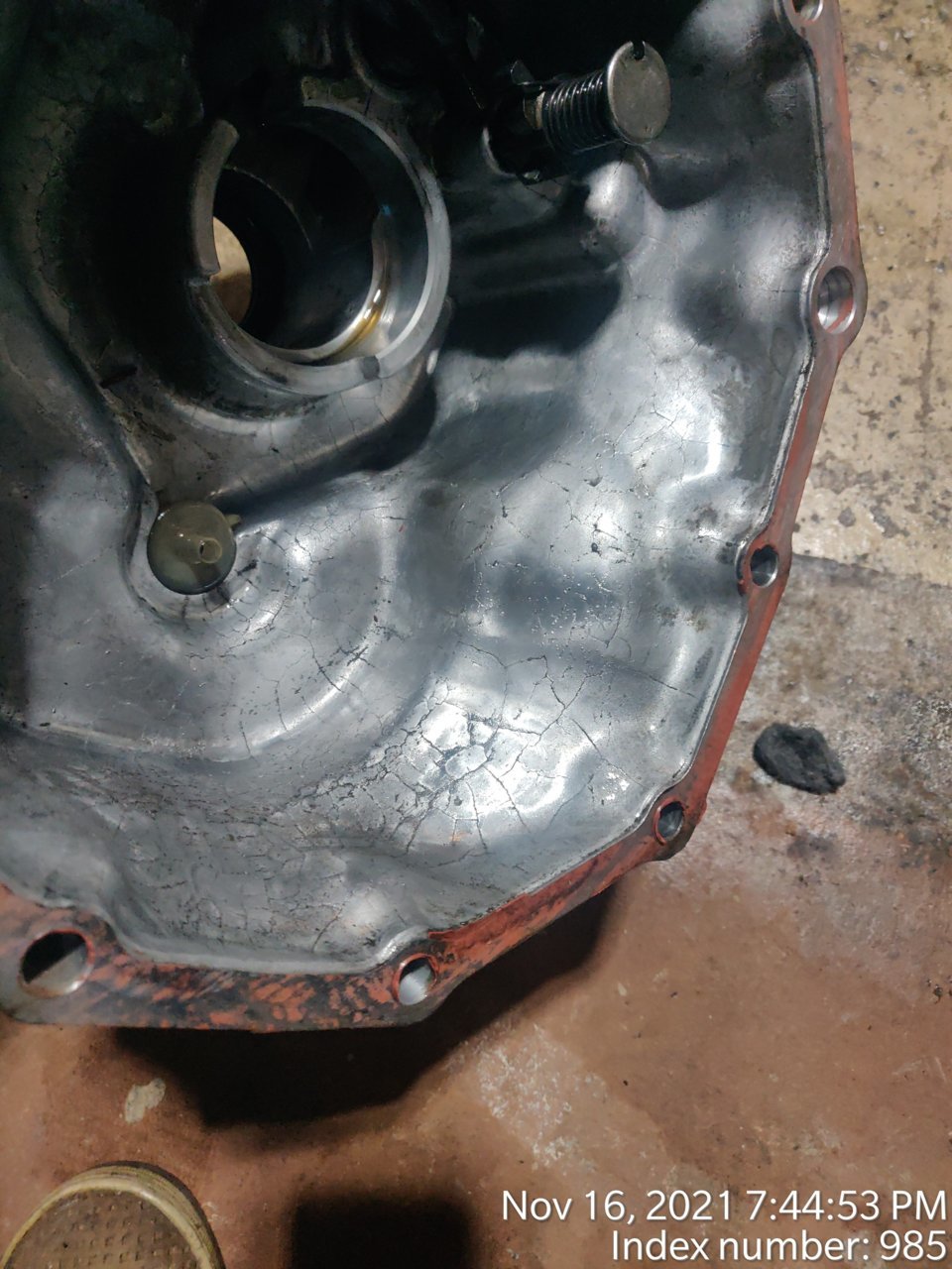

    Should I be concerned with superficial cracks throughout Transfer Adapter?

    Nah, that's from casting, they're surface level

    Thanks! Was going to start searching for used replacement parts:thumbsup:
