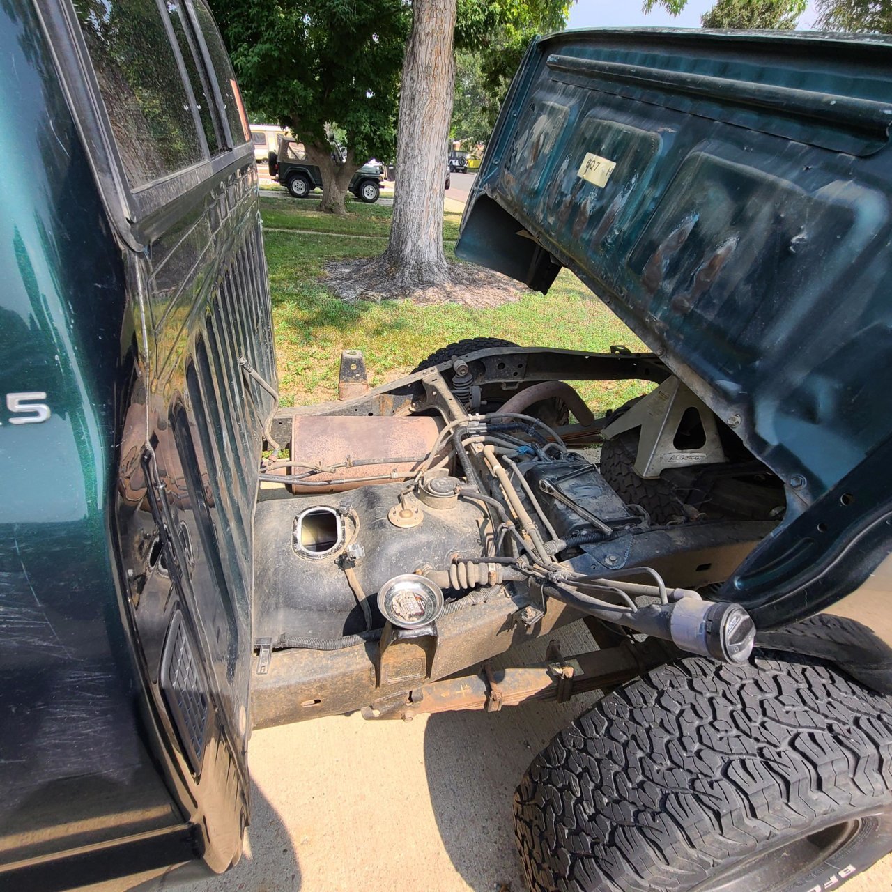

    The inside of the bed is almost unbearable. You can see the rear of the bed in this photo and how terrible it is. When I did the fuel pump I took a sledge hammer to the bed to get it off the back of the cab. The outside is pretty beat up too, but not as bad as the inside and the gap between the tailgate is substantial. I don't think a drop in bed-liner will fix my issue. Thanks though

    It absolutely does, 4 bolts to pull the bed off might be the easiest way to do it. It will get gummed up like a diff breather and will not allow gasses to vent and will make it a PITA to fill up.

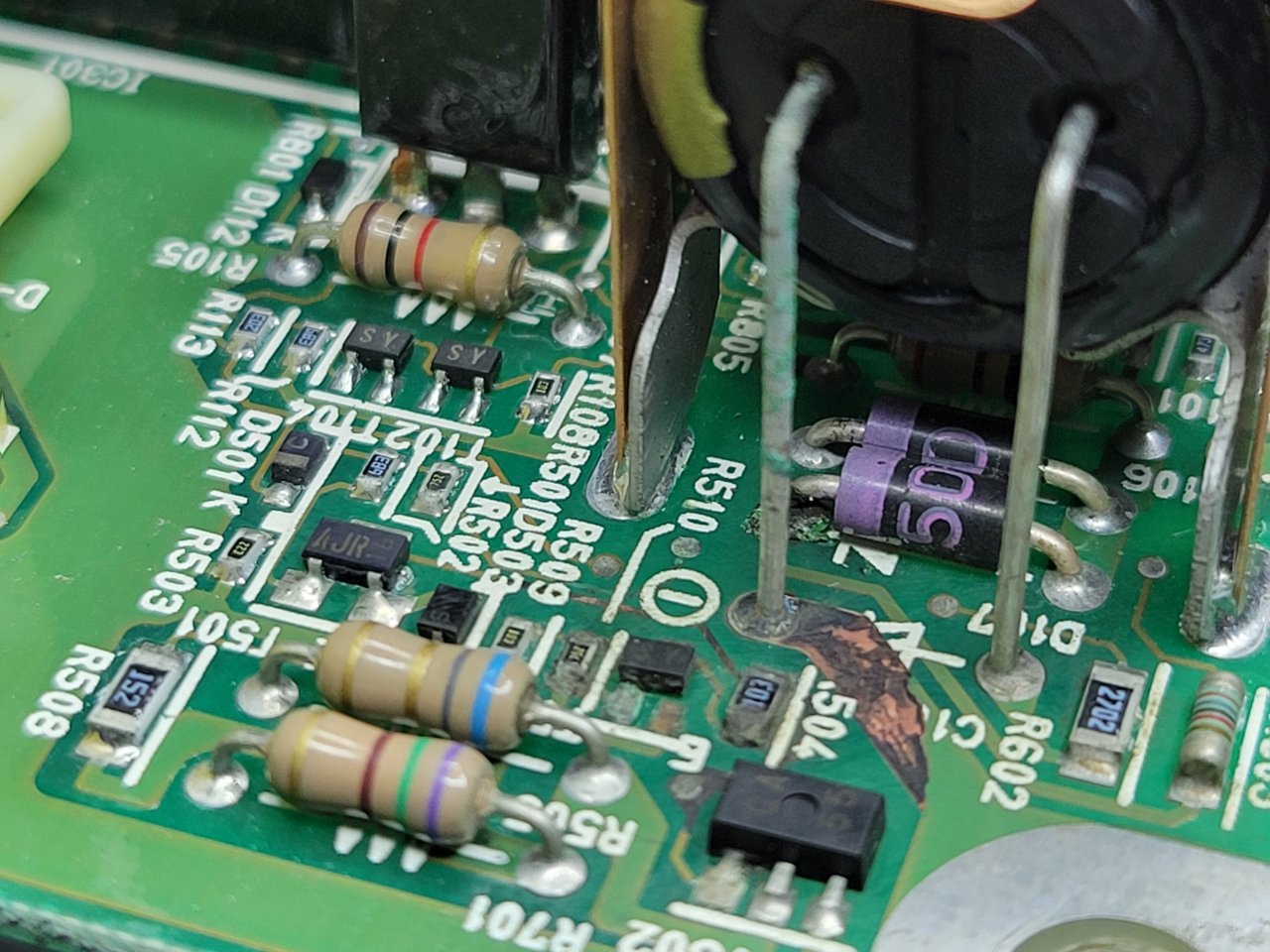

    Found out that my parasitic draw problem was connected to my intermittent airbag light. Opened up the control module to find the capacitor died and killed some other things too. 20211119_160831.jpgFound a used srs control module locally for $50 from a 97. After replacing the capacitors no more dead batteries and no more airbag light.
