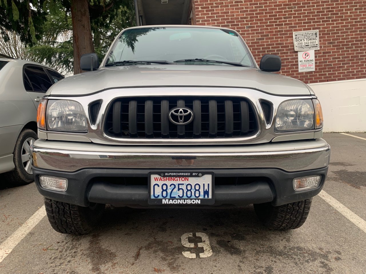

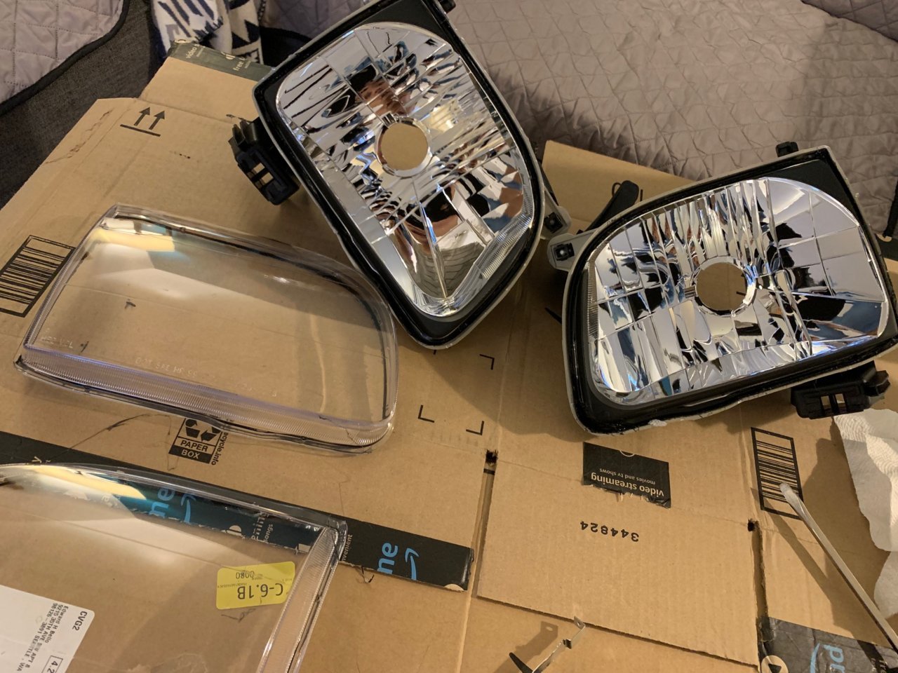

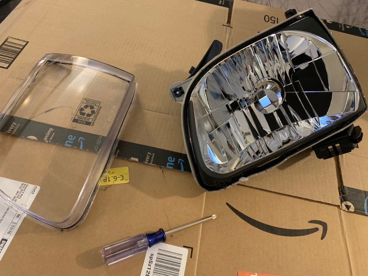

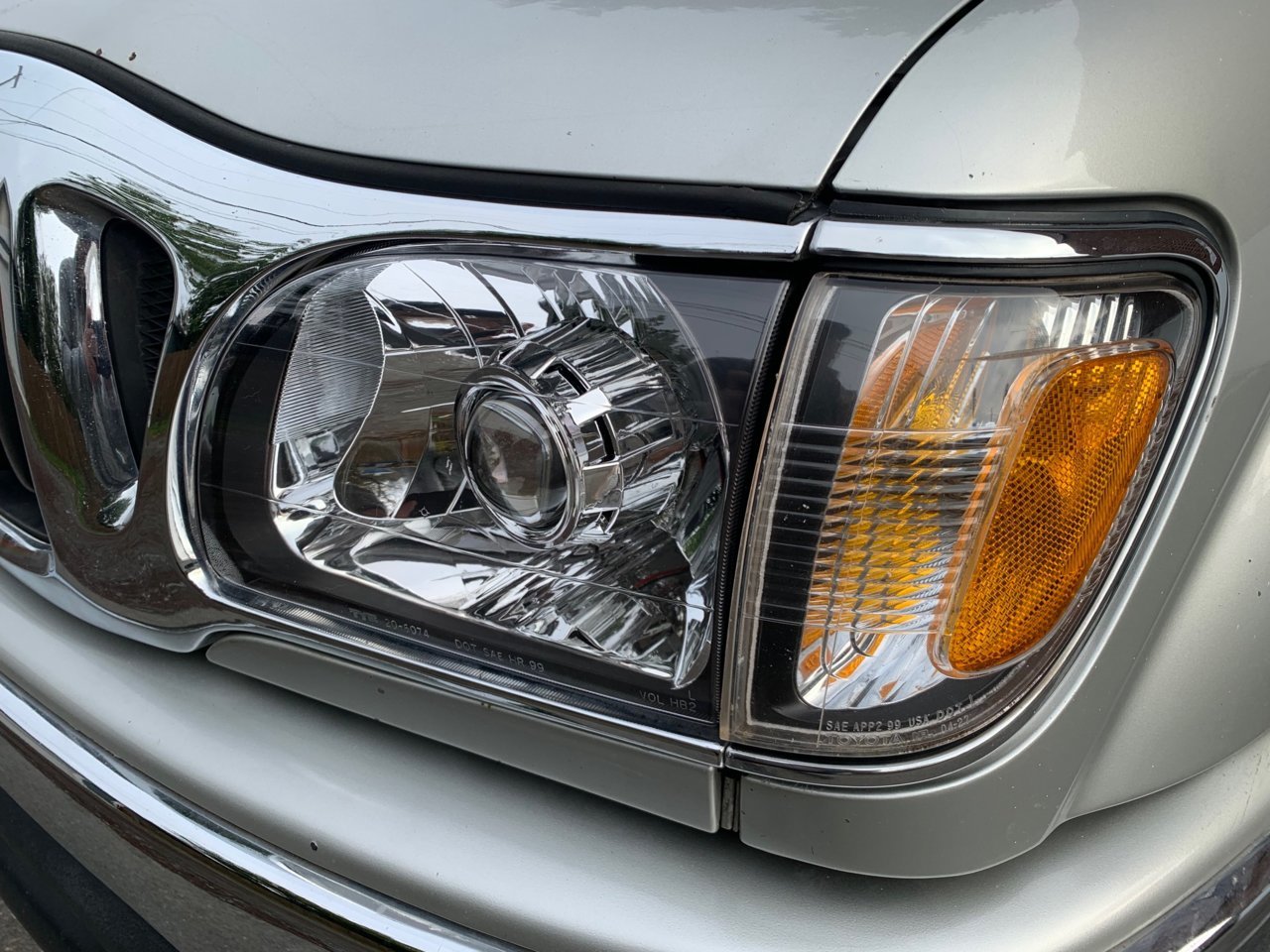

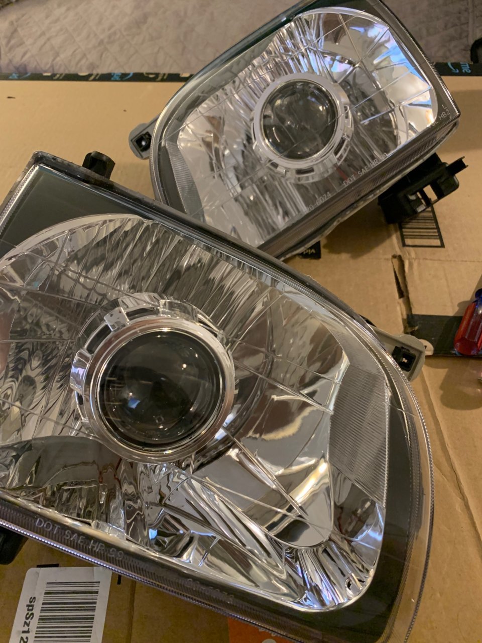

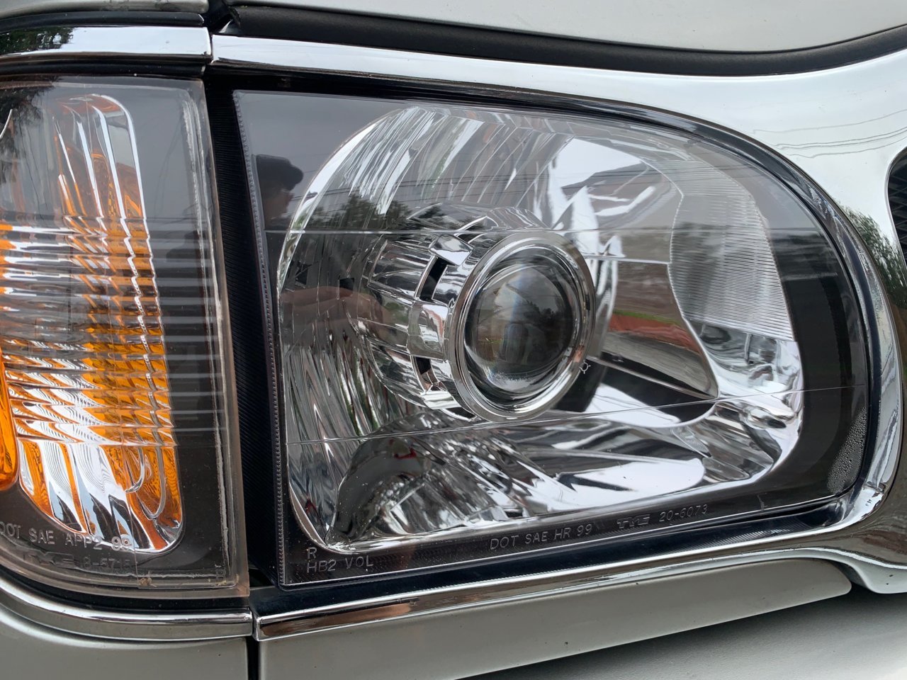

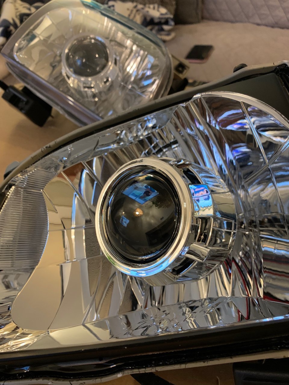

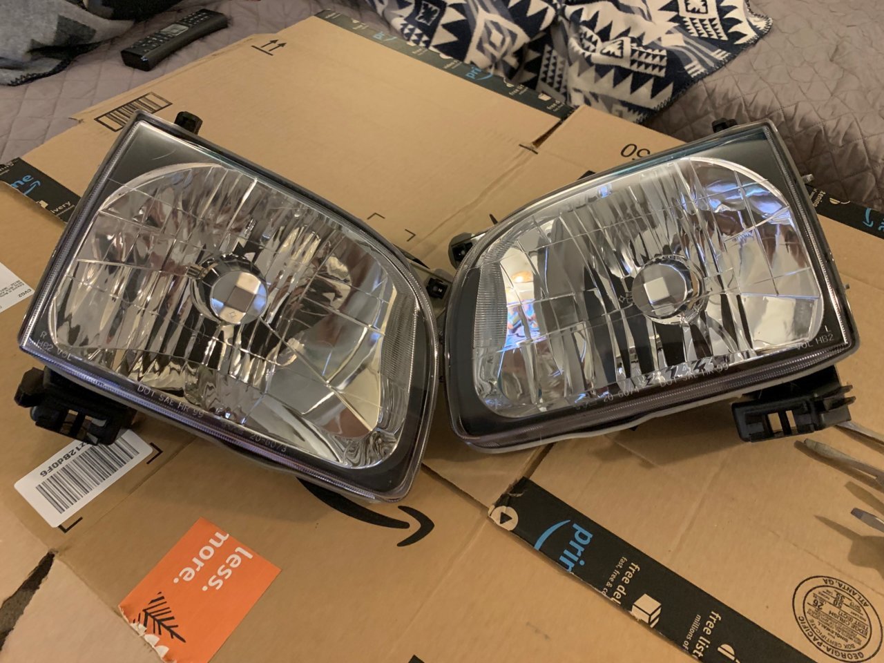

    I did a headlight retrofit myself. Quiet easy to do actually.
    I started with fresh TYC headlights from Amazon.
    Baked them at 270 degrees for 10 min each, removed the lens covers, and the OEM bulb reflector shield.
    Installed the projector housings.
    Installed the lens back on, baked it again for about 10 min, and pressed them on with some channel locks.
    Before:

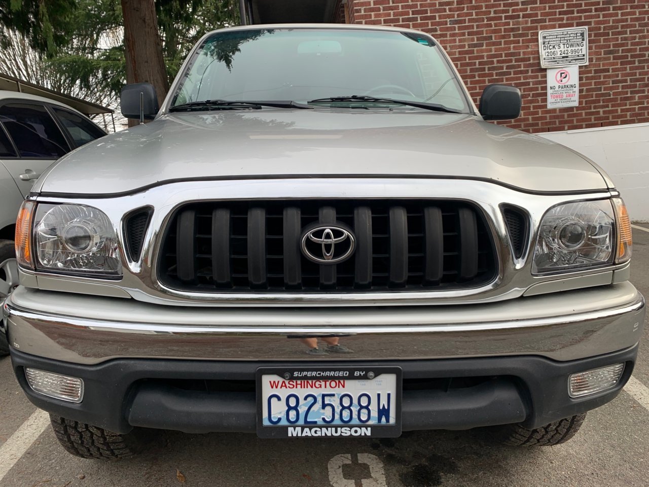

    After:

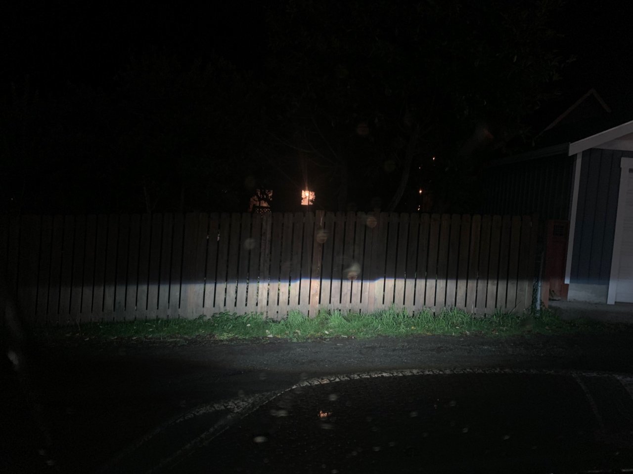

    Forgot the cutoff pic, I have some aiming to do, and I'm parked on a hill so that's why it's kind of weird:

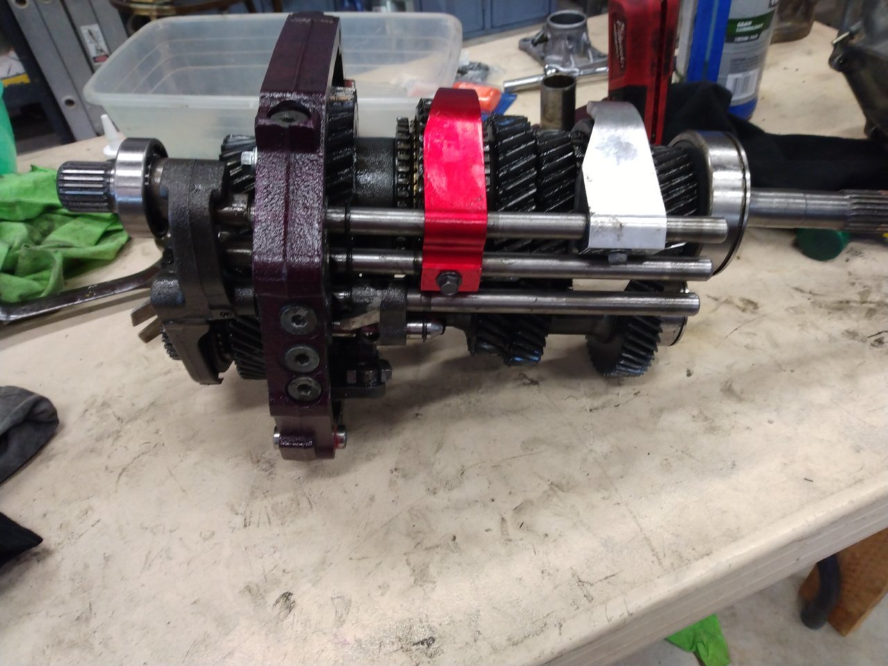

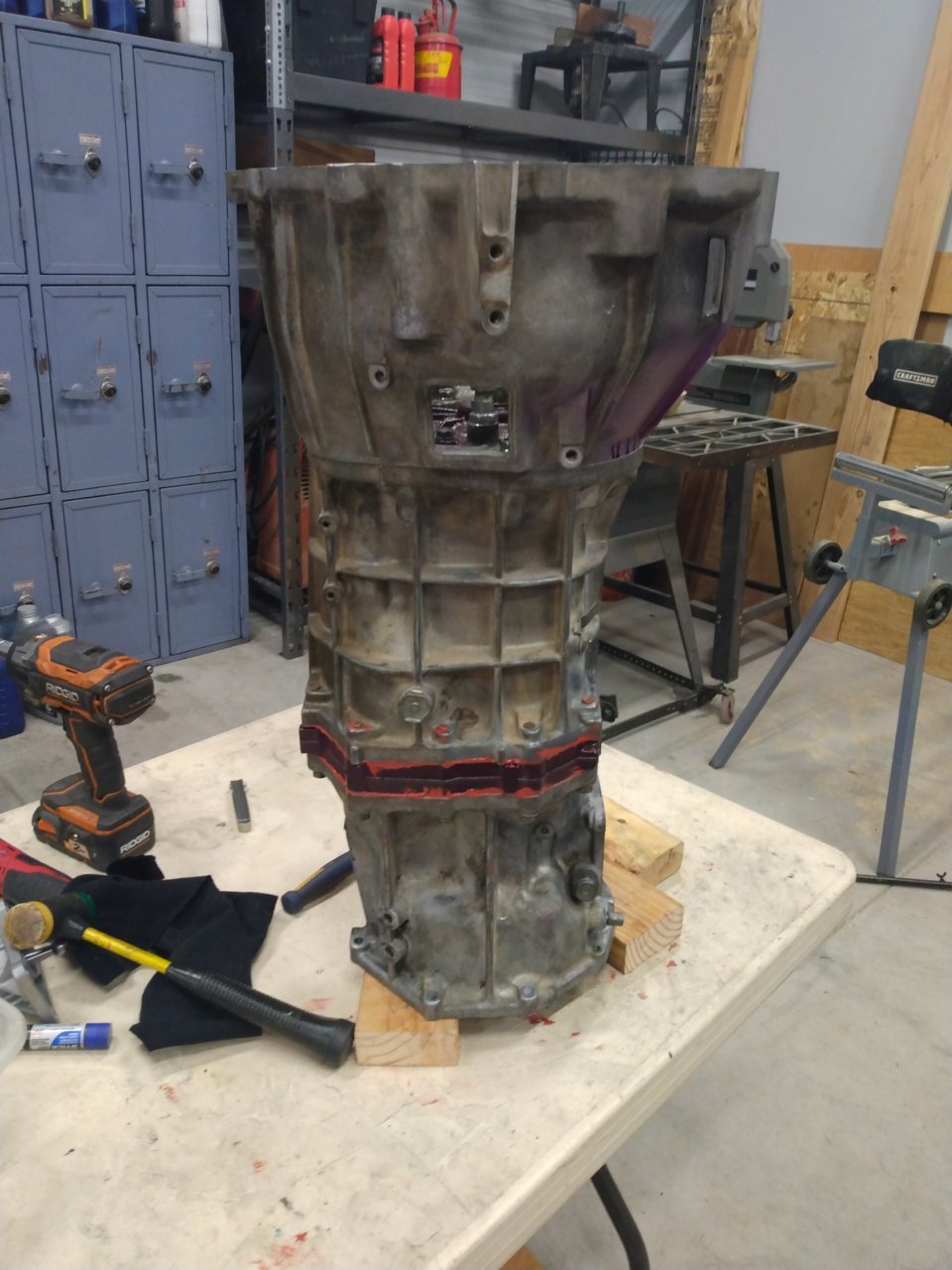

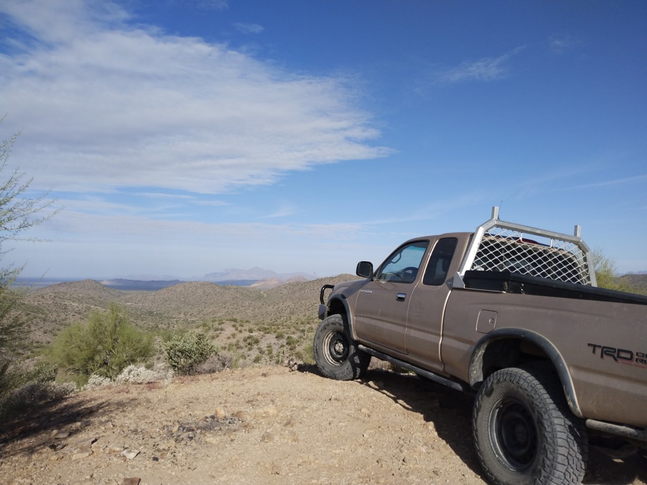

    went wheelin and finished rebuilding my r150f in prep for my manual swap.
    IMG_20211124_093904972.jpg IMG_20211126_161756695.jpg IMG_20211126_174103143.jpg

    Looks great. Clean look.
    Nice to see just a simple projector install without all the halos or other fancy RGB stuff in there.
    Did you upgrade the shift forks? Or get it annodized?

    I got the billet ones from marlin crawler, the 1,2 fork had some cracking.

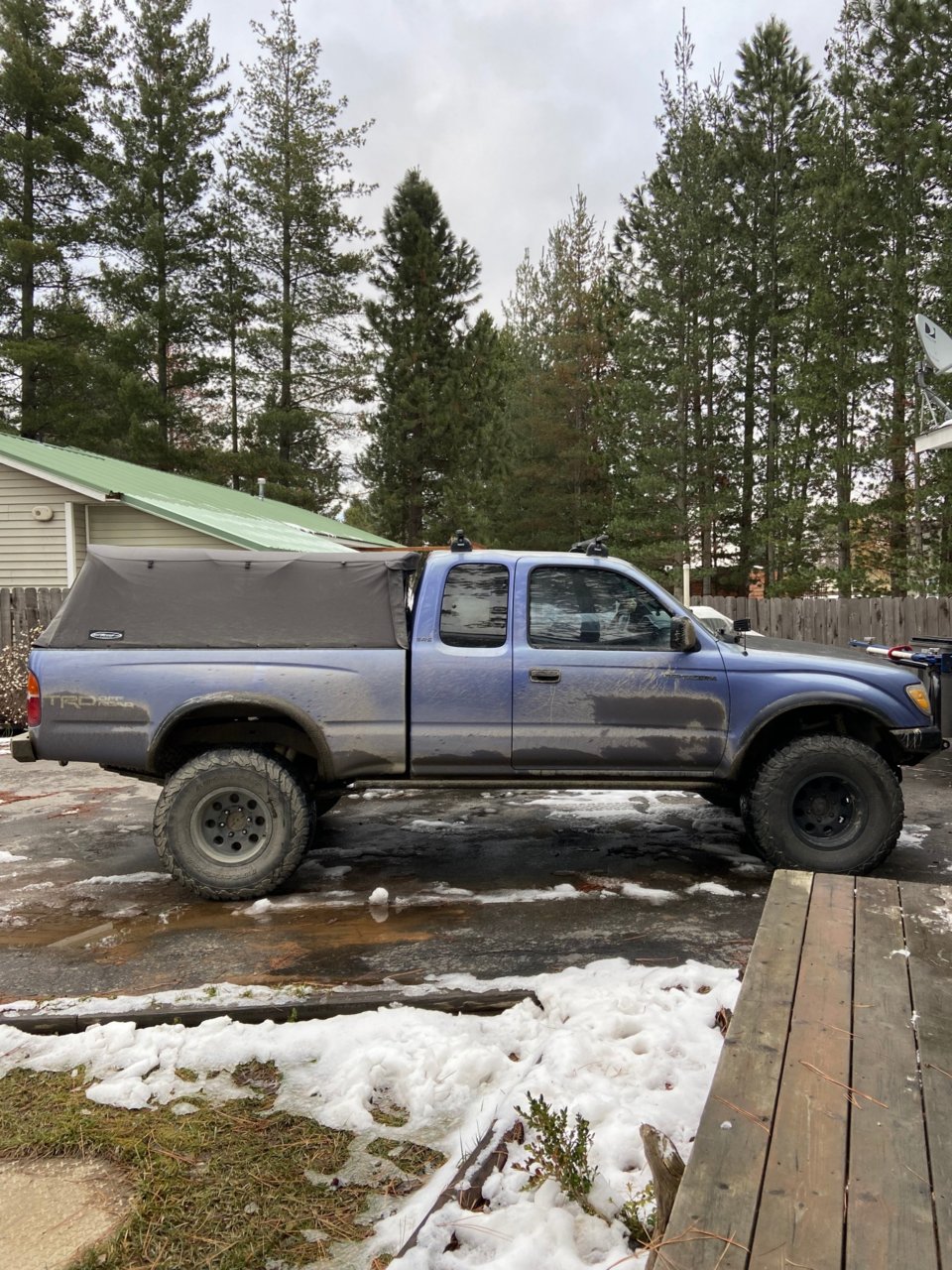

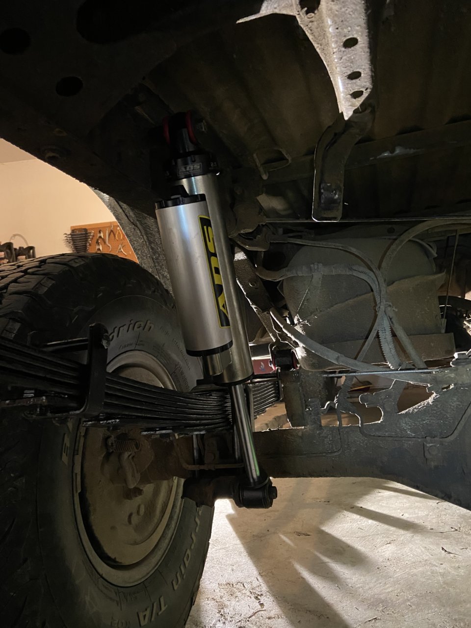

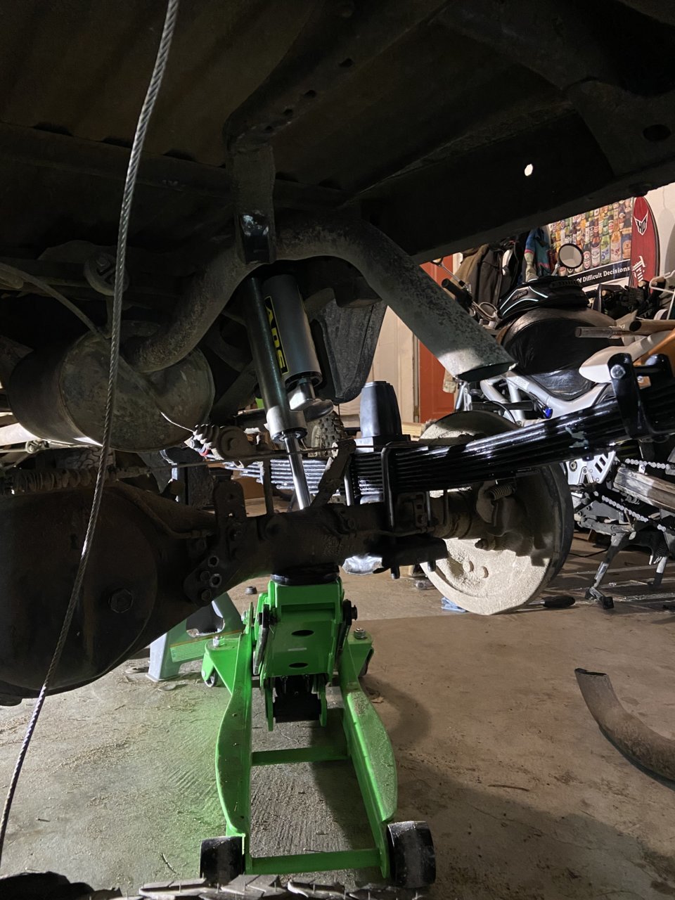

    Finally got around to installing my alcan leaf springs and ads shocks in the stock location.

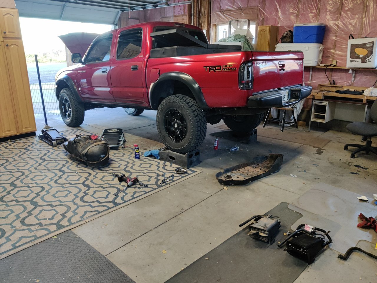

    I was able to get the fuel tank down and get the charcoal canister out. I also took the time to clean up some frame rust I didn't get to when I had the bed off last year.

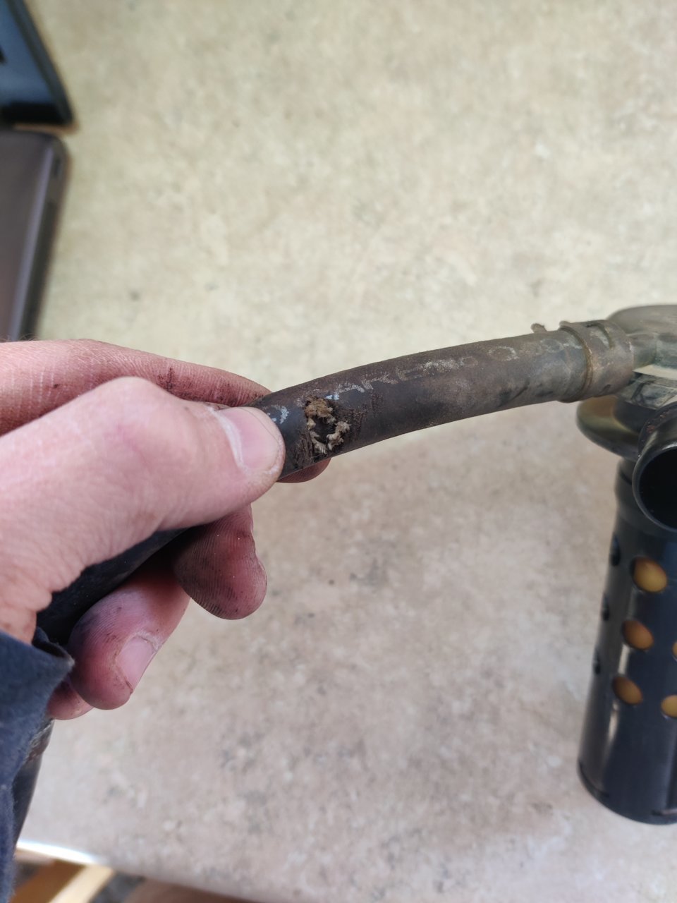

    I also may have discovered the source of my PO442 code

    that will indeed do it

    Good thing I replaced my gas cap 3 times haha
