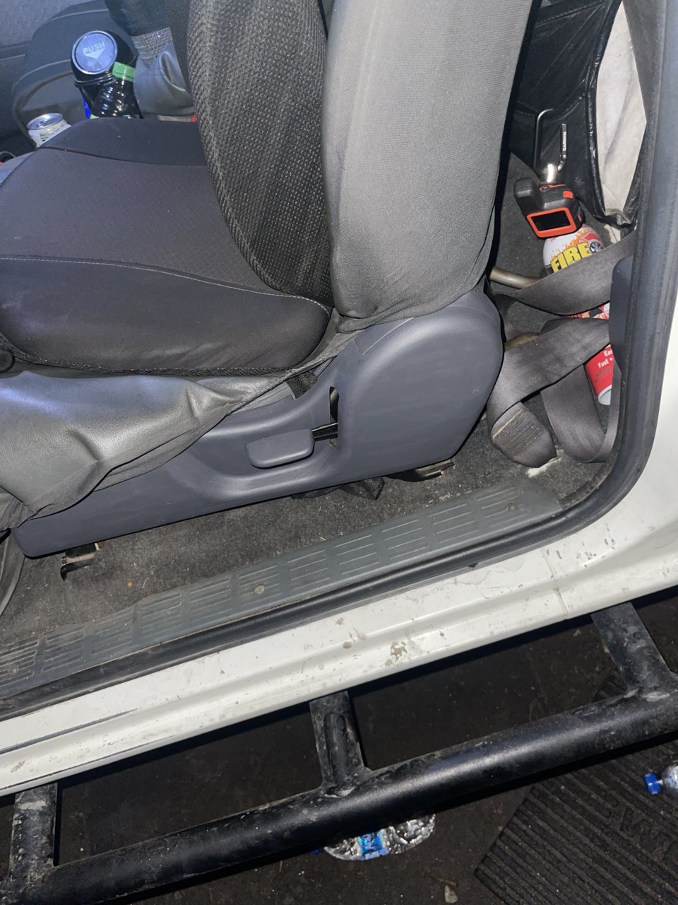

    A rtt i never use and 30 light bars
    30$ for ebay panel
    8$ dealer handle plastic recliner

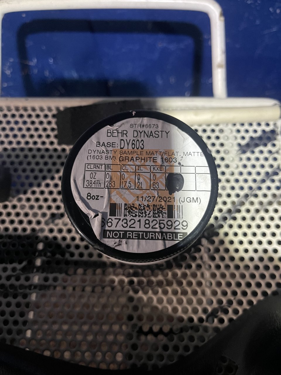

    came in oak, painted it as close as I could get it

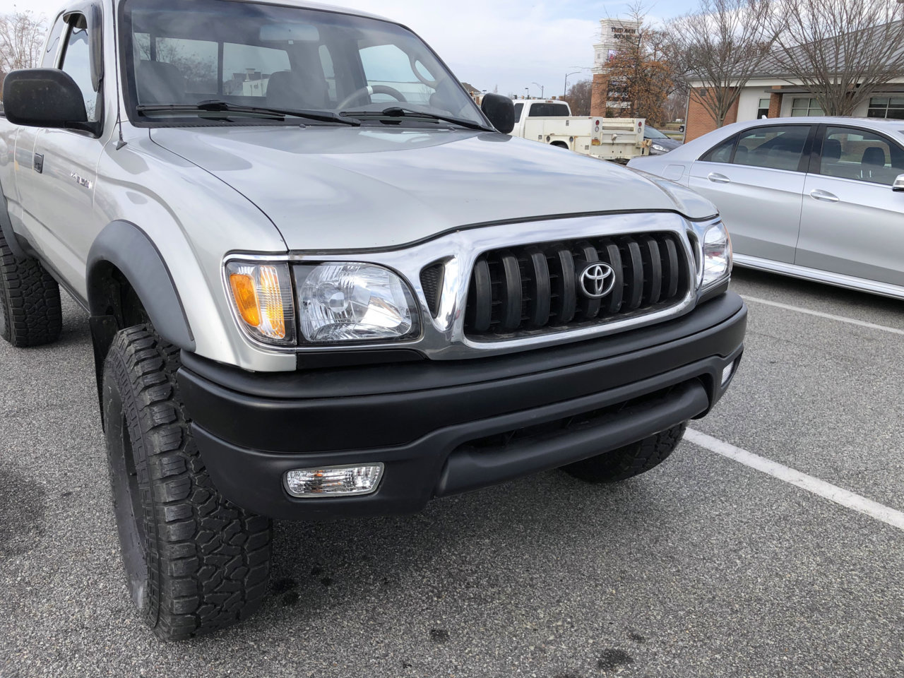

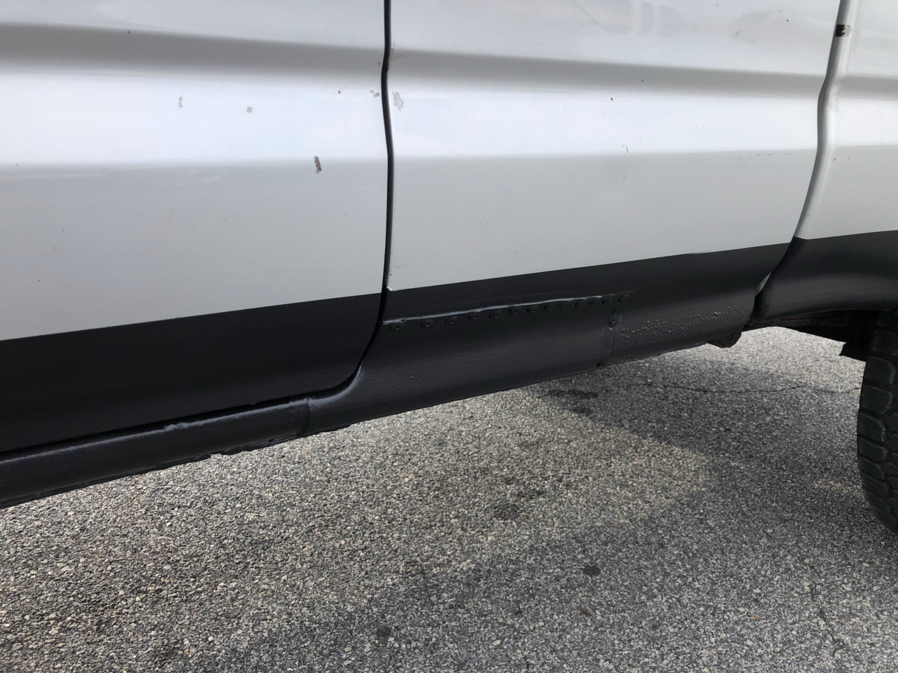

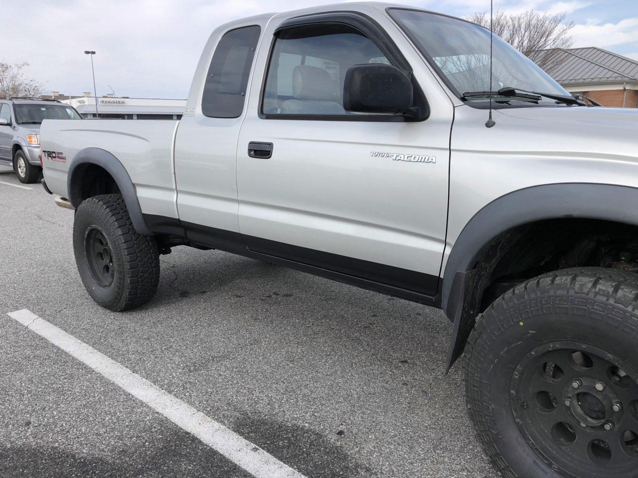

    Got some body rust remediation done! Replaced the front bumper, headlights, turn signals, and windshield. This thing is coming along! Going to pick up the camper shell in a couple weeks!

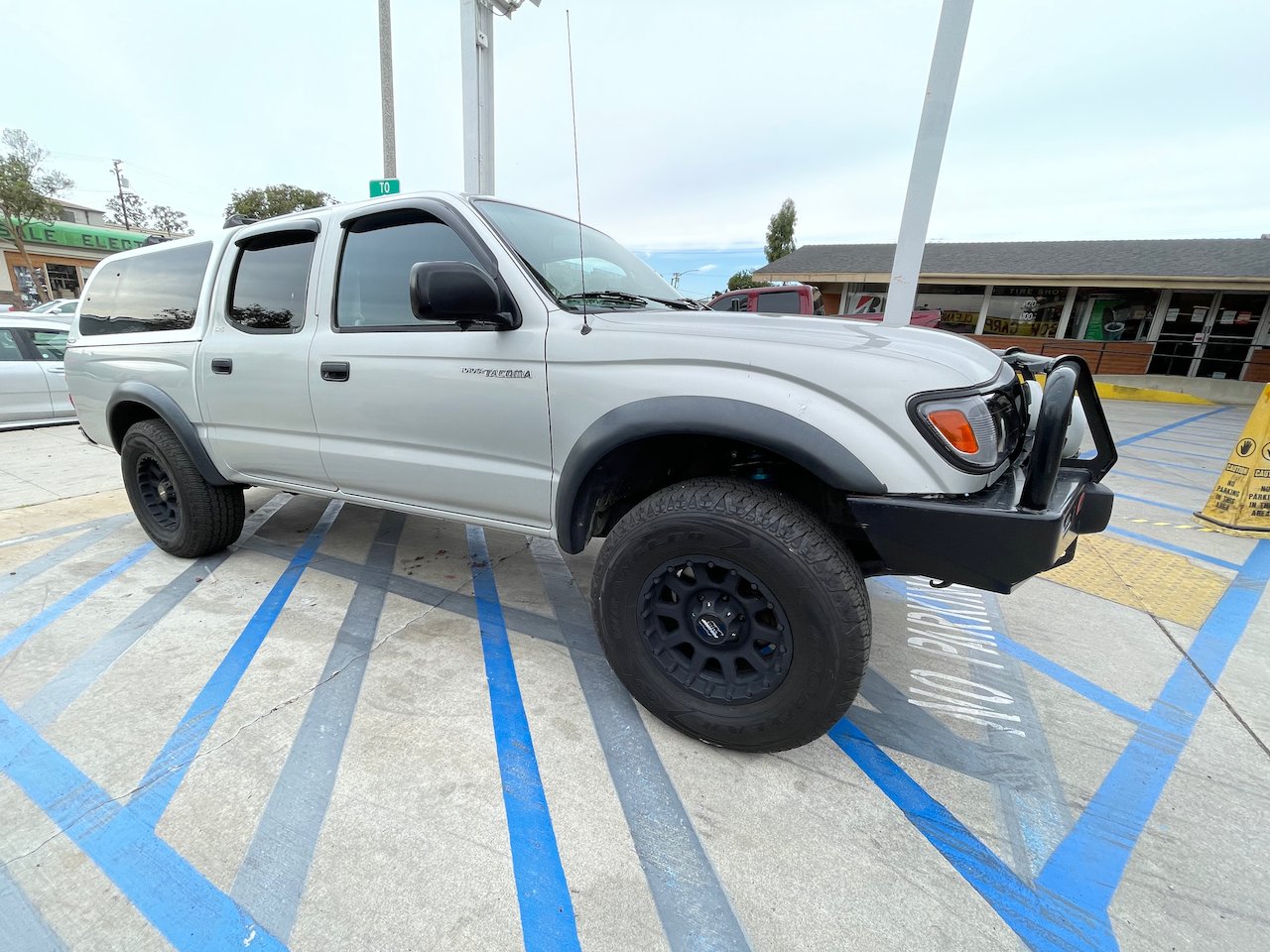

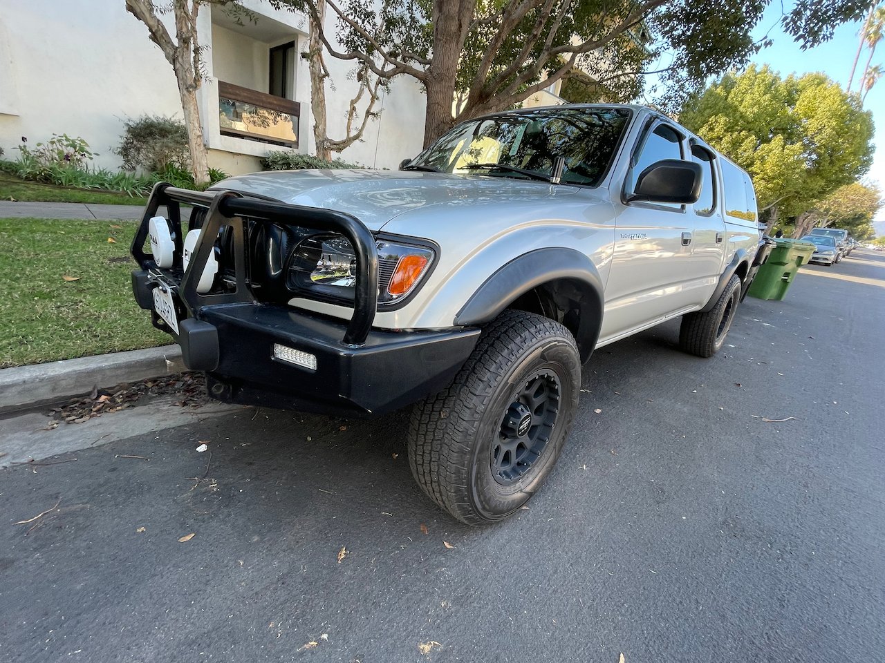

    Shocks are 2.0x12. Tire size is 285/70/17 and the bs is 3.5. I haven’t fully flexed it out but I don’t think I’ll be rubbing on the shocks

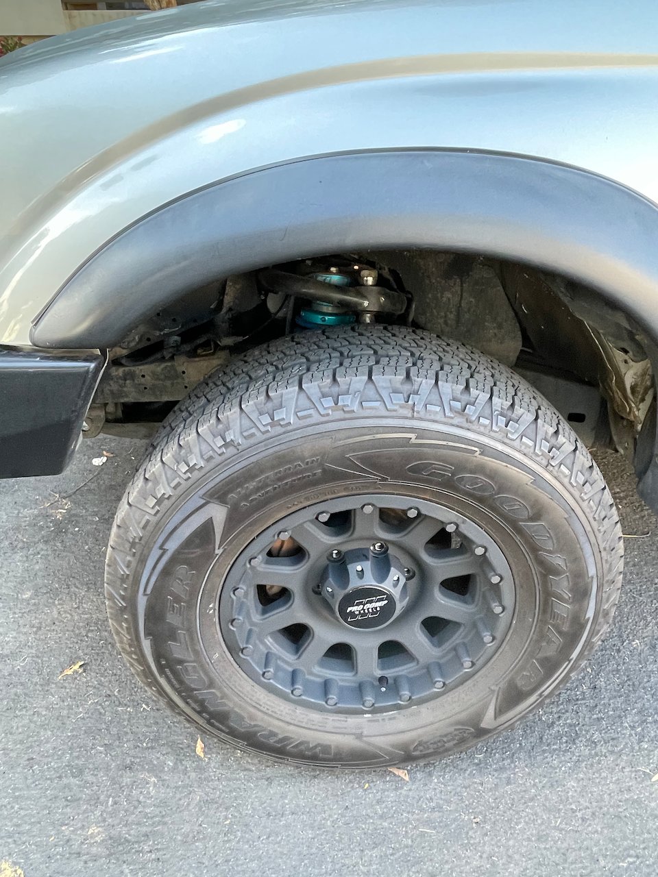

    Replaced my steelies on spacers with Pro Comp 32 Series Bandido, 16x8 Wheel with 6 on 5.5 Bolt Pattern - Flat Black - 7032-6883
    Fit over my 199mm Toyota Tundra brake calipers. I have had Pro Comps before on my Tundra and was very happy. Used 106.1 mm to 108mm hub ring to make sure nothing vibrates.

    I really wanna do this, have you felt a difference in the handling?

    Day n night difference man. On road it feels much more planted and body roll is almost non existent. I can actually take turns without slowing down lmao. I haven’t tested it in the dirt yet but I plan on wheeling tomorrow since my durobumps just came in
