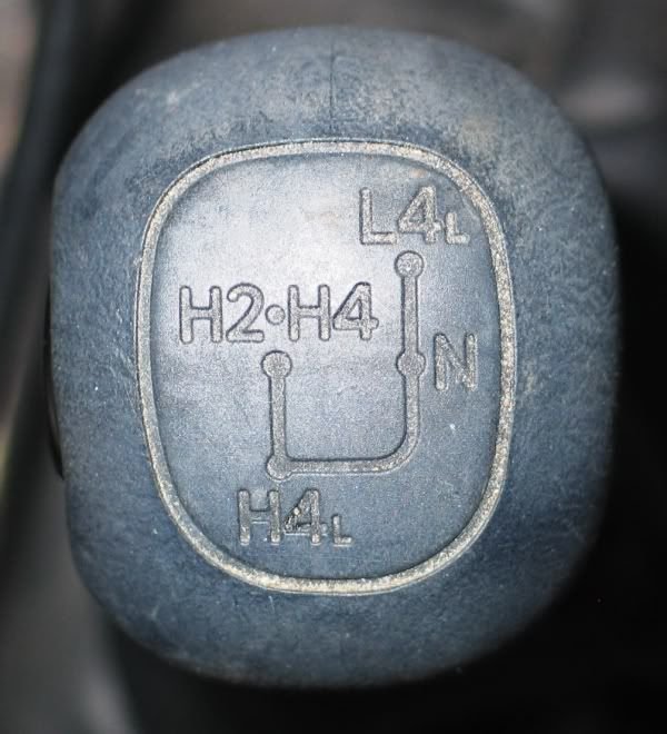

    Not an expert, but... given that it's somewhat common for folks to do ABS deletes, manual hub conversions, and e-locker axle swaps without even thinking about the t-case, I can't imagine there's any significant difference?
    If you expand your search into 3rd-gen 4Runners, there are some other options beyond what was offered in Tacomas. Most interesting (in my opinion) is the "multimode" j-shift, which can be run as an unlocked center diff in case of slick pavement conditions. I haven't seen a definitive answer on how easily a multimode t-case will go into a Tacoma, and I'm not aware of anyone trying it.
    H2: 2wd
    H4: 4wd with open center diff (activated by a button on the side of the shift knob)
    H4L: 4wd with locked center diff
    L4L: Low-range 4wd with locked center diff
    Photo credit/more info:
