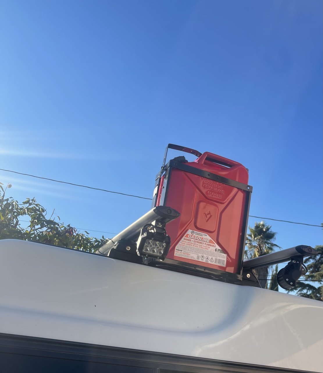

    I had it laying down, they all eventually leak or crack cus of the sun. This jerry can is made of metal and I hope will be my last can, I dont like it standing cus ik its hard on the airflow and clearance, but I knew that, I dont really go to drive thrus tbh and my truck clears my garage. I like it standing as it takes pressure off the seal and I know the gas jumps but makes me feel more comftorable like this. Now the location it had to be there because I dont need a swingaway rear bumper, dont wana make my single cab bigger, I live in LA, the less space the better. The can wont be on there all the time (im not that guy lol) just as an emergency for those longer trips. Jerry can came today.

    looks like not a nato can. So probably won't be your last going off my experience anyways.
    If you want a true last can grab a Scepter one next time. Expensive but worth it. What the military currently uses. And they won't care which direction you lay them.

    Both my scepter cans leak.

    That makes 3 scepter cans that leak... cause mine does too lol.

    Your seals are bad or the lids are cracked then. Not cheap to replace but if you have the right components they can be upside down and don’t leak.

    Brand new seals and the lids not cracked.

    You're going to need the extra gas for all that increased drag you created. :rofl:

    So...
    Scepter cans don't leak
    unless they leak
    at which point, you need to replace a bunch of crap, so they don't leak
    Until they leak again.
    :rofl:

    Sooo, what’s leaking then?

    By the way... it's the Holidays and two of my 3 sons are home. (both of them used Scepter cans as part of their job, in the Army)
    Lmfao... they BOTH agree... Scepter cans ALWAYS LEAK.

    Uhhh, yeah one of em definitely is gone or the threaded neck is cracked. These aren't even the good military Sceptre cans (just regular Sceptre home grade ones) and they survived a week in the desert on their sides exposed to the sun without leaking a drop or smelling even....

    Yeah well I hope its my last one, all the plastic ones ive bought in the past just break and leak eventually. Going forward theyre always gonna be upright. If this one goes, then i’ll buy the one you said. thx
