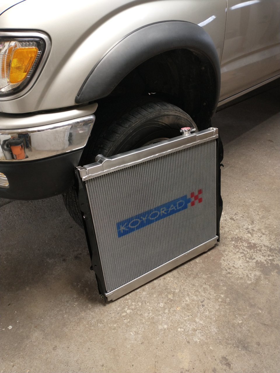

    My radiator on the new truck somehow sustained a dime sized hole in the plastic top. I JB welded another piece of plastic over the hole to hold me over until I could find a replacement.
    Finally installed the Koyorad VH010513
    I coupled it with the Hayden 678 cooler, but the size is difficult to work with and I don't like the placement or hose routing so I may look for another alternative.

    Have you seen the low pressure drop coolers from Long. They offer a variety of shapes and sizes. I have been running this one for the past several years and am happy with its performance.

    I assume you would want the trans fluid going through the cooler before going into the radiator to help keep some of the heat from the trans fluid from making it to the radiator.

    Yessir, and in the winter it makes sure the radiator gets the trans up to temp quicker as well
