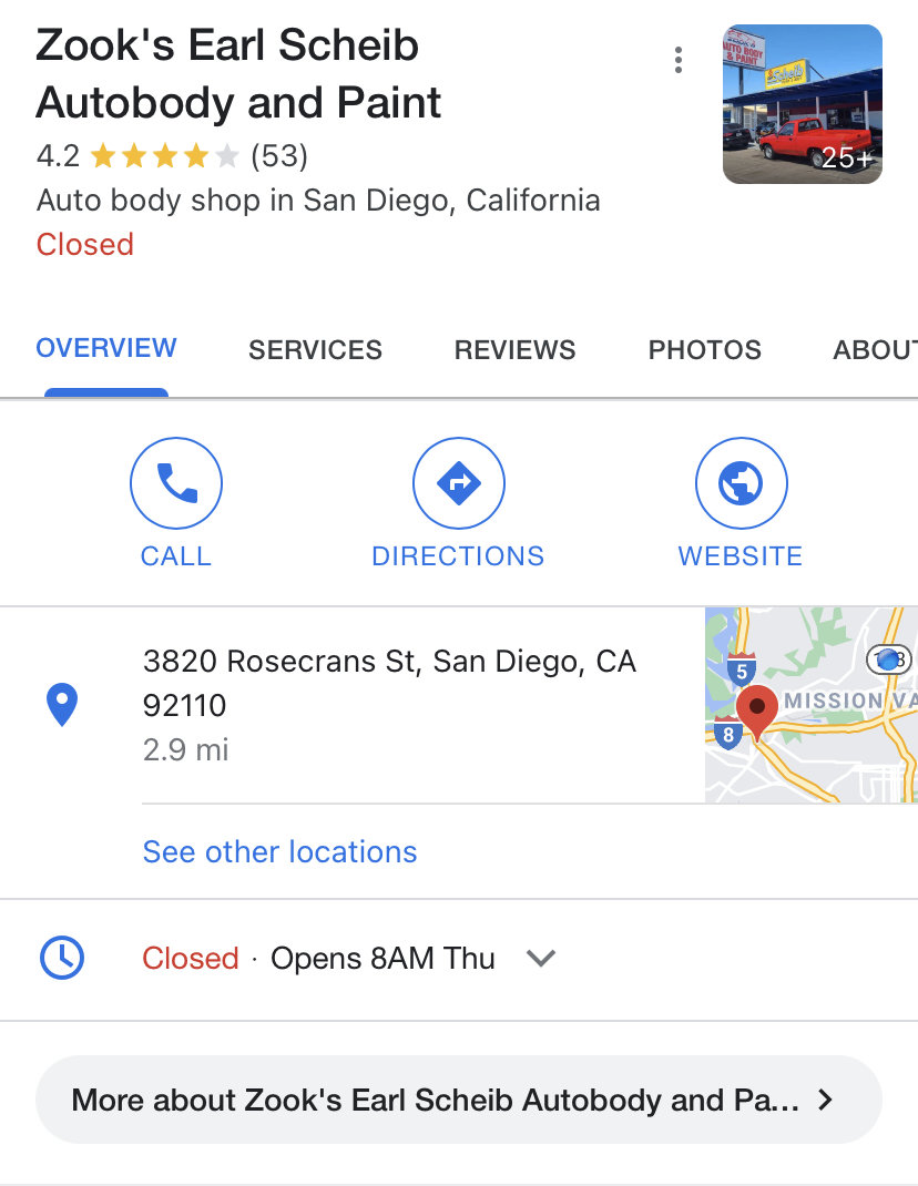

    This is the place I took it to. Only cost me 400 bucks

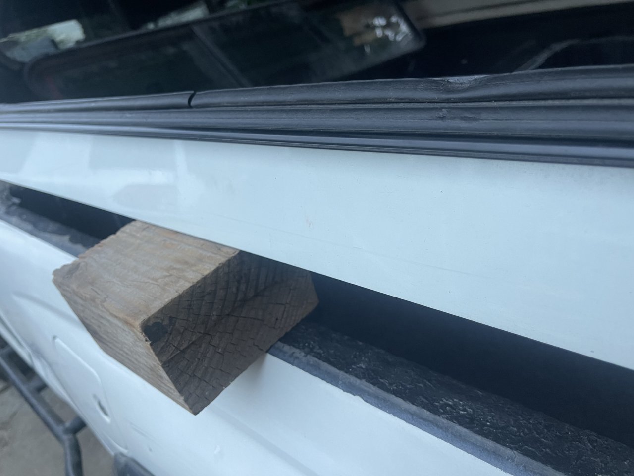

    A rtt i never use and 30 light bars
    resealed hi roof topper
