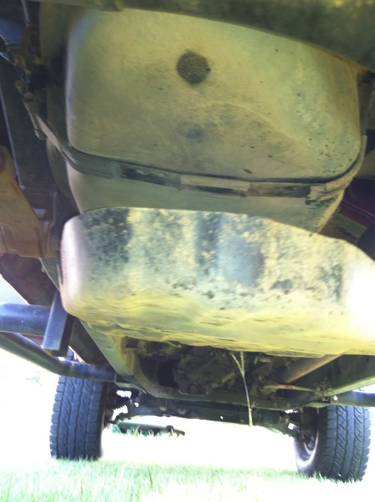

    I have a ? The metal around my gas tank under the bed do I need that

    i think it holds the tank :notsure: but i wouldn't take it off

    Well it's hanging down in back I'll take pic when I get home

    cool i wanna see what your talking about :)

    here it is

    gas tank skid, i think

    Gas tank skid. There's two bolts on the back and 2 bolts up front (actually 3 up front, but only 2 of them hold the skid on).
    The rear two bolt into the strap that wrap the tank and which seem to be missing.

    I only noticed it cuz I was checking my brake line to c how it was doin. Can I remove it. I can weld a strap on but I'm kinda hesitant since its my gas tank. Any suggestions

    You can remove it. Just pull the two bolts off the front, to pull the skid, then replace the two bolts up front. If you don't, your gas tank will only be held up with the rear strap and 1 bolt. Not a good idea.
    Alternatively....just fine two bolts and replace the missing ones in the rear. No welding, no muss, no fuss.

    Lol that's all I need my gas tank falling of while I'm driving down interstate
