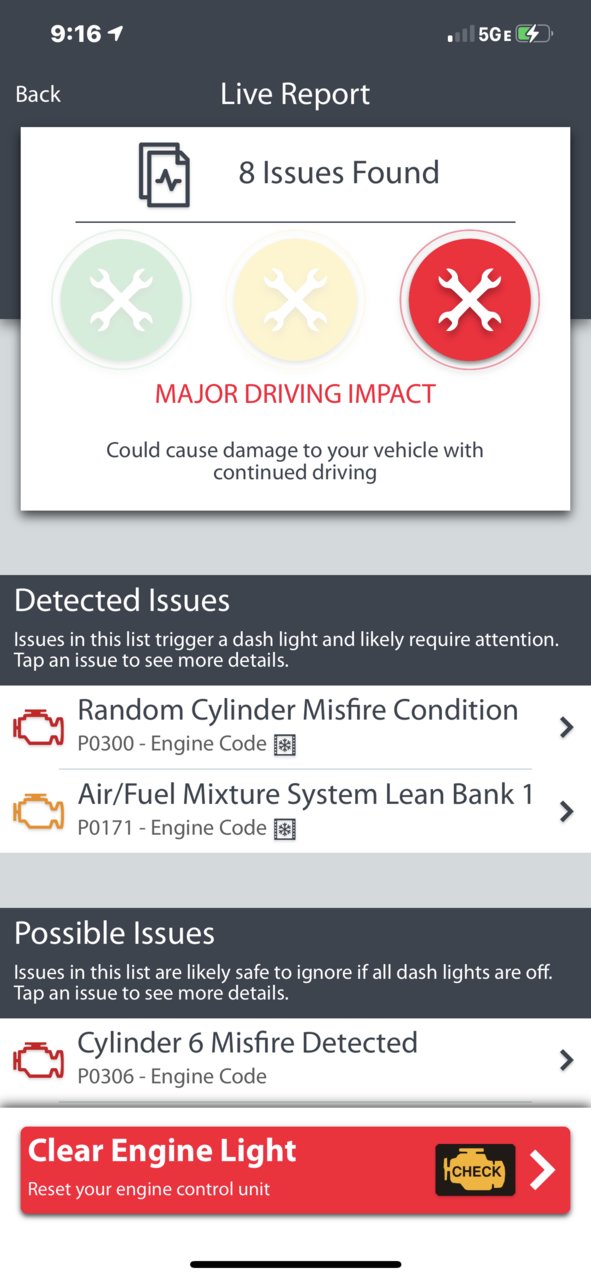

    So I’ve gotten it to operating temp since replacing IAC last night multiple times now and right now it’s idling at about 1500 rpm and isn’t coming down yet. Check engine light is on. These are the codes I’m getting.

  10. Dec 27, 2021 at 9:20 AM
    Logans2001
    Logans2001 What’s crackin’
    Jan 23, 2016
    #175792
    1,981
    San Diego, CA
    2001 v6 4WD auto
    Is this something that usually takes a few days to adjust itself or like a few minutes?

    It's less Tacoma and more mod
    Well you're getting a misfire from something, might be worth inspecting your coils, wires, and plugs as a starting place. Those codes rarely go away on their own. The lean code might be real or it might be from not having your MAF plugged in. Reset your ECU and see what comes back, my guess is the misfire will and you'll need to address that.

    It's not the only thing that would cause a misfire... But, the only time I've had random misfire, it was my spark plugs. I replaced them and cleared the code, and it never came back.

    Ya it’s just weird cus I didn’t have any codes before I replaced the IAC now all of a sudden everything’s haywire lol. Spark plugs are brand new.

    Ya, that's odd. Is the IAC and OEM? You sure it's connected properly? Did you disconnect, or bump something else loose when you were working on it?

    No I got it off RockAuto for like $120. That’s what I’m trying to figure out but from what I can tell everything looks normal. I did forget to plug the MAS back in for a sec when I started it up for the first time but that’s obviously fixed now and I even cleaned the MAS. Am perplexed lol.
    Something definitely does sound different though. It’s like the air intake is louder but not from the filter but more from the TB.
