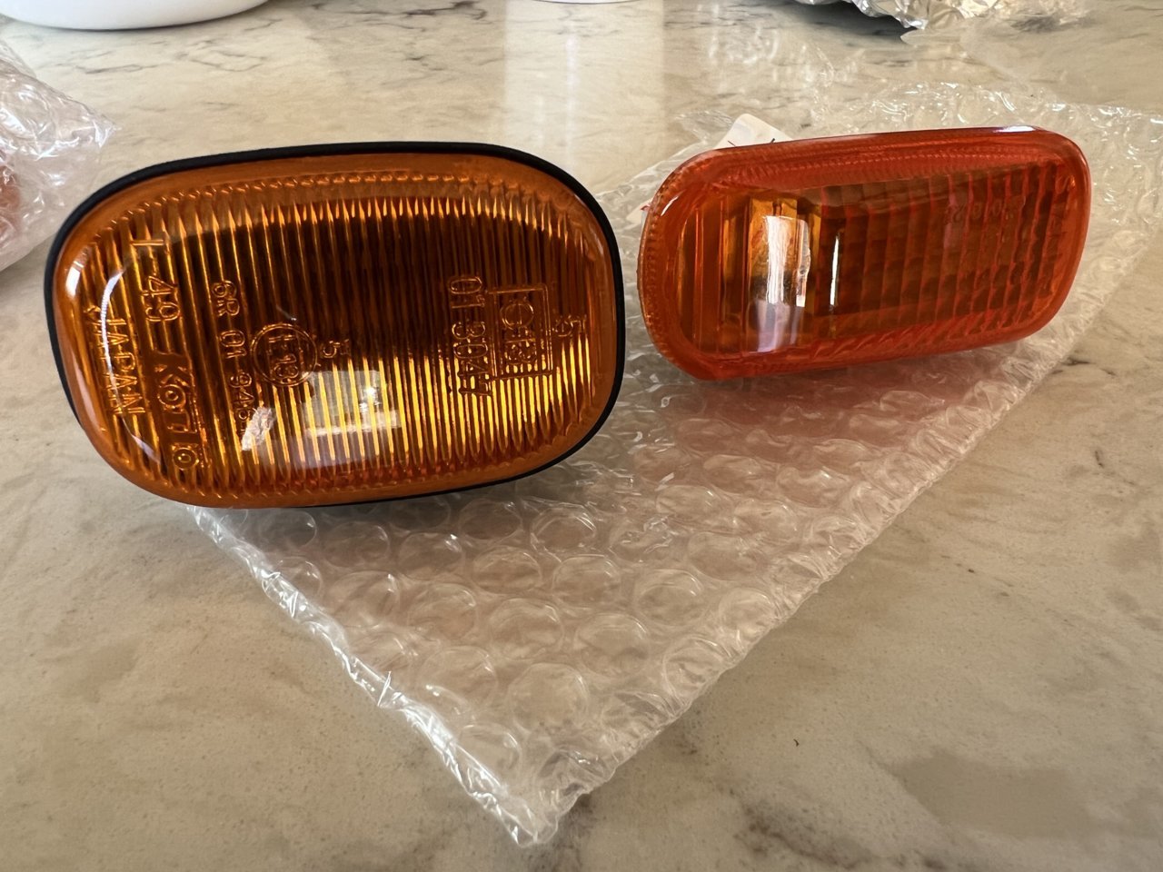

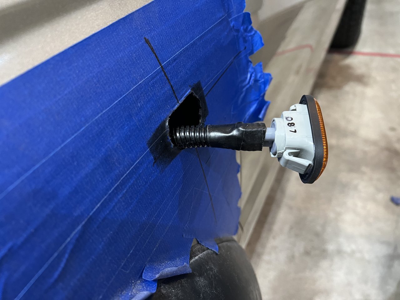

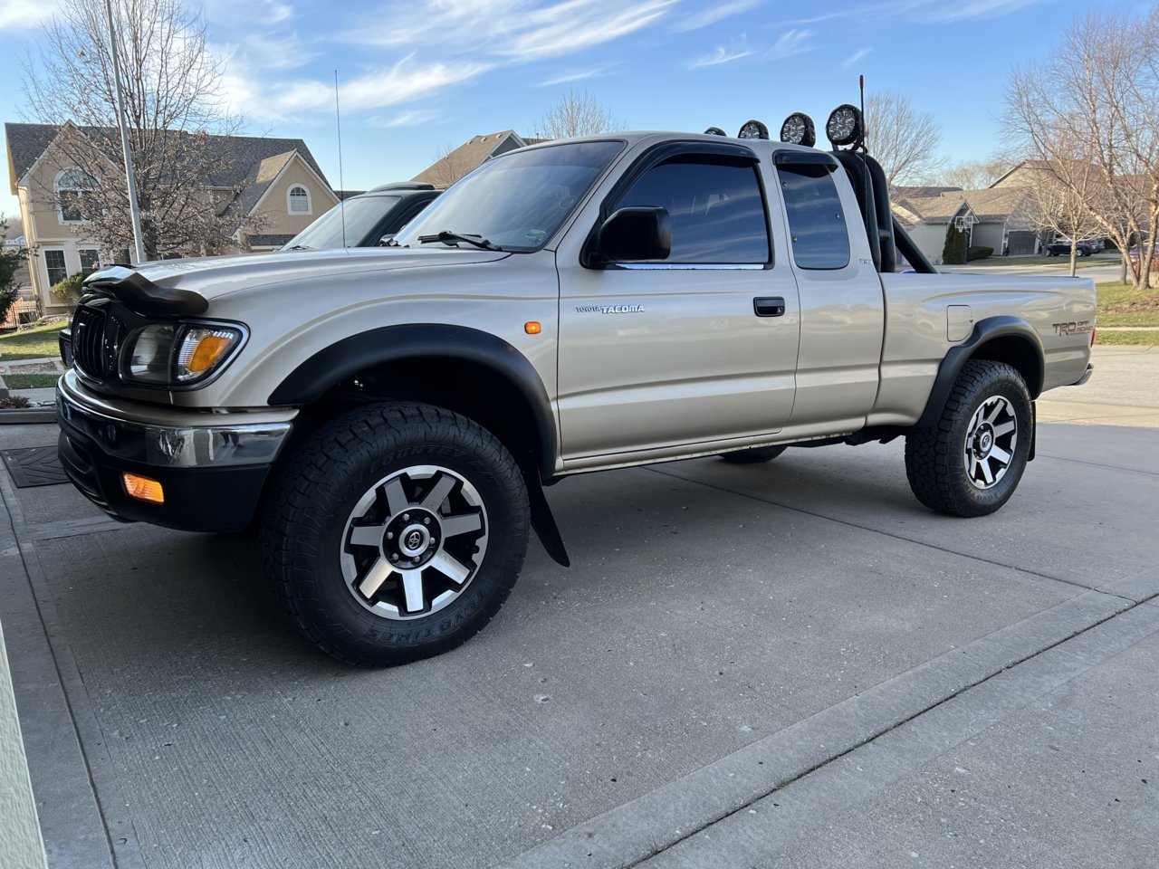

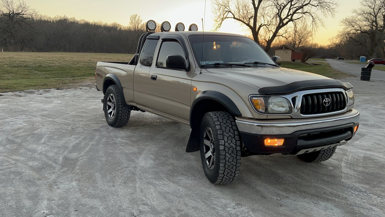

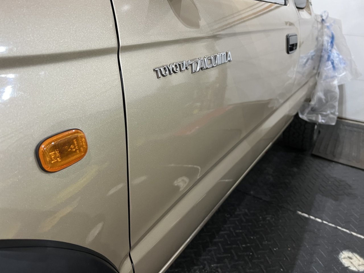

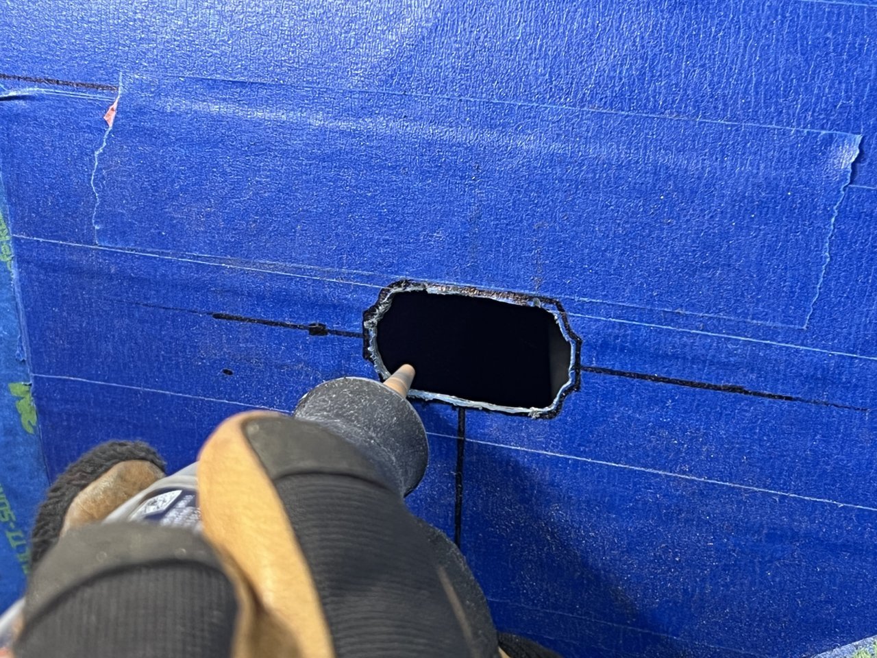

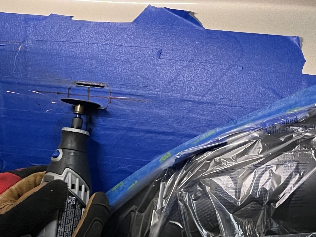

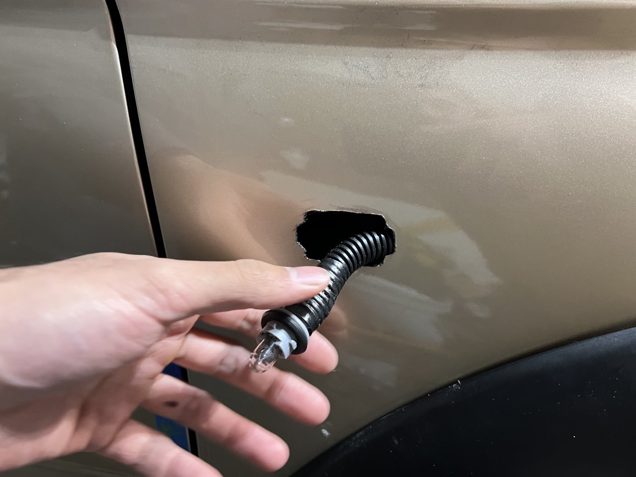

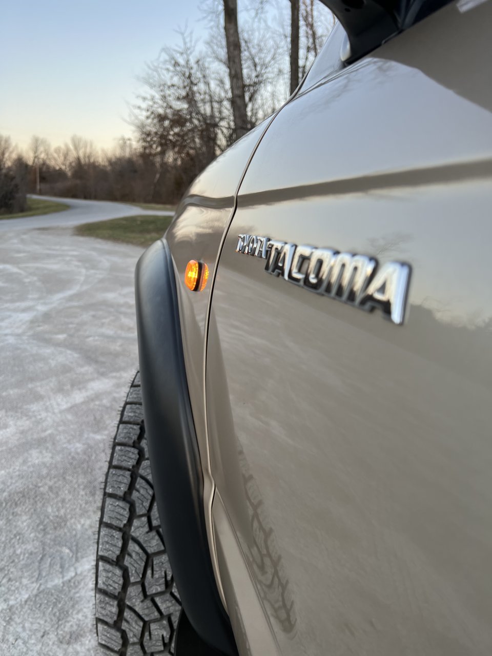

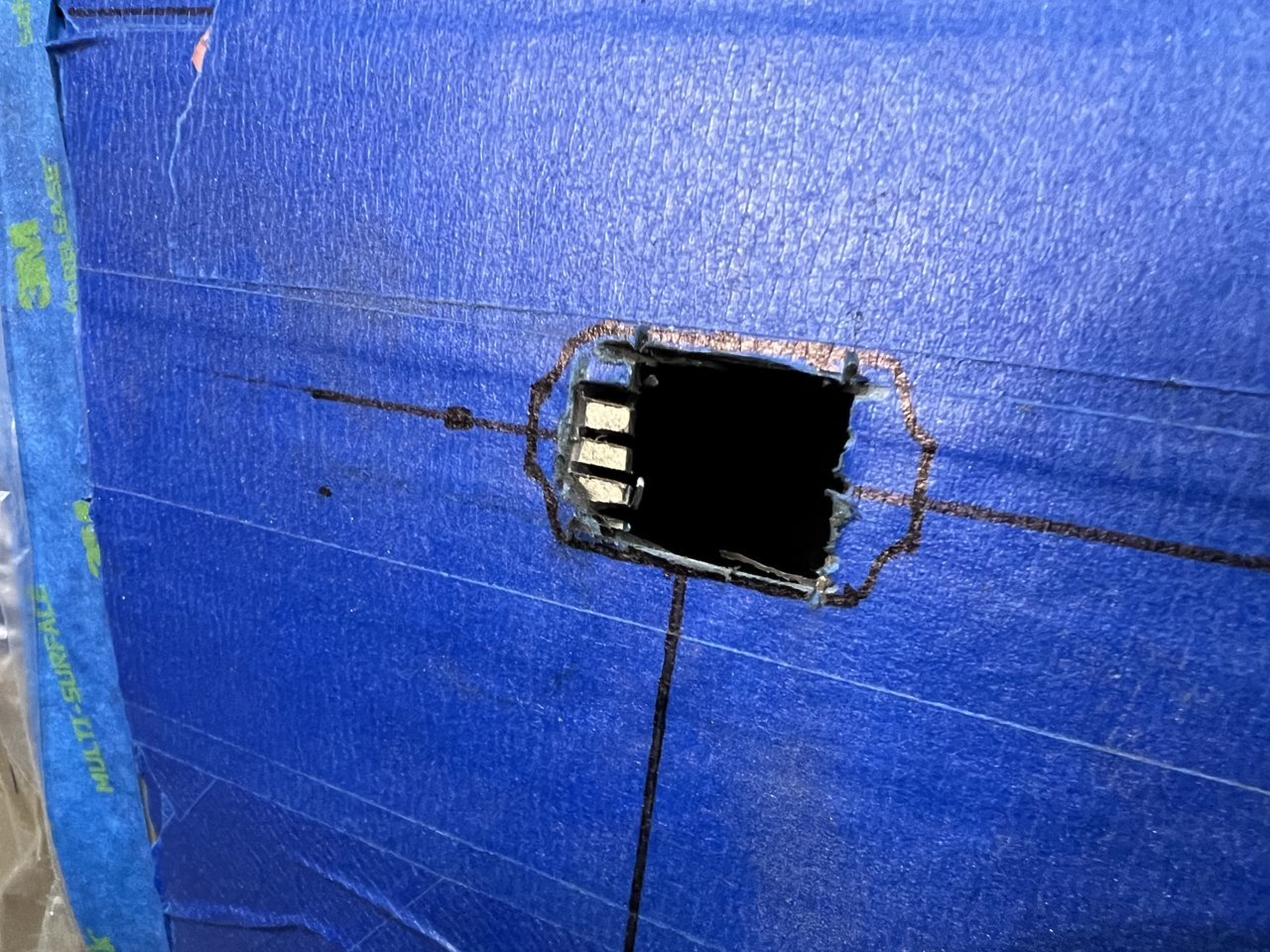

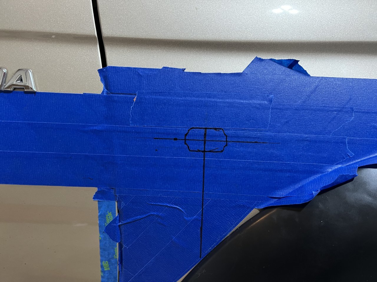

    Woah, thanks guys! Didn’t expect such a positive response. A lot of my friends had advised me not to do it, but in the end I did what I wanted and I’m VERY happy.
    Of course I took pictures!!
    First, I debated between the actual hilux fender markers or the Acura rsx which I had used before. I voted out the hilux fender markers because they looked visually ugly. I then stumbled upon landcruiser and Supra fender markers. After a lot of research, I ordered the Supra fender markers and compared them with the Acura markers side by side and wired up so I could see which one I liked better. The Supra (93-98) were the best and felt quality.
    next step was getting a template. Basically I traced one out on cardboard and test fitted. Then I pretty much mocked up where I wanted them to be on the truck. I followed the Toyota Tacoma badge as a reference when measuring to make everything even on both sides. I masked everything up, measured 200x and my brother started cutting! Then after it was cut, I painted the exposed metal. And then clicked them into place. Wiring wise, positive went to turn signal, negative wire went to the positive of parking lamp.
    Here’s some more
    Pic!
    First pic is the Supra (left) and rsx (right)

    NICE!

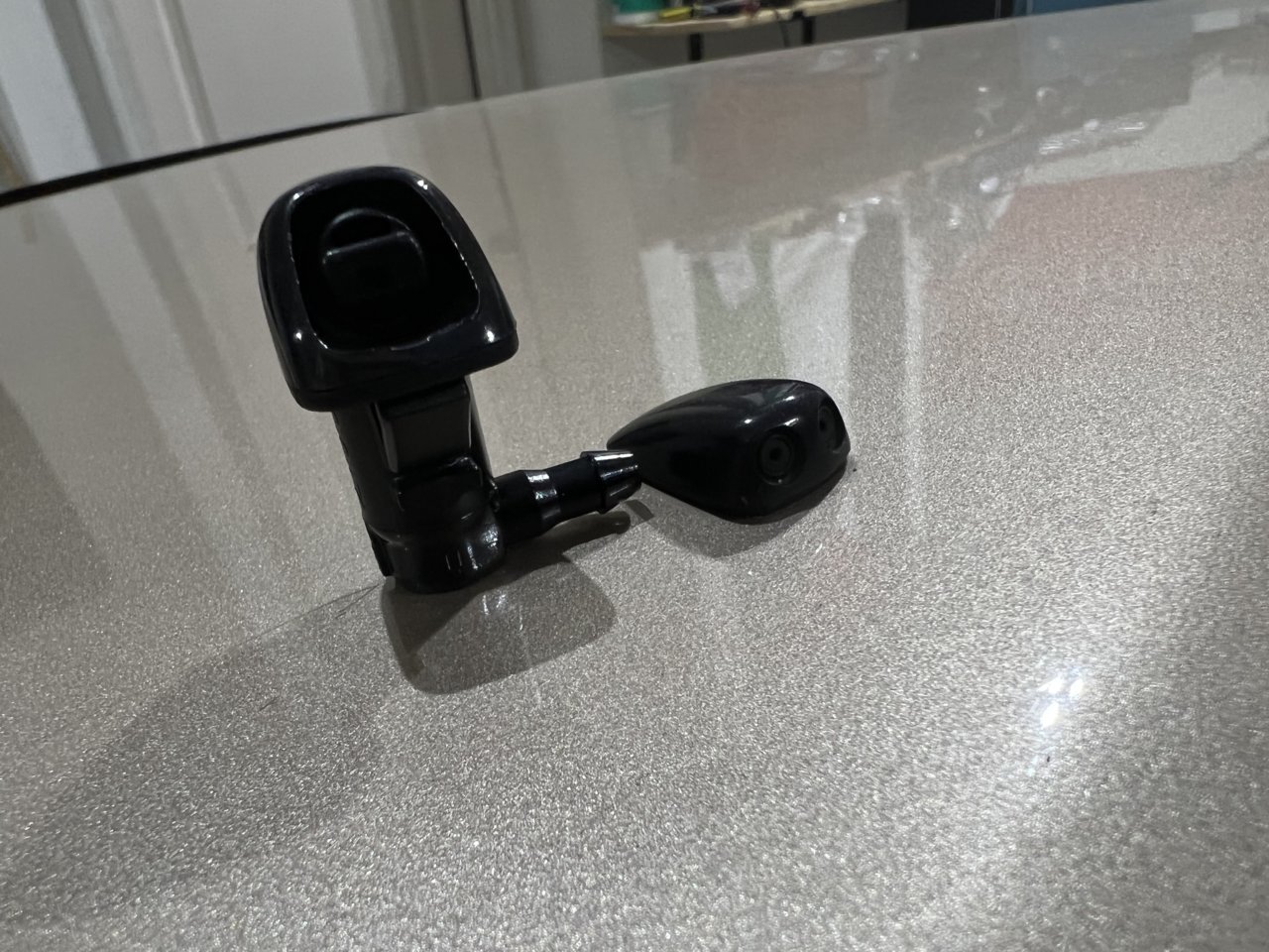

    thank you!!
    Doing the windshield nozzle upgrade now lol

    I've had those damn nozels on one of my lists in Amazon for 2 years now lol

    I’m about to put them in!

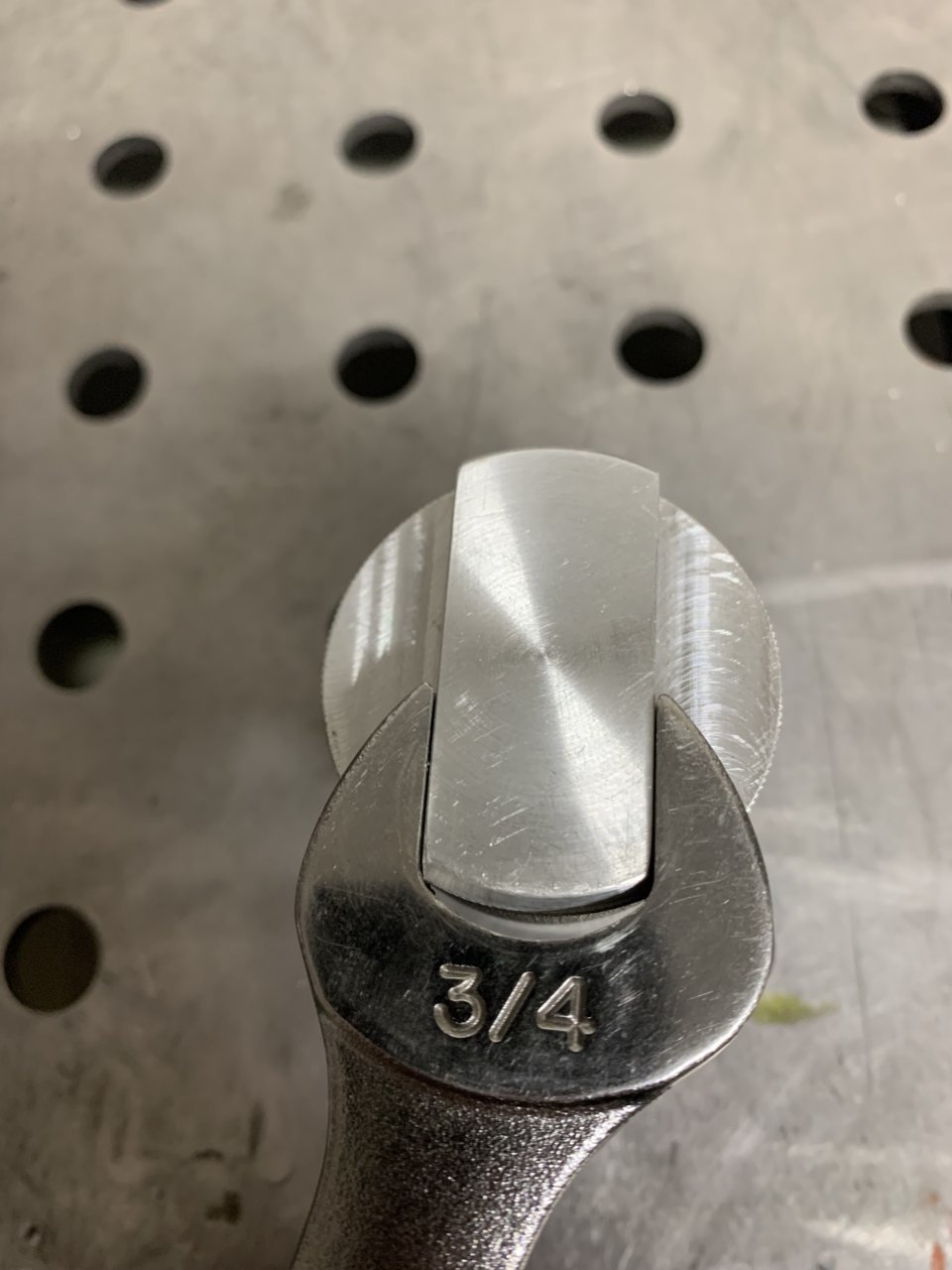

    I can I just need the measurements of the hubs. I sold all my touota hubs a year or so ago and don’t have one to measure. Just need the dial inside diameter and the thickness of the rib.
    Send me a pm if you want one and can get me the measurements.
    I could make a square hole. A few guys on irate suggested using a broach to make a 1/2 or 3/8 square hole for a ratchet but they’re pretty pricey for the few I do and would just add time to the overall process. I could also do it by hand on the mill but I’m sure it wouldn’t be easy. That’s why I came up with the wrench flats for the 3/4 in wrench figuring most suspension hardware is 1/2 in bolts etc and a 3/4 stubby wrench or even full size wrench is easy enough to keep in the glove box with this.
    if you want one with the square hole for a ratchet pm and we can work something out.

    You can grind one from a hss blank. Would be cheap and easy.
    There's also those wobble head things, forget what they're called now though...
    Edit: rotary broach, but they're not cheap.

    Roto broaching is rather tedious without power feed too... Plus your ground blank needs to be precisely a certain length (in relation to the center of the wobble)

    True. I've never used one, never even really looked into them, just know they exist. I've only ever milled or broached. For those a grind would be fairly straight forward.
