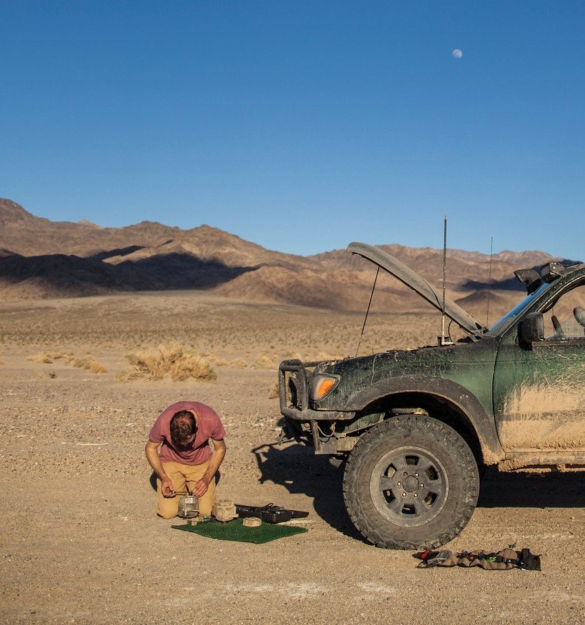

    Feb 20, 2014
    #123587
    58,551
    FCQM+VG Cheney, Washington
    It's less Tacoma and more mod
    Yeah I find I liked the alts that fit the truck better if I'm gonna go through the hassle. The other ones have pulleys that line up properly with the right amount of ribs too. Mike's would have been a lot easier without the coil bucket placebos in place, but honestly the failure rate of these GM alts is enough to make me steer clear even if they were plug and play.

  2. Jan 4, 2022 at 10:24 AM

  3. Jan 4, 2022 at 10:24 AM
    m3bassman
    m3bassman Well-Known Member
    Jan 16, 2011
    #49376
    17,138
    Green truck
    Zane I think I still owe you Jag brushes?
    unstpible and Speedytech7 like this.
  4. Jan 4, 2022 at 10:26 AM
    Speedytech7
    Feb 20, 2014
    #123587
    58,551
    Haha, that truck is long gone, coffee in the mornings more than paid for that anyway :)

  5. Jan 4, 2022 at 10:28 AM
    Blackdawg
    Blackdawg Dr. Frankenstein
    Dec 31, 2010
    #48500
    81,652
    Monte
    Wyoming/St. Louis
    The Trifecta of Taco's
    How are the ribs off? There are 2 different pulley on the GM alts which makes it all the more complicated.
    I do find it odd how many I've seen fail. Frankenstein still has the first one I put in him and it's never failed(has turned in years I know but still) was surpised Mikes failed twice really. His first one was after I'd done mine. :notsure: Gamble for any reman alt though IMO.
    Ah, so just a drill and bam you're good. Cool. Might try one of those for mine.
    Speedytech7[QUOTED] likes this.
  6. Jan 4, 2022 at 10:28 AM
    m3bassman
    Jan 16, 2011
    #49376
    17,138
    Green truck
    That trail fix turned into the permanent fix lol
  7. Jan 4, 2022 at 10:31 AM
    Speedytech7
    Feb 20, 2014
    #123587
    58,551
    Well you have to have the pulley with the 1/4" spacer built in to have any line up right, but ebven then Mike's belts visually are out of alignment (and you've heard the noise it makes) and there's no more ribs to shift to (GM uses 6 rib and we use 4). It was designed for another vehicle entirely so I mean no real surprise, it works well enough on our stuff if you're not concerned with the occasional squeaking and throwing a belt.
