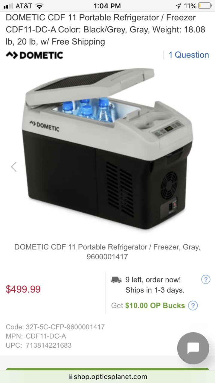

    You can fit a 12 pack and more tbh, I have another cooler in the bed if it dont fit/longer trips.
