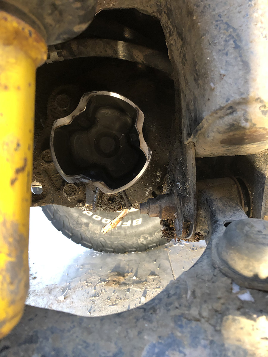

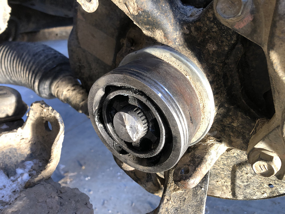

    OK, got it done. I had an old parts store CV that pulled off my truck a few years ago because it had torn a boot. I took it apart to see if it was OEM, and if it was I was going to reboot it. It was not, but for some reason I didn't throw it away. Lucky that.

    Cutoff wheel on an angle grinder. I'll give the part I cut off to a friend that makes knives. Probably good knife steel. I know he made some good ones out of my sway bar, and old leaf springs.

    Something is not right. I took it for a test drive and every once and a while I hear grinding noise. Doesn't do it all the time, and I never got above 20 mph. I jacked up and spun both front wheels, one at a time, and couldn't reproduce the noise.

    If you’re going to go to all that trouble, why not pull the CV outer end and cut the cup, bearing cage, and shaft end all off? Less rotating mass hanging off your wheel bearing, and that grinding noise you hear might be the shaft flopping around with nothing to keep the bearings from rotating.
    I keep these with me at all times for a similar situation to yours, pretty easy to make considering how far you’ve already gone.
