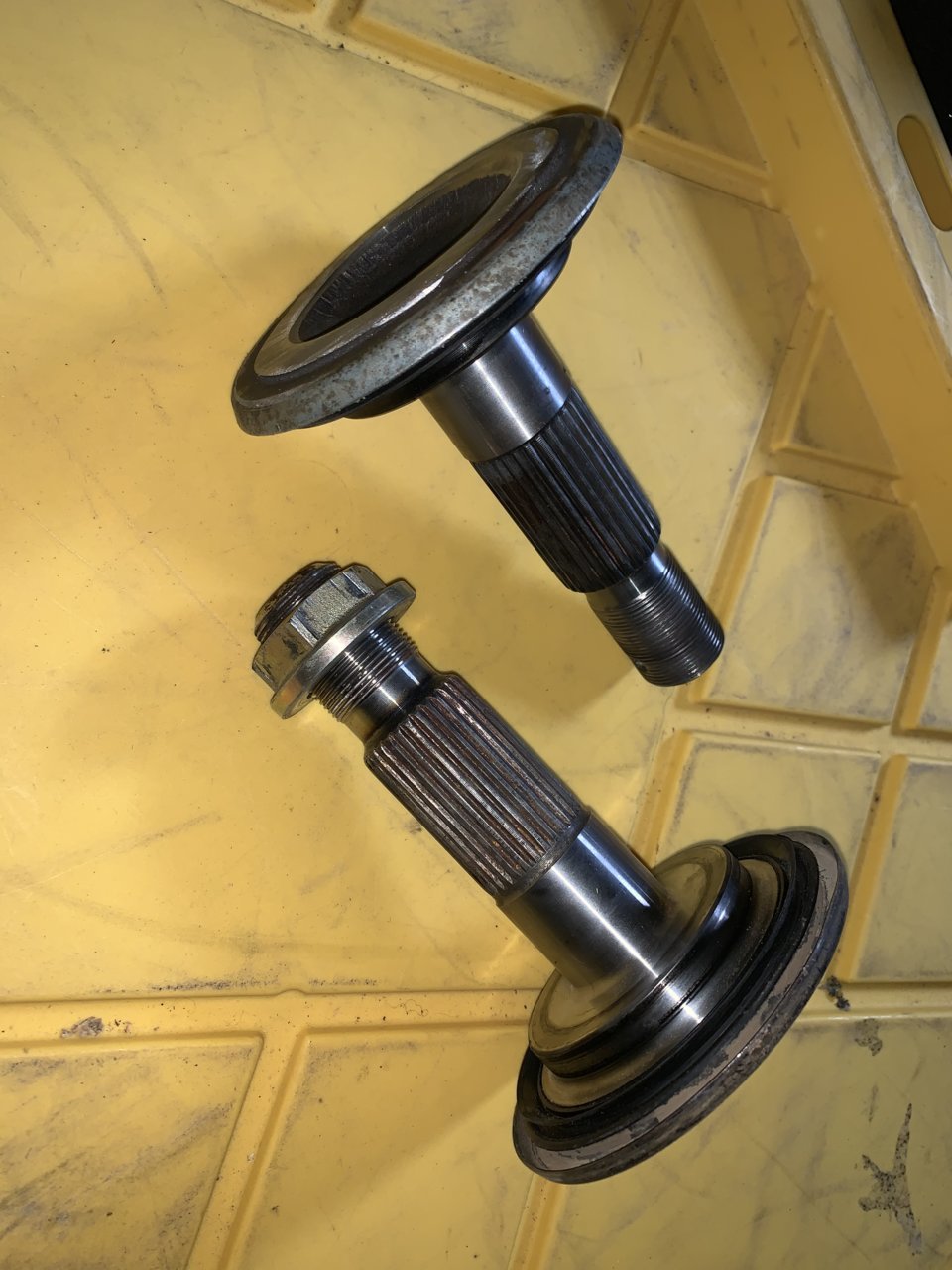

    Ah gotcha. Good to know.
    I guess I've been carrying around these stub shafts for no reason then lol

    I need a set of these. I guess I'm gonna have to break a couple of axles to get them. :rolleyes: a set of 35s might do it
    I sure as hell ain't cutting up some good OEM axles for this.

    One of mine is from an OEM CV that I grenaded, the other is from a cheap aftermarket that I sacrificed for the inner/outer ends.

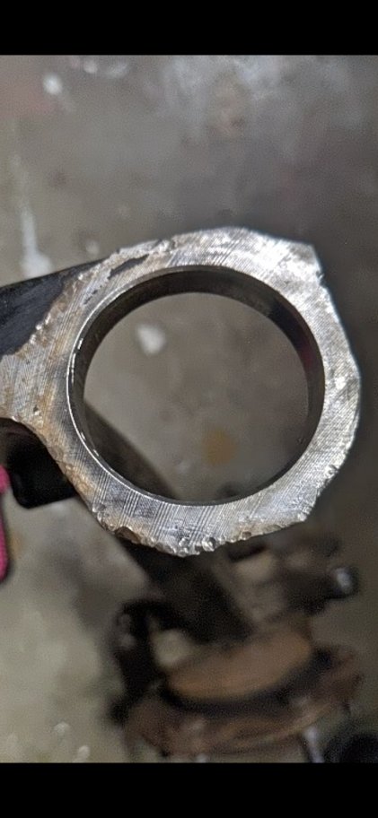

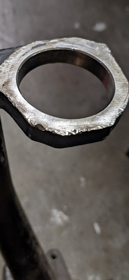

    Picked up a couple of knuckles and planning on replacing the hubs... Any issues with this one having impact damage? Thx.

    As long as the inside of the loop will allow the ball joint (or race if you're running SPC, uni balls, etc) to go in clean, and sit square, and allow the c-clip to sit correctly, I'd run them. I have 2 sets of spindles set up. One of the sets looks a lot like that around the top.
    If you already have those off, you're going to be replacing the bearings, and with the UBJs out of the way. I'd suggest adding gussets to the spindles before you reassemble.
