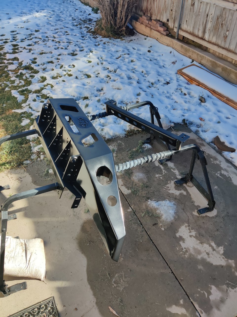

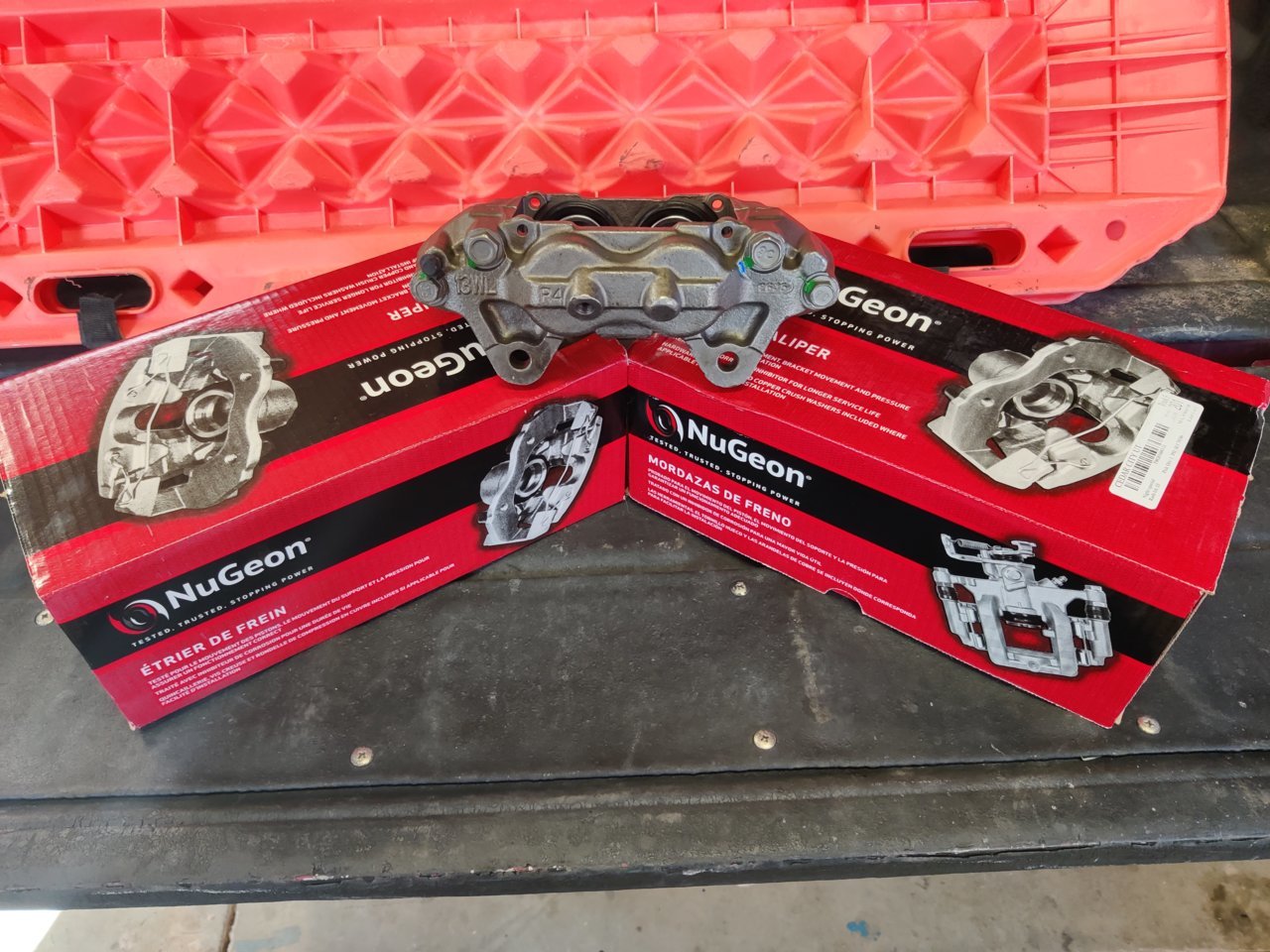

    also picked up the tundy calipers today
    Just waiting on McGeorge Toyota to send me the rotors, brake pads, and shims I ordered. Apparently they have all the brake parts I ordered in stock but don't have the fuel sending until or the gas tank strap on hand so I have no idea when that will ship

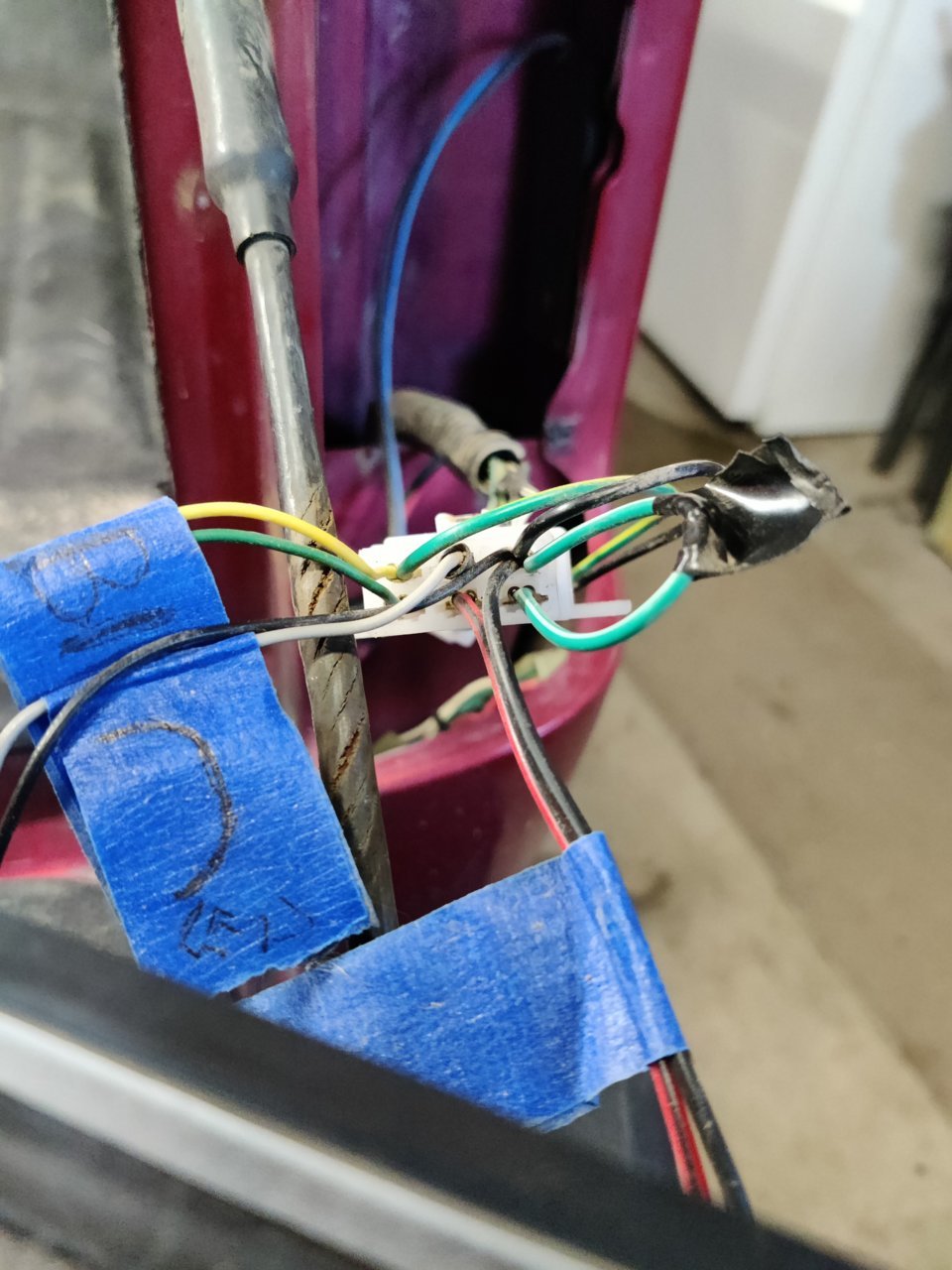

    This worked, thanks.
    still can’t get the passenger tail out to light up though. Works when I plug it into the drivers side. So that’s cool.

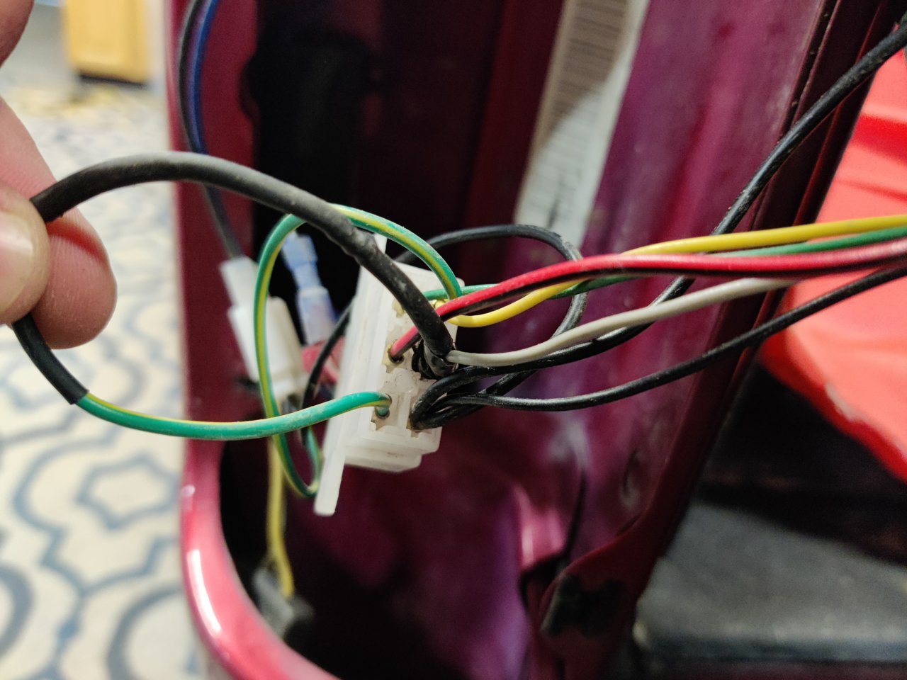

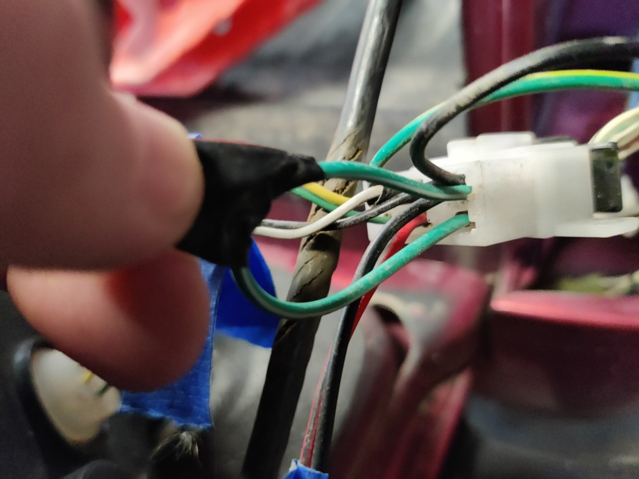

    If your passenger tail light is working correctly while plugged into the drivers side I'm betting you need to change the Jumper wire on the passenger side plug.
    The passenger side taillight should not function correctly plugged into the drivers side.

    I put a jumper on both lights

    Both lights need the Jumper but they don't go in the exact same way. I made that mistake too

    Let me go pop my tail light off and get a picture

    @JKO1998
    Passenger
    Passenger
    Drivers

    I updated the post with a pic of the drivers side Jumper wire too
