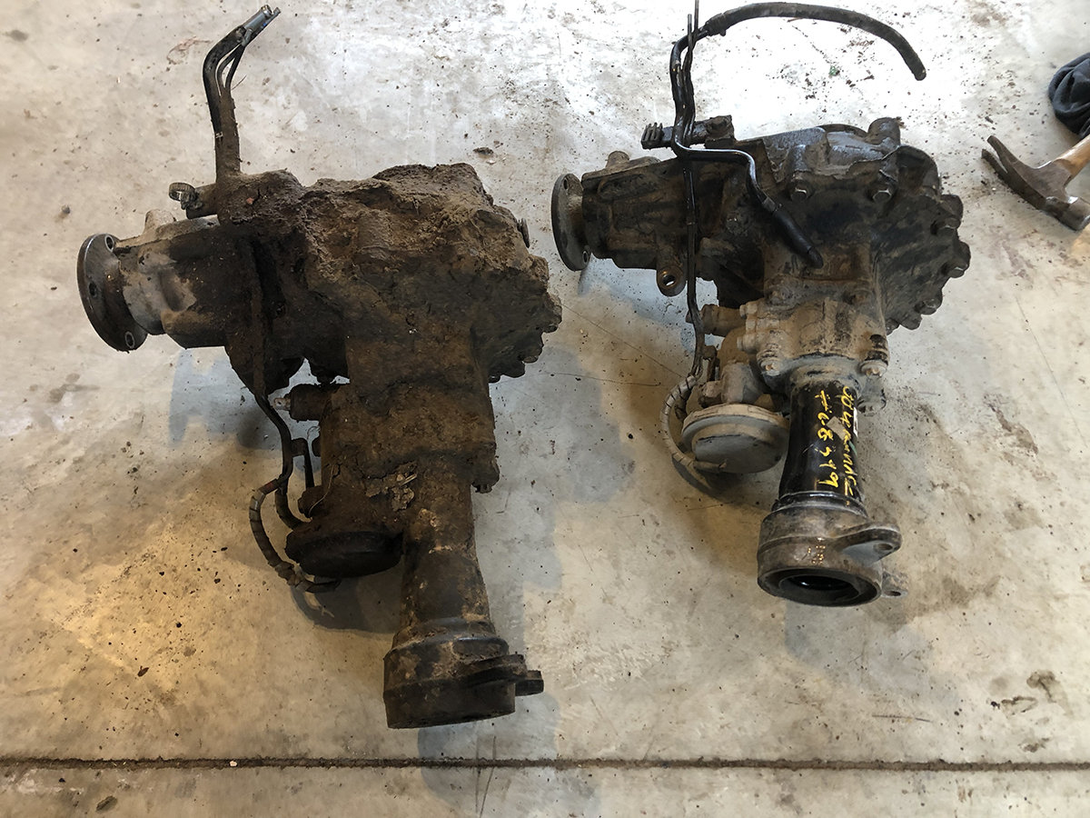

    Between the valve covers and oil filter changes I'm sure mine looks the same. Haha

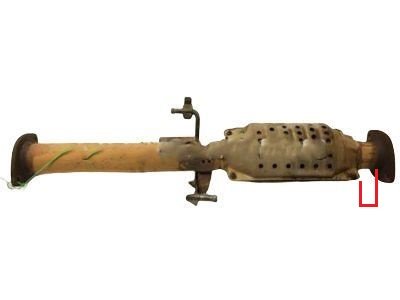

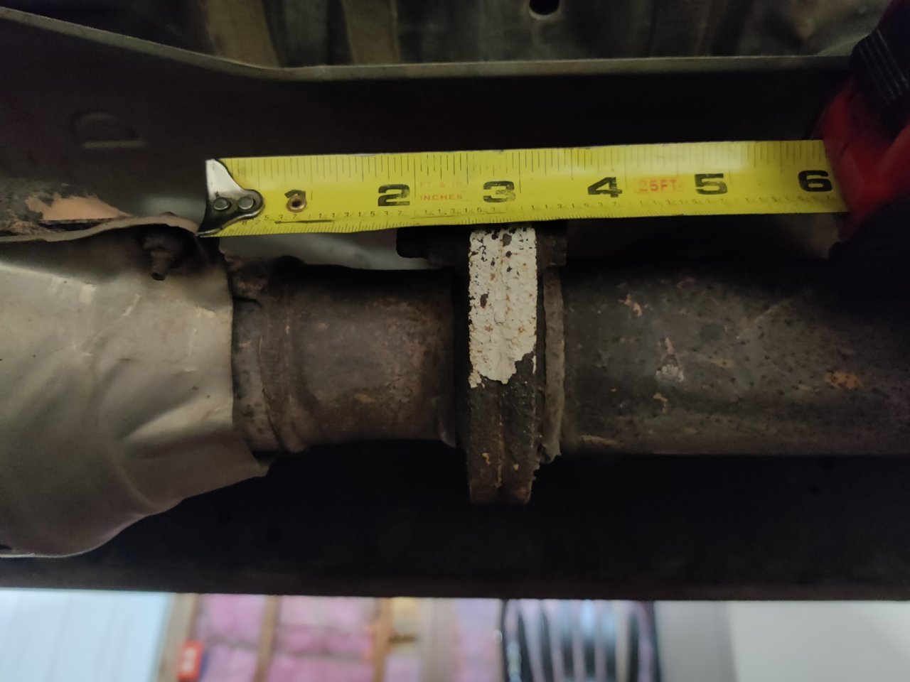

    I got the flange welded on the front cat, on to the second. Can any of you tell me the approximate distance between the end of the heat shield and the flange on the muffler side of the rear cat? I want to make sure the 02 sensor wire reaches once I get the cab on the frame. Pic for clarity.

    2½ inches

    Awesome, thanks!
