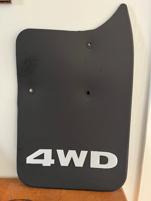

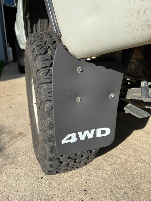

    Pulled the old way-faded rear flaps, scrubbed them clean, painted them black and applied new stickers. Decals are reflective for extra bling-ness.

    Where did you get them?

    The decals? Picked them up here on eBay.

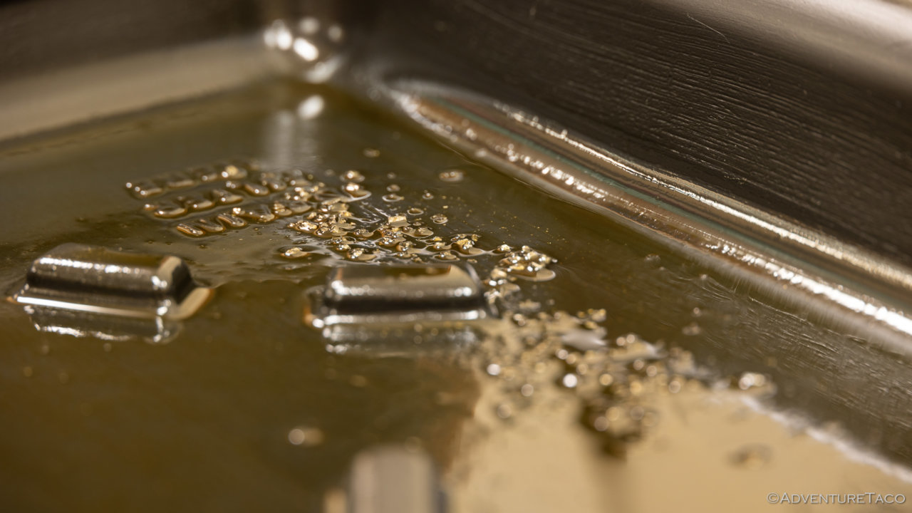

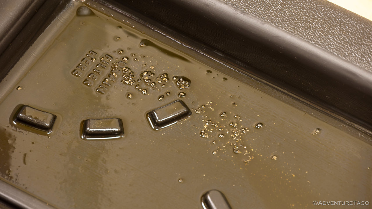

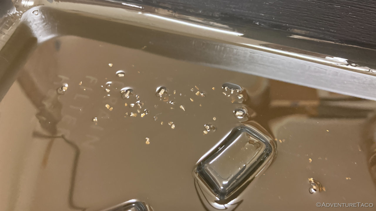

    Well, I guess we know something was wrong in the original transfer case (right oil). Looks like the new (83K mile) one (left oil) doesn't have any significant issues after a few miles at least. Time to put it to the test on a trip. :fingerscrossed:
    Fun, different colors (expected really).
    Look at the surprise starting to reveal itself.

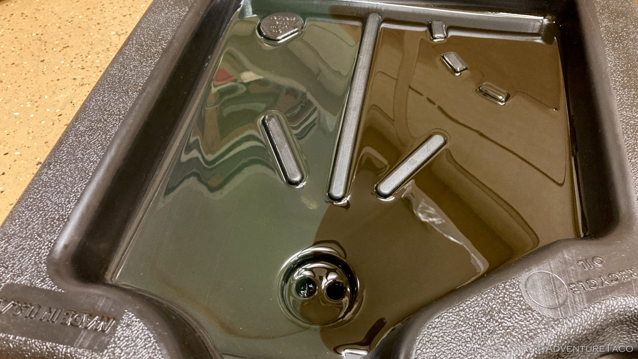

    After a bit of time to drain...
    I'd be rich if I were panning for gold.

    cracking it open already! I wanna see what died.

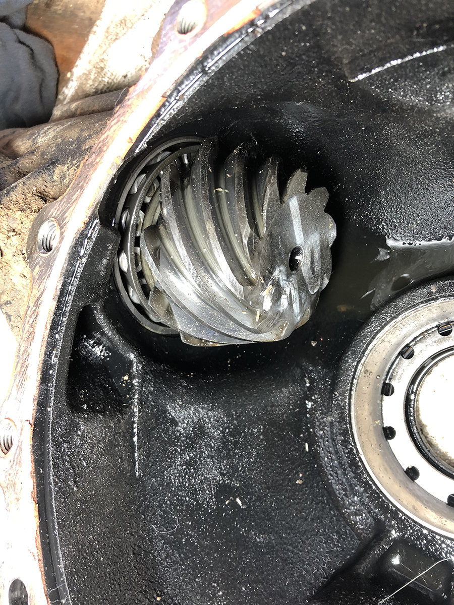

    I got the flange off, but the pinion doesn't want to come out. I put a block of wood on the other end and hammered on it. It moved some, but seems to be stuck. How hard should it be to drive out, or actually in, since it obviously comes out by going toward the center of the dif?

    It's been a super long time since I've taken one apart. Im actually remembering that it's pressed in as the two bearings are opposite eachother in direction. So you can keep smacking it and it'll come out eventually.

    Nope, not moving. I even put the flange nut on it backwards and hammered directly on that, so there wouldn't be a wood block absorbing some of the impact. The level of difficulty is now higher than my level of curiosity so I am done.

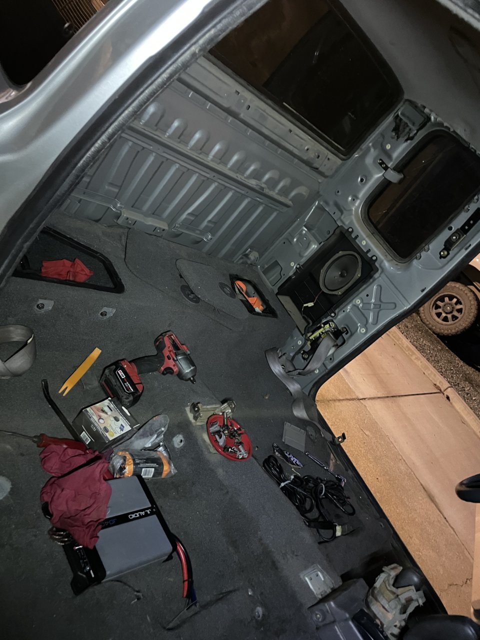

    Started pulling my interior to sound dampen and expose the trans tunnel for my dual case install this weekend. Didn’t get far before it got dark. 2A709084-7D7D-4C2F-9D51-EDD7AA948FE2.jpg
