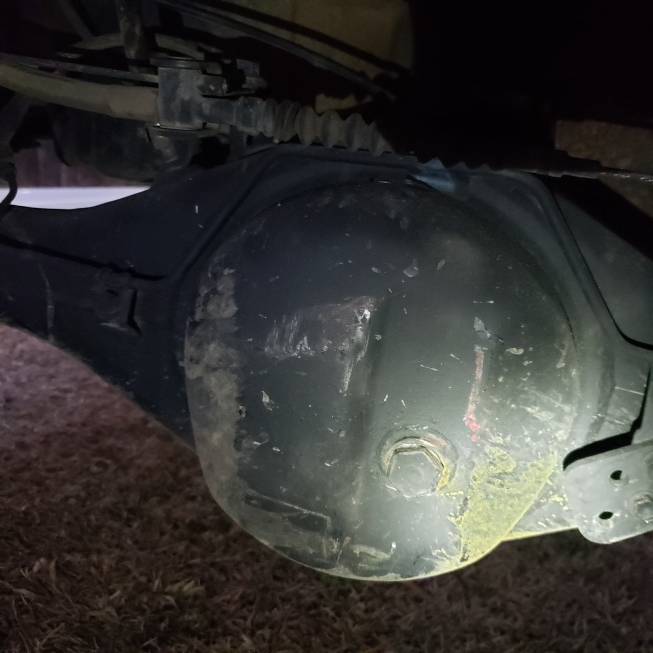

    I didn't do anything to it today, but a fellow motorist decided he wanted to play peek a boo with my rear diff.

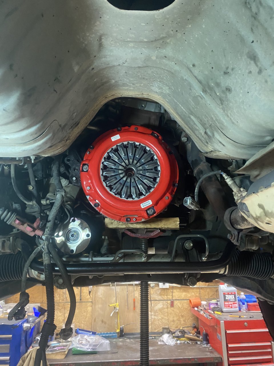

    Put an LCE heavy flywheel and upgraded clutch in

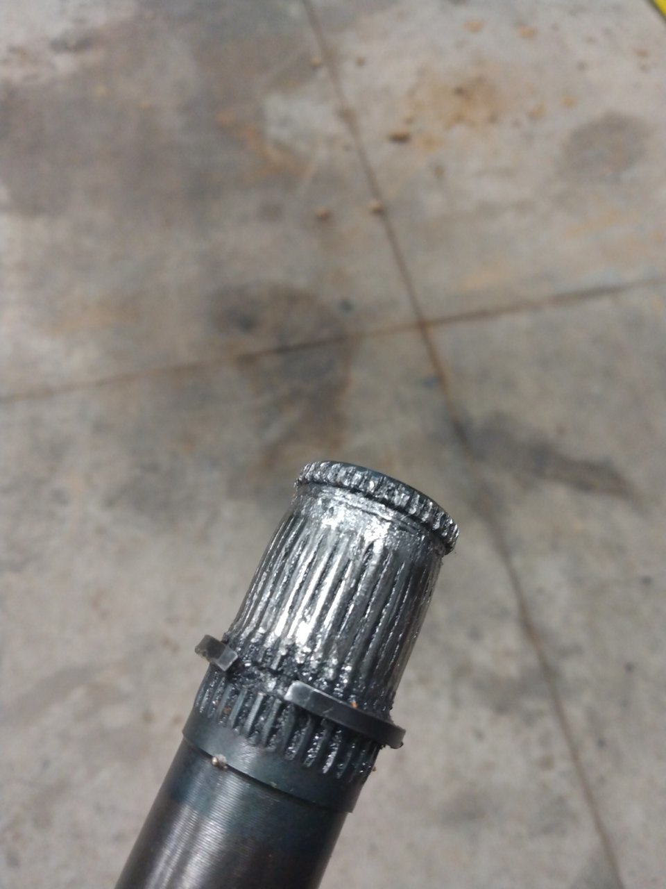

  12. Jan 19, 2022 at 7:37 PM
    OpeCity
    OpeCity Well-Known Member
    Feb 28, 2021
    #357705
    3,342
    Long Beach, CA
    99, 24
    Fuuuck
    unstpible and 5amStevens[QUOTED] like this.
