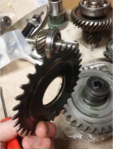

    Are you using the OEM rf1a gears? or 4.7?
    I haven't seen that little plate gear thing before in any builds or any mention of it anywhere else.
    Got any information on that and why you installed it?

    Looks like 2.28 MC 23 Total spline input. But a TG 2.28 Countershaft gear? That thin gear is a Silencer that came from the factory and comes with TG 2.28 gear sets. MC gears do not have this as the countershaft gear teeth are wider and have a more flowing cut (forget the actual name) to minimize gear whine vs factory sets. Believe the TG 4.7s are also wider removing the need for this.

    Gotcha. Thanks for clarifying.
    Makes sense why I'd never seen that part in that case.

    Its an odd piece I learned about from LowRange a few years ago, cant make that much of a difference because these cases still whine when put in gear. :turtleride::anonymous:

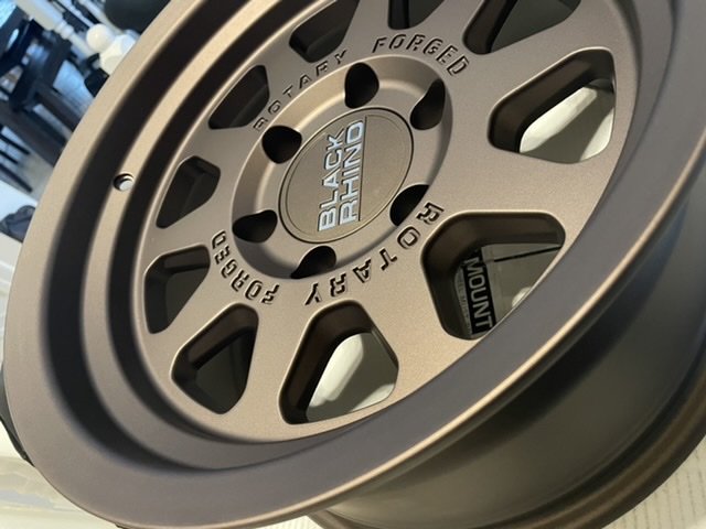

    Good luck! Try to flex the suspension as much as possible and you should be good. Don't catch too much on fire!
    unstpible and Rhodes[QUOTED] like this.
  10. Jan 21, 2022 at 1:05 PM
    Rhodes
    Rhodes Well-Known Member
    Jan 16, 2021
    #353000
    380
    Edmonton
    01 Dbl Cab
    Call me crazy, but I don’t dig the vinyl.
    Thanks! I’ve spent a year reading everyone’s build threads on goin 35/37’s. I’ve got a pretty good list of saved pages haha. I’m going to enlist a buddy who just tubbed his 5th gen 4Runner for 40’s haha.
    either way. 2 fire extinguishers are ready to go..

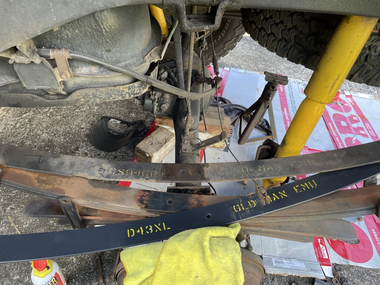

    I have a 2.28 MC comp input and new bearings on that and the stock counter shaft. I just repressed that oil slinger or silencer thing back on with the new bearing... But when I put it together it didnt mesh well and I saw nobody else using it so I unpressed and took it off.
