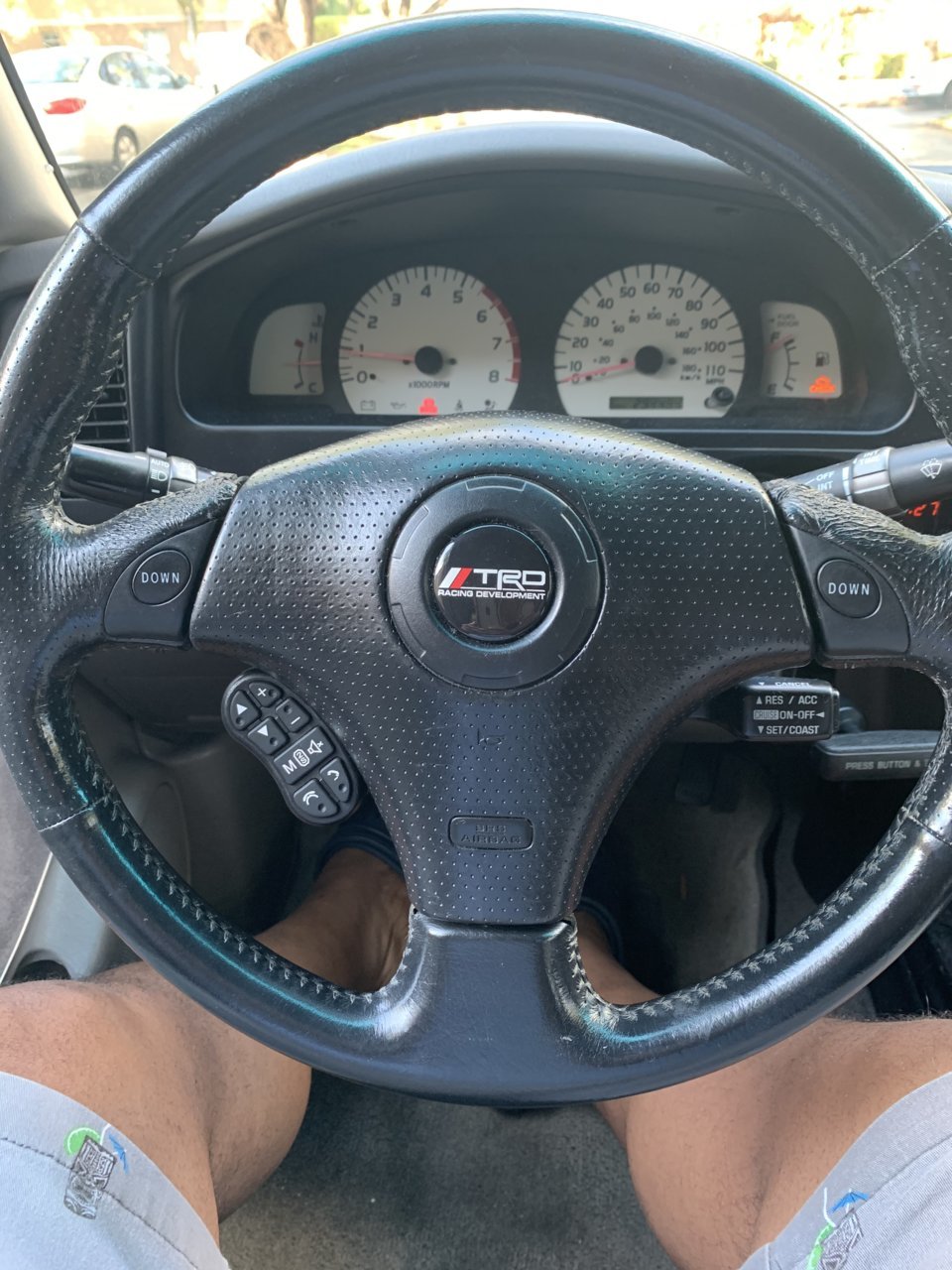

    You can see them peaking out here I will take a better picture tomorrow

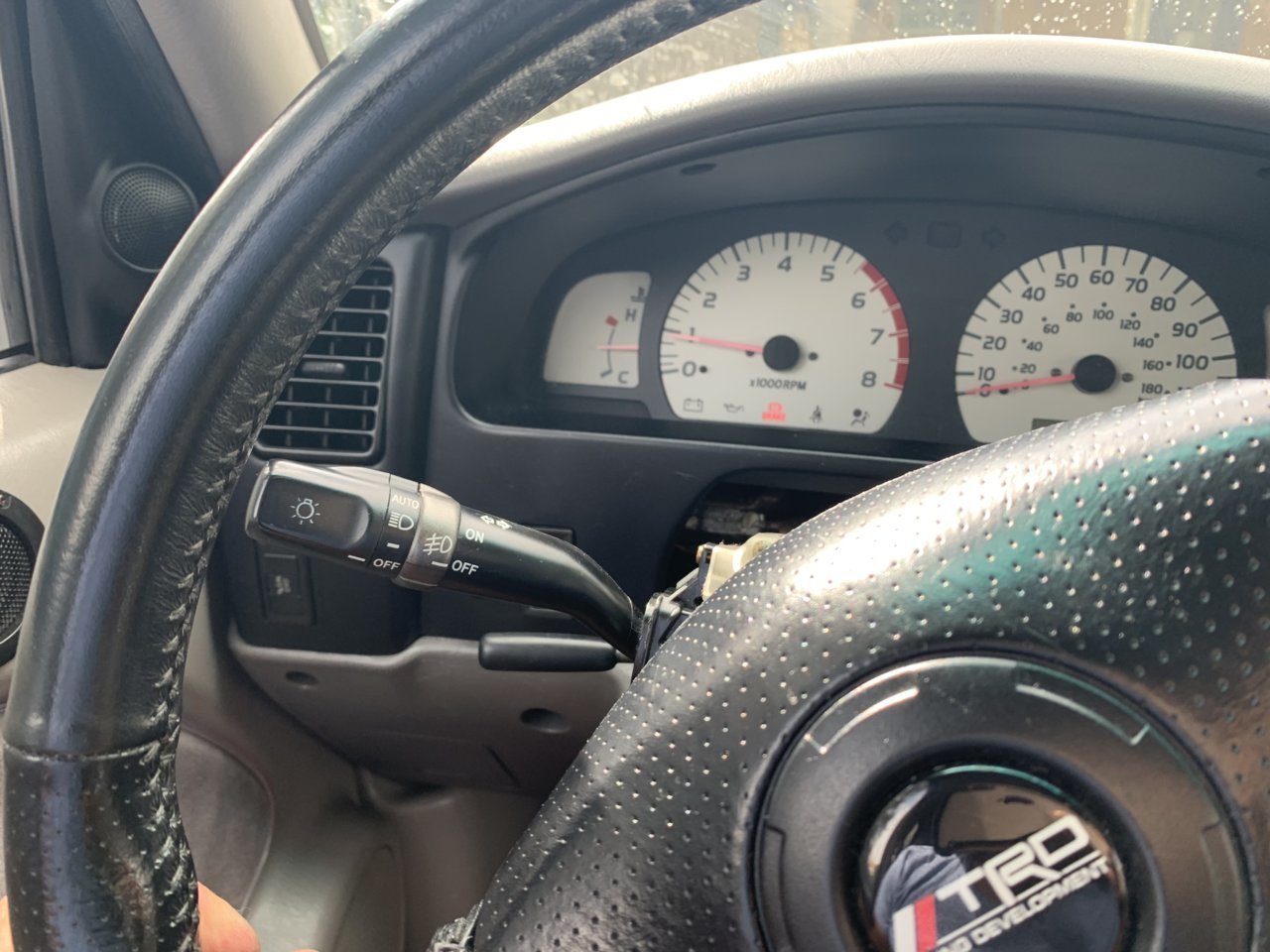

    I think they're interchangeable for all 1st gens. If I remember correctly, my intermittent wiper stalk came from a 2001-2004 Tacoma and it fit fine into my 1998.
    I spy what looks like a fog light switch in your pic. I wonder what sort of wiring it would take to make that operational. There's a thread around here where someone was looking at doing that with a Camry (I think?) lever but they abandoned the project before they got into wiring.

    Yes that’s one of the reasons why I changed them I wanted the fog light switch. I simply found the two fog light switch wires in the stalk and ran separate wires and use the switch as a simple interrupt with a relay

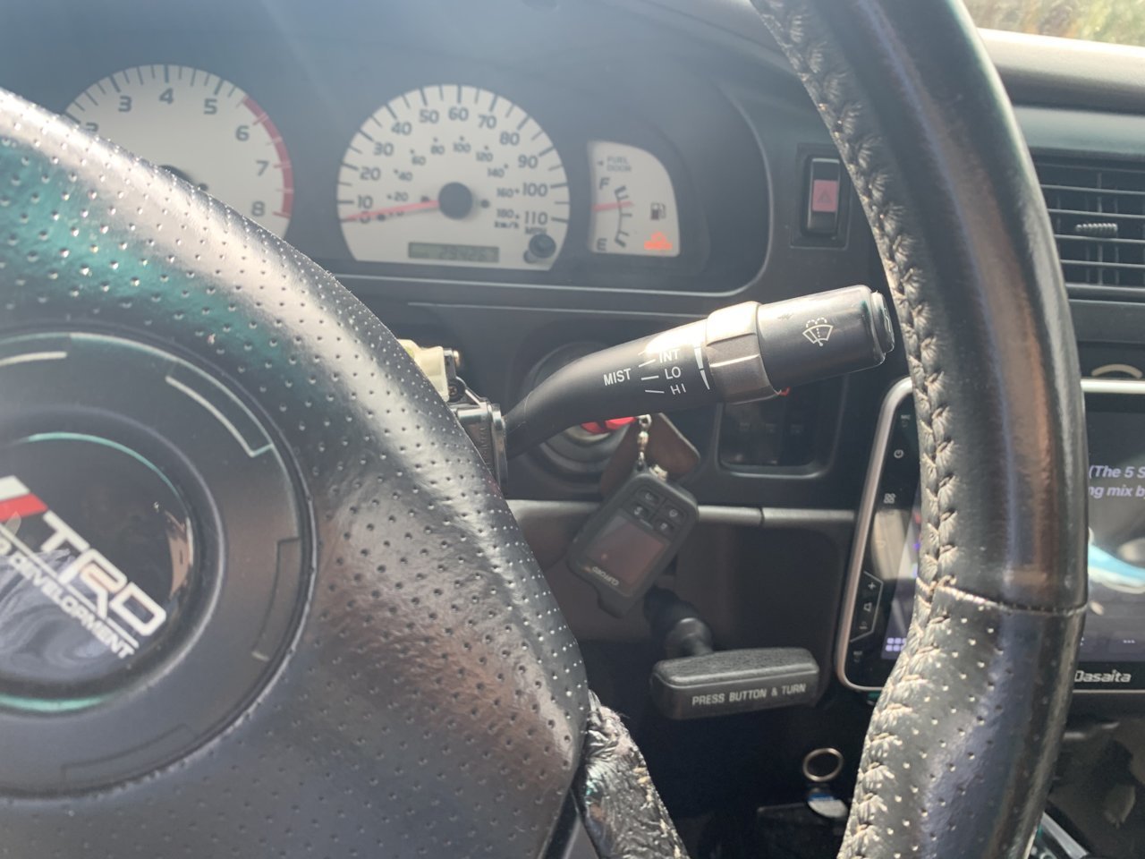

    better pictures of the stalks

    What does the button on the end of the wiper stalk do?
  11. Jan 27, 2022 at 7:10 AM
    Speedytech7
    Feb 20, 2014
    #123587
    58,549
    FCQM+VG Cheney, Washington
    It's less Tacoma and more mod
    Winshield washer

    #49376
    17,138
    Green truck
    Go easy on him, it's labeled.
