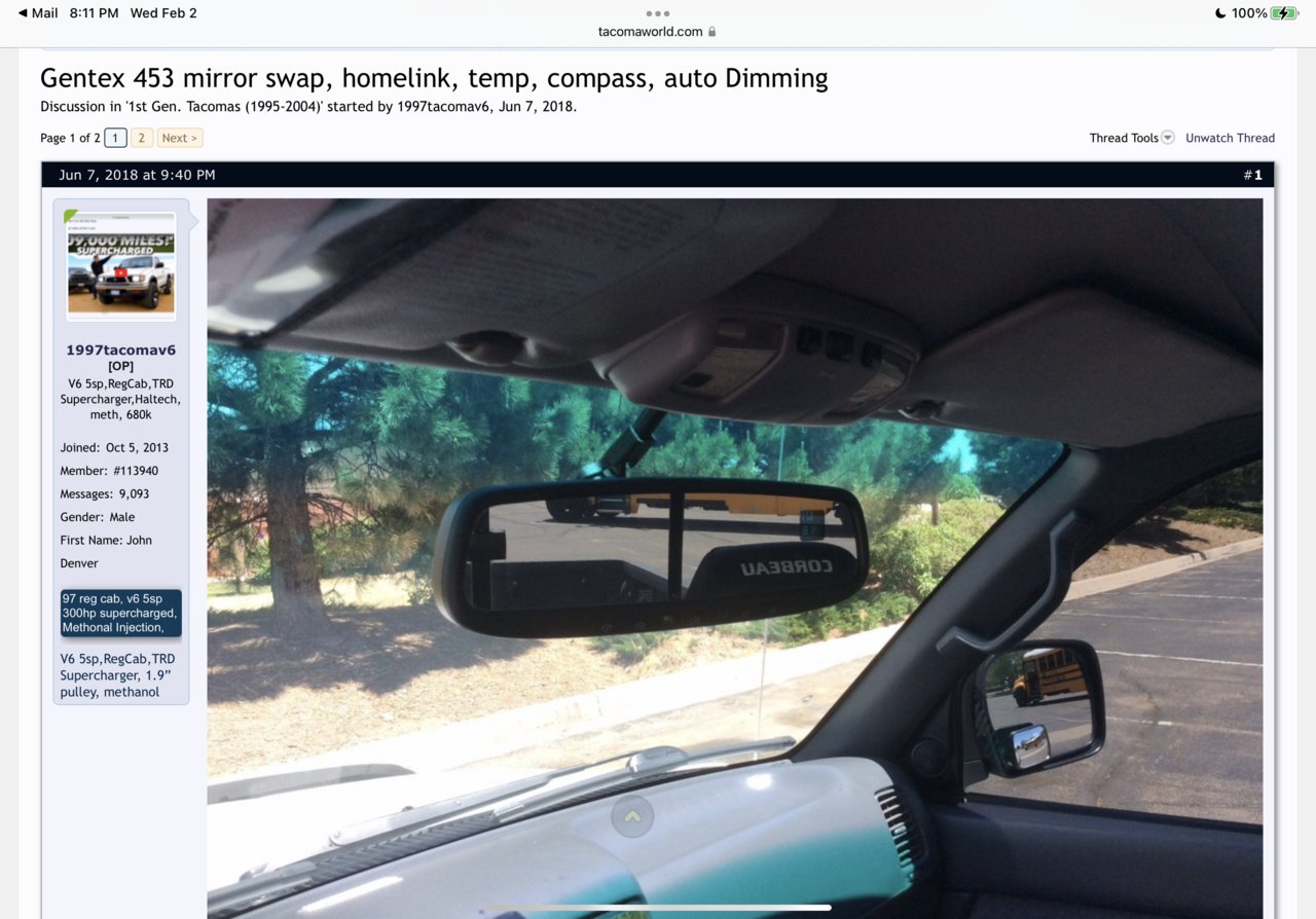

    This is a good one too if you want a newer style mirror and I got my leds from O'reilly's
    https://www.tacomaworld.com/threads...mp-compass-auto-dimming.553041/#post-17999152

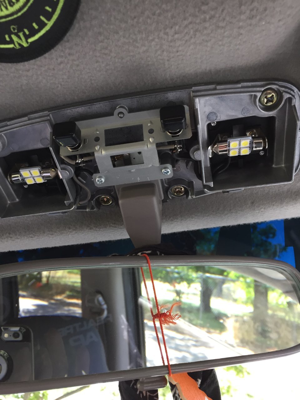

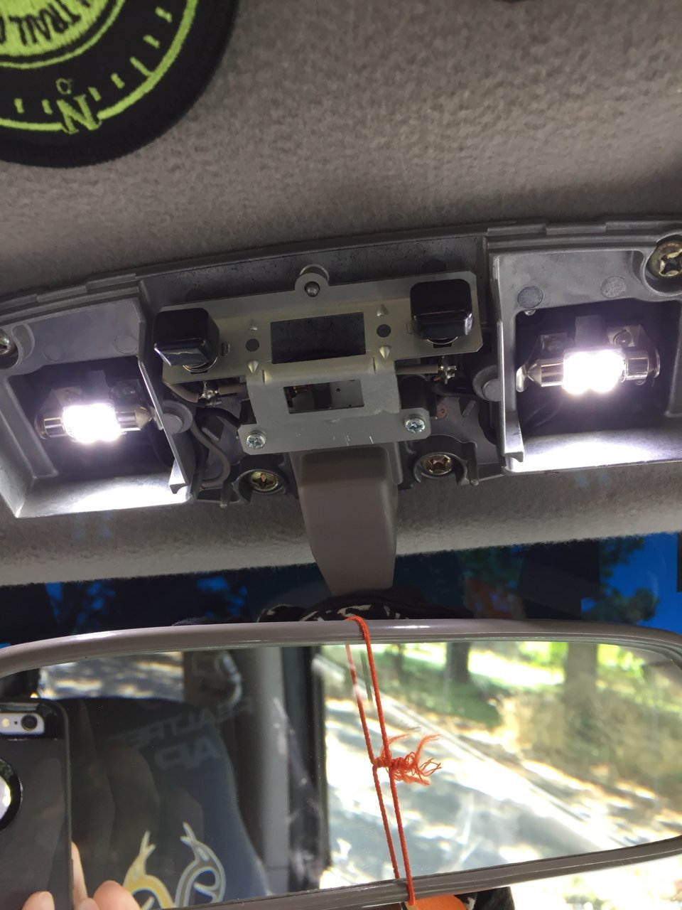

    Which LEDs are you all running because I've tried multiple and they won't turn on unless I have two of the lights one. If I just have one of the Map lights on, it won't "turn on". If I turn them both on, then they work. Thoughts?

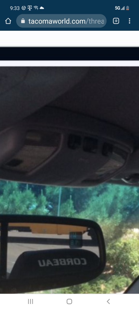

    Yeah this upgrade may be in my near future. On my 1996 Taco, there is no outside thermometer, which is kind of a drag on my backcountry adventures. Do the GenTex units come with an outside temperature sensor? I've wondered how this might work.

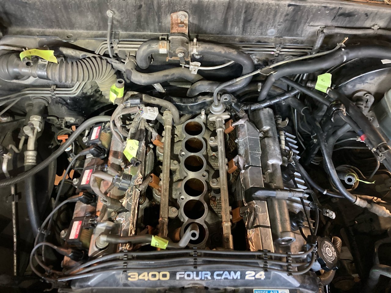

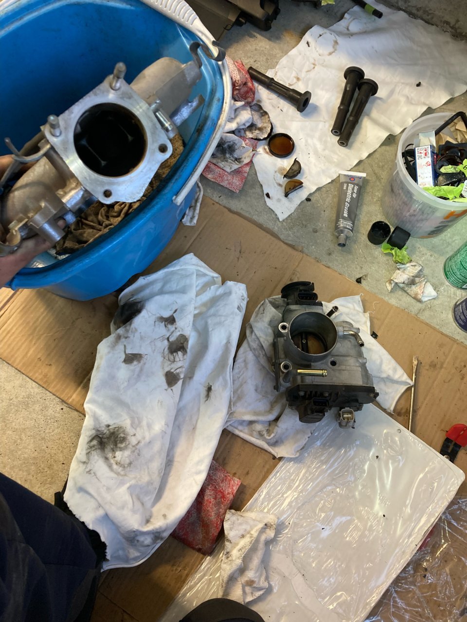

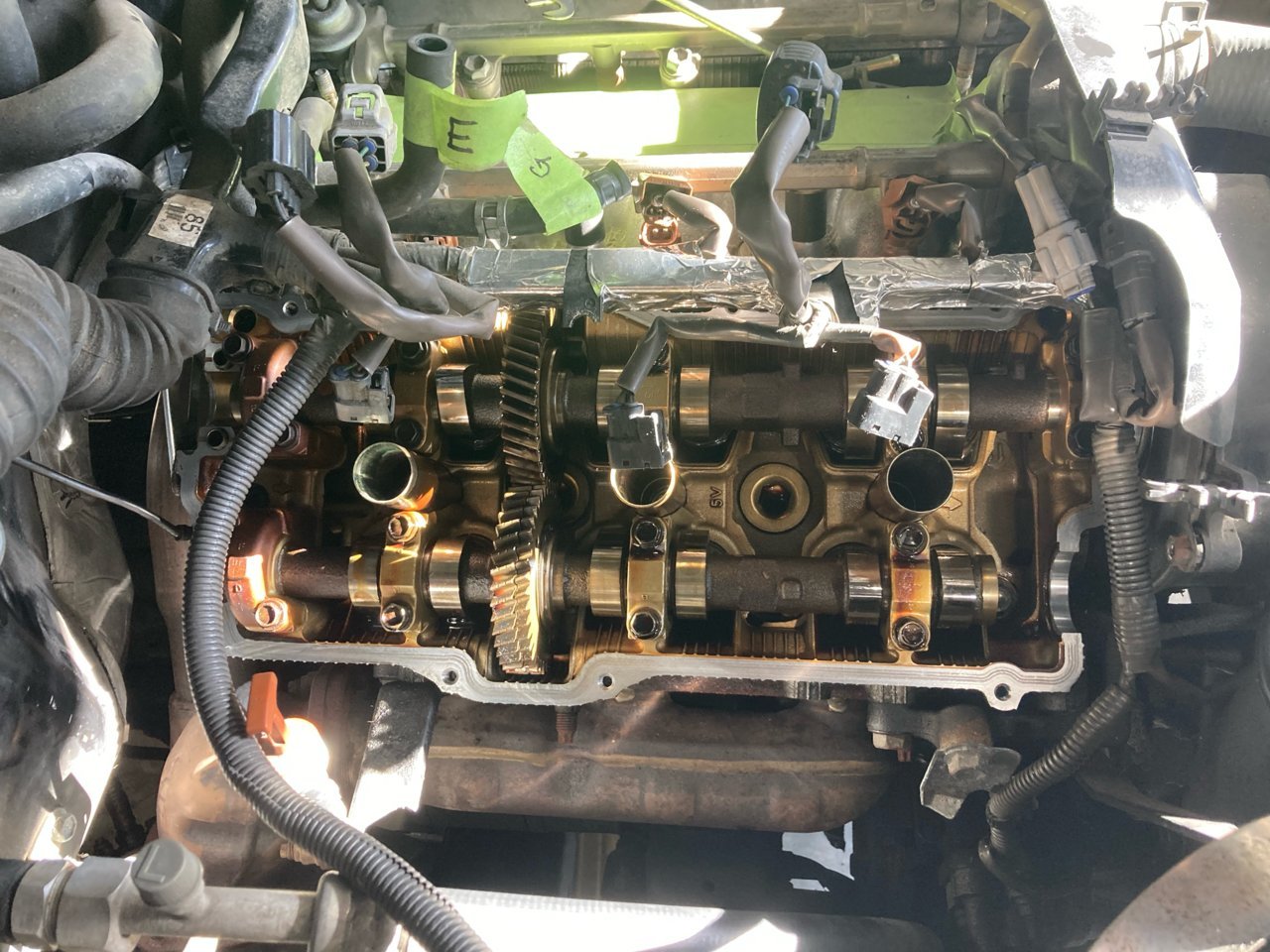

    Finally got around to valve cover gaskets, cam plugs and half moons. Covers had been leaking for awhile. Had all the parts for ages and finally jumped in thanks to this youtube vid: https://www.youtube.com/watch?v=N5fAXAuGozI&t=1769s
    Also changed the plenum gaskets, plugs, wires, coil boots, cleaned the throttle bottle and MAF sensor. Was a fun project I'd been scared to do it, but ended up being relatively stress free!

    Some of the map lights had different pin layouts so you might just need to verify that the wires are going to a pin. I remember having to re-pin for mine to work.

    My experience exactly when I did this over the holidays. I was intimidated as I began, but very much took my time and completed the entire job successfully. Very satisfying! Especially now that the annoying burnt oil smell is gone :) BTW, I like how you labeled the hoses, wish I thought of that.

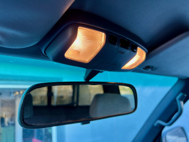

    Thanks. The 4Runner map light I bought had two electrical leads (connections). I connected the hot wire from the dome to one lead, but ignored the other because I didn't know what should be connected to it. Maybe a ground wire, but that wouldn't be necessary, as the unit is grounded as it's bolted to the truck. Now both the left and right light switches work fine on the map light, but the door switch does nothing. Hmmmm...

    You need the signal from the door pin, you can just splice the dome light wire and run it to the map light

    Thanks. So to be clear, I spliced one of the two wires from the dome light and connected it to the map light. So you're saying I should do the same with the other wire, correct?

    Exactly, very satisfying! That feeling when the engine started right up was next level haha
    I labeled out of paranoia, but putting it back together it's amazing how intuitive all the hoses and connections are, so I probably didn't need to label anything. Kudos to you and goodbye burnt oil smell!

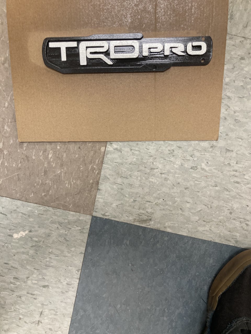

    Just made this to mount on my tool box. I just 3D printed it and painted it. My old one delta badge was all bent up and faded.image.jpg

    There is guy on eBay that sells these as kits with everything you need including the sensors,
    I use the garage door opener every day on it
